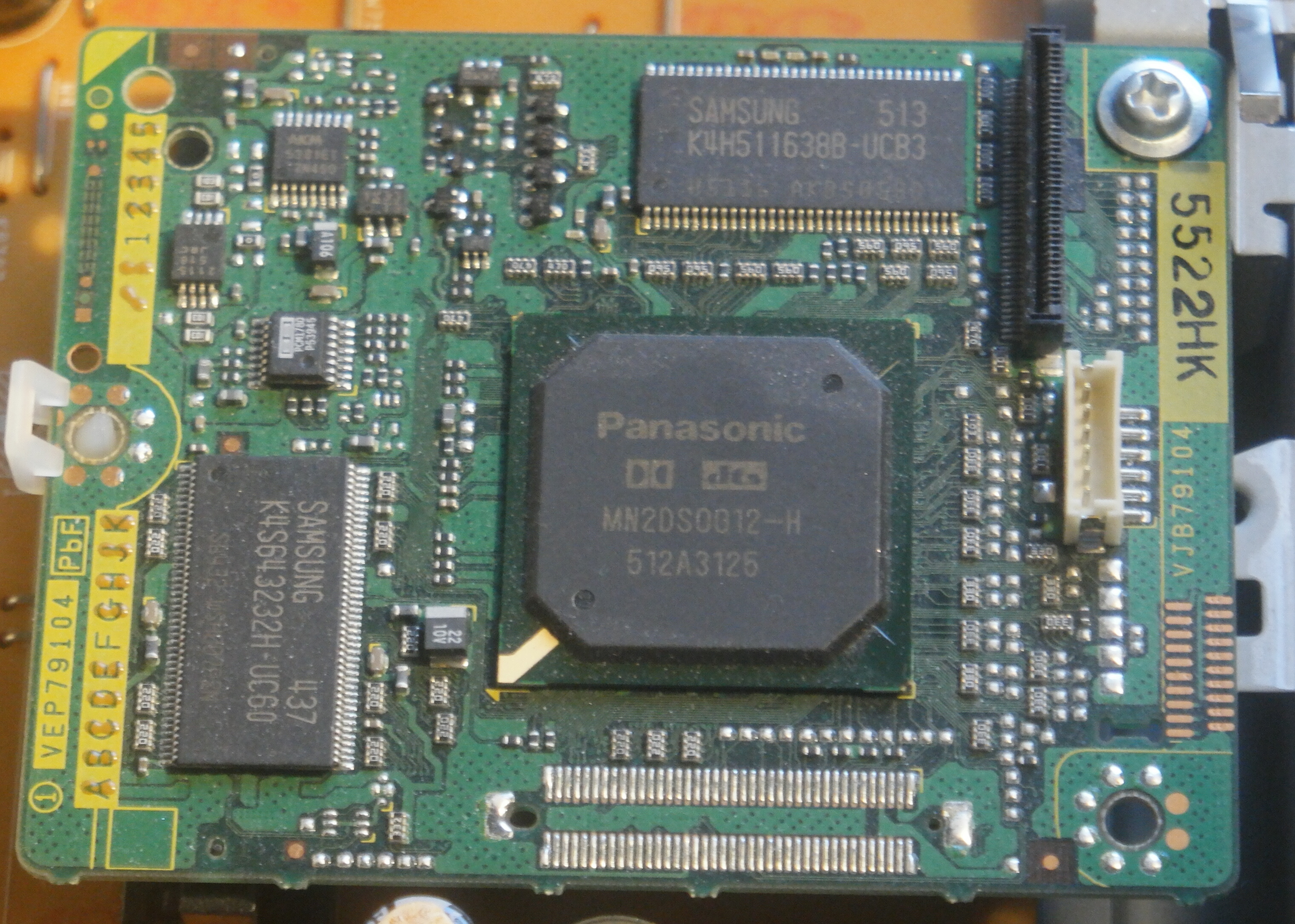

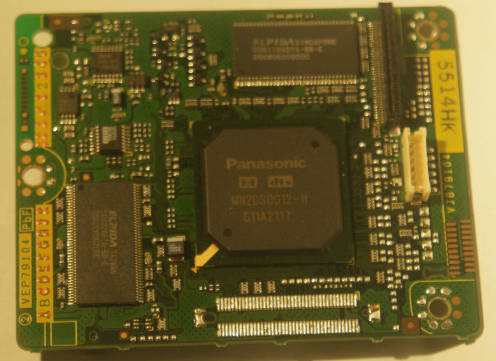

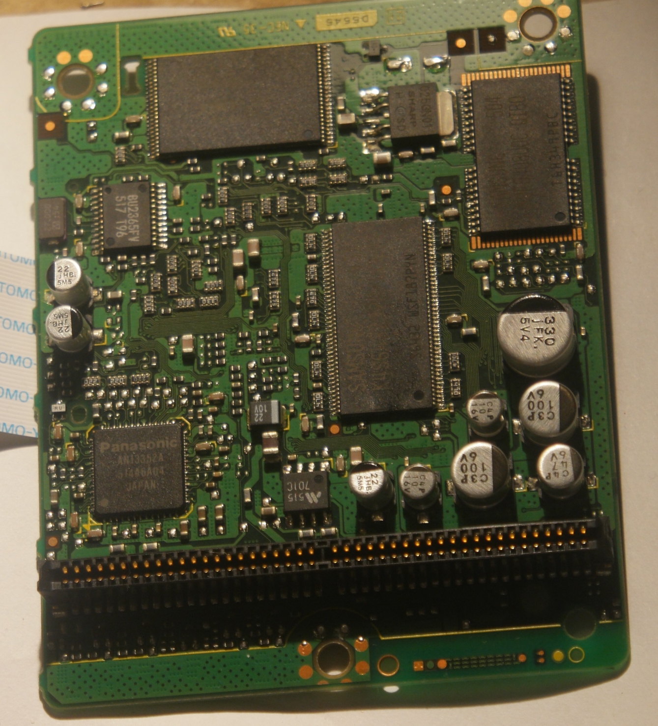

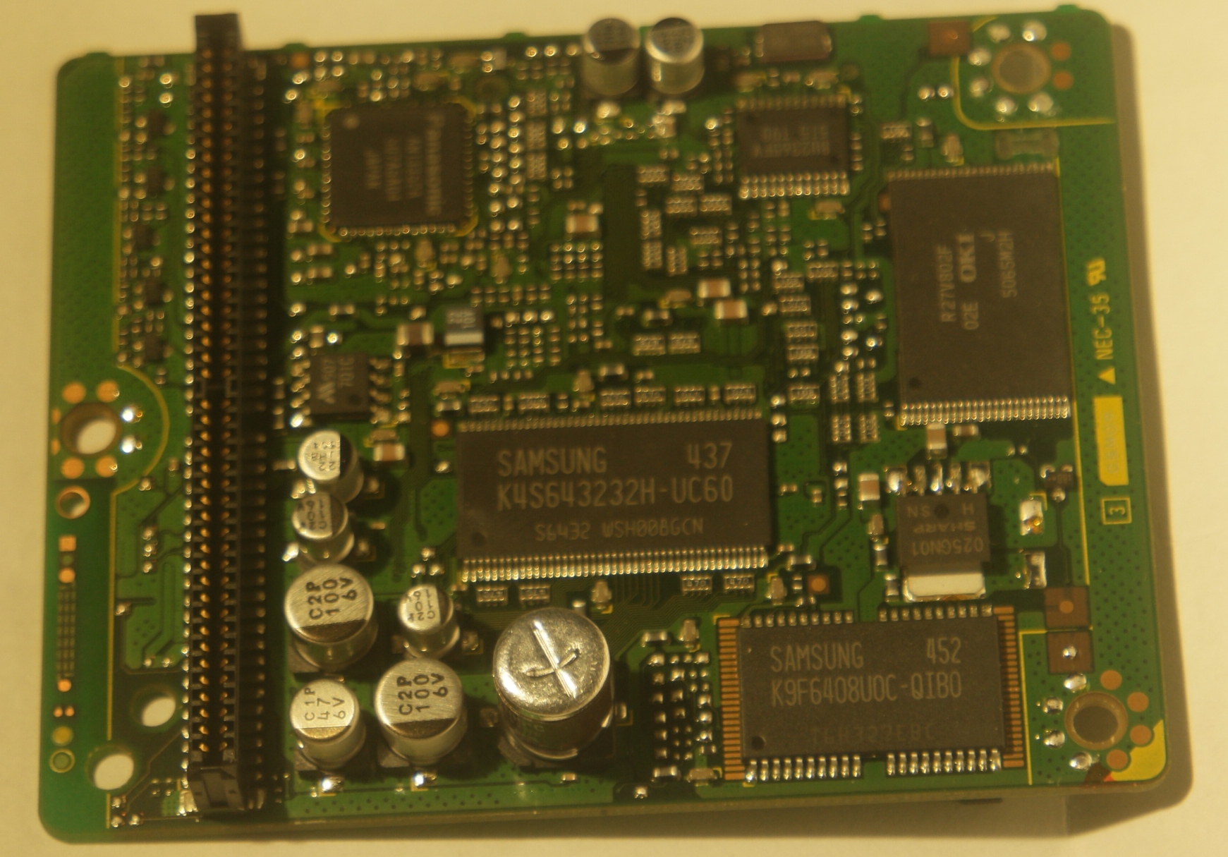

    I've never seen the schematic for the digital PCB shown in any of the SMs for the models from the DMR-ES10 and on, it just shows the AV input/output switching chip (which may well be different in the PL variant ofc.) This does make it a bit harder to infer what models have what chipsets.
    As digital PCBs, my ES10 and ES30V (both EC-S) seem to have nearly the exact same digital board with only the last letter being different - VEP79104B for the ES10 and VEP79104F for the ES30V. The SM for the ES10P (US variant) lists the digital board as VEP79104A, and the VEP79104E here for the US ES30 seems to have the same ICs so looks like they used the same chips for the north american and european variants for these. The most relevant chips seem to be the MN2DS0012-H and AN13352A, think the others are RAM/ROM/voltage reg stuff.
    [Attachment 67686 - Click to enlarge]
    [Attachment 67687 - Click to enlarge]
    [Attachment 67688 - Click to enlarge]
    [Attachment 67689 - Click to enlarge]
    The SMs seem to list some of the Digital PCB names like RFKBES30VEC which may just be an alias or smth as my EC model as shown has the same VEP79104F as listed for the ES30VEG in this manual.
    The EH50 seems to have slightly different digital PCB from what I've seen in pictures/manualsVEP79106A for the P variant , probably due to the HDD connectors etc being on it. I can't find any images showing the ICs though at least this parts site indicates it uses the same main IC (though idk how reliable it is.
    The later models seem to often have a heatsink on the main IC which makes it harder to make out as seen e.g here. Some googling seems to indicate the ES15 and ES35Vs may also have related digital PCBs between different variants.
    On the later "EZ" US variants it looks like you can often see the main IC with a LSI or Magnum Logo illustrating the different chipset used on those, while e.g this board from a european EZ27/28 has a panasonic main IC. Twitter person foone documented the main board on a US EZ485V which also shows a Magnum DoMiNo main IC and a TVP5150AM video decoder (same IC as in some capture dongles like the ATI 600 USB).

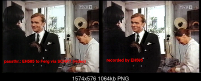

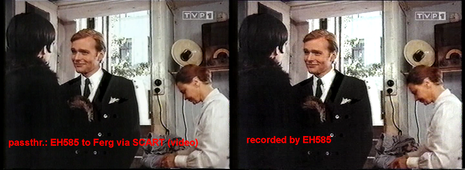

    Anyway, I did this test:
    * left side of the screen
    Clip from a Toshiba VCR (range 16-255), passed through a DMR-EH585 (SCART->SCART video), recorded by a cheap Ferguson recorder (MPEG2)
    * right side of the screen
    As above, but already recorded by DMR-EH585.
    The image saved by Panasonic is brighter, has more details, but also more noise. You can see, for example, in the 48s, the fatal rendering of the white wall. I don't see such flicker on the TV, the image on the TV is good and stable.
    Is the recording in MPEG2 on Panasonic really so bad?
    (I will still record on Ferguson with SCART OUT set to RGB on EH585 -- the picture seems better).
    (mp4 file attached, MPEG2 source, yadif, H264+CRF17)
    * left side
    As before, only SCART OUT set to RGB (on S-Video I get a black&white picture).
    What I noticed -- frame 32. You can see the image jump on DMR, not on Ferguson.

  24. I don't think the purpose of this thread is to compare crappy mpeg2 encodes, poor deinterlacers, oversharpend pictures with halos etc.
  25. Member
    Aug 2018
    Wrocław
    Yes, but:
    a) deinterlacers are not very important for VHS material. I compared several and the effect is imperceptible with a noisy VHS;
    b) too strong colors are the effect of Toshiba's VCR and its output scale YUV 16-255;
    c) some reference VHS material would be useful for the evaluation, but I already see that the SCART/RGB output gives a better image than SCART/VIDEO. What am I surprised about but I don't know if I should?
    It's time to test the HDMI output, but I don't have a good grabber
