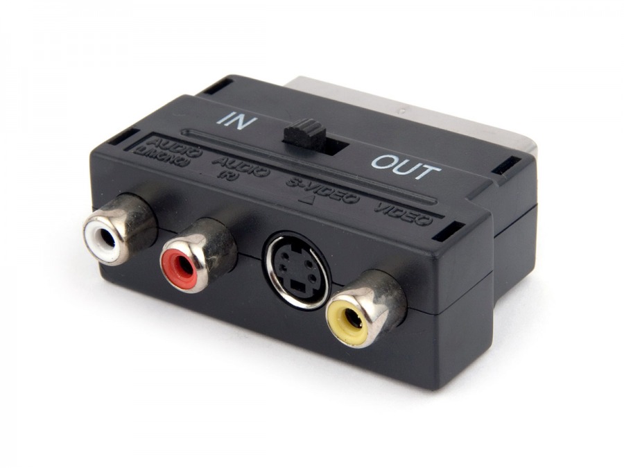

    Originally Posted by Master Tape
    the adapter i'm currently using is introducing heavy herringbone noise
    Out of interest, is this the type of adapter you're talking about?
    [Attachment 75249 - Click to enlarge]
    Yes exactly like that, only in silver.
    May 2005
    Australia-PAL Land
    Thanks MT. I use one of those (in black) but haven't come cross any herringbone issues (yet?).

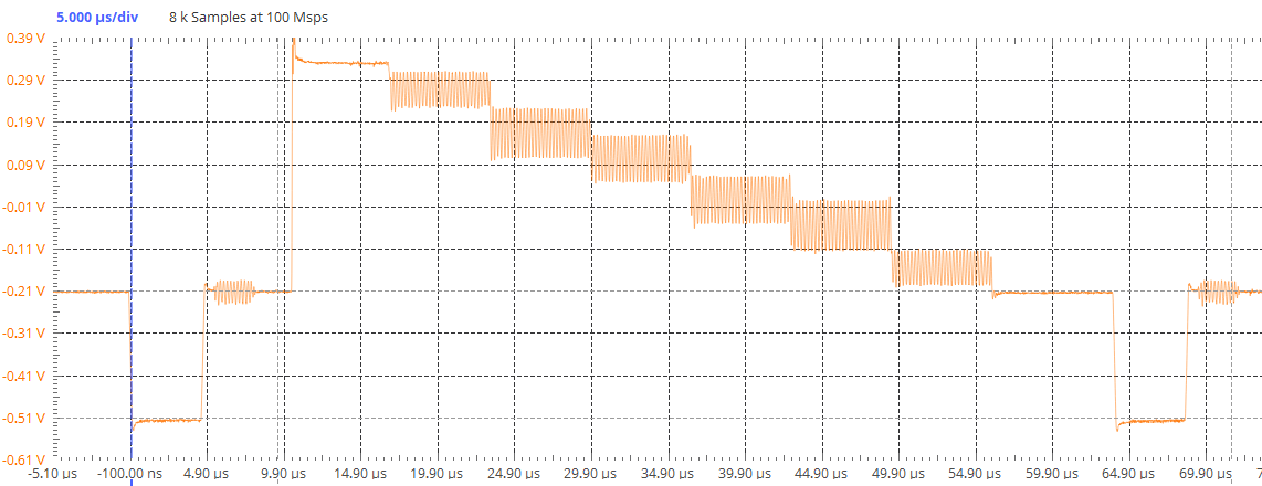

  17. Here an example of what happens with a poor cabling.
    The Oscillogram represents one scanline of the luma signal (on the Y wire) of a colorbar. One can see the spillover of the chroma signal (from the C wire) onto the luma. The luma signal looks almost like a composite signal. The undisturbed luma would be a clean staircase without the superimposed waveform from the chroma subcarrier.
    The attached video is the capture. You can see a pattern of moving dots caused by the contamination.

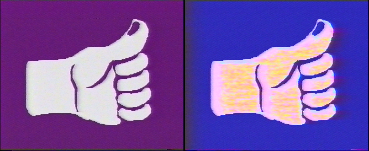

    Probably not heavy, but quite a bit more than you'd get with normal capturing, but yes definitely noticed more in highly saturated colours. The bigger issue i have going through my ES10 is whenever something saturated in purple or violet appears on-screen it causes some sort of colour drop out like this.
    [Attachment 75275 - Click to enlarge]
    Just hope that it's an issue with the adapter and switching to a cable will eliminate it.
  19. Out of gamut and clipped colors.
    Just turning the saturation way down (and reduce contrast somewhat) makes it look already much better......
    Also, check for loose cables / bad plug contacts.

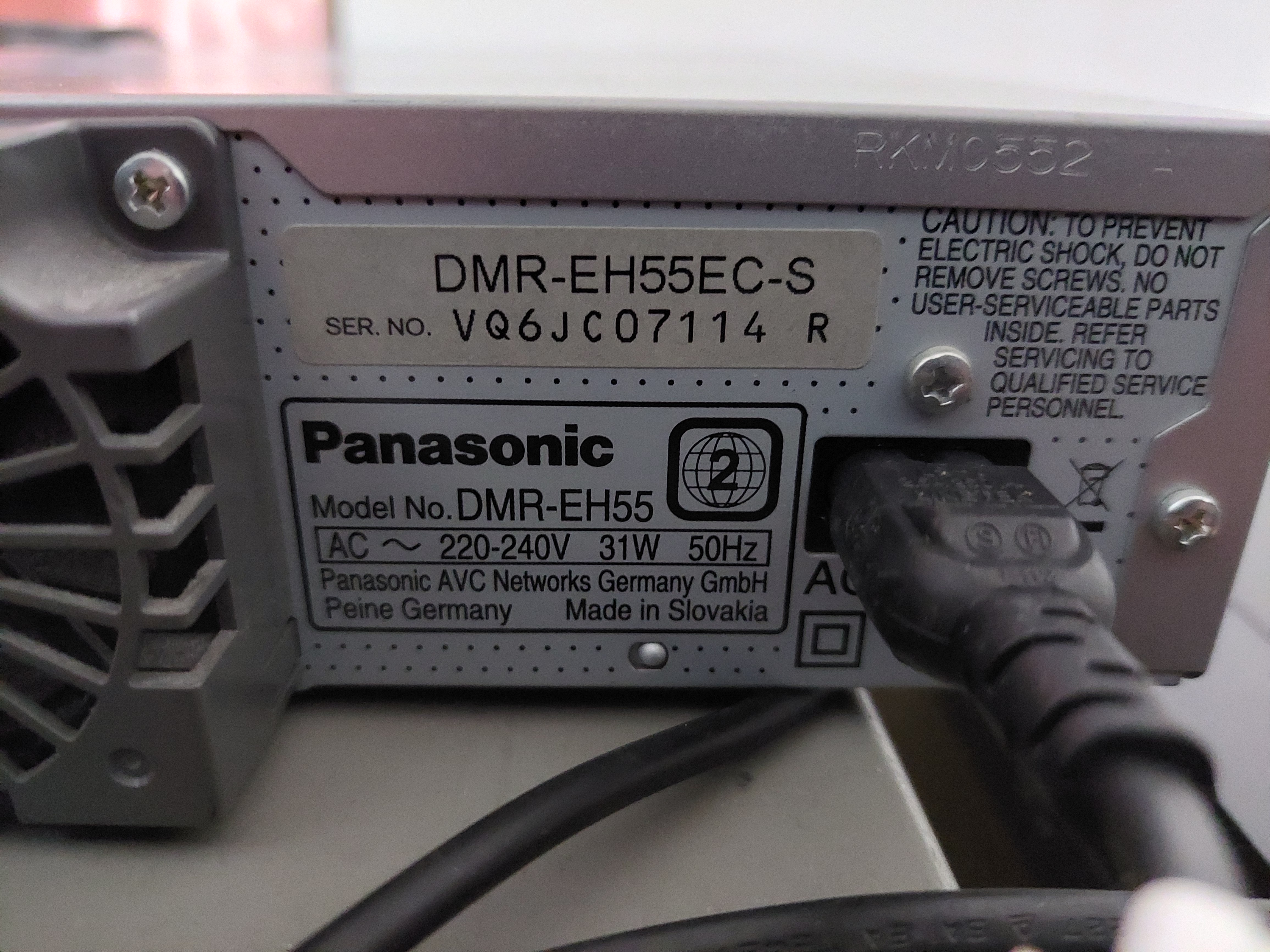

  23. Member
    Jan 2024
    BiH
    Does Panasonic DMR-EH55EC-S have TBC function?
    Will it work as passthrough device?
    Thanks!
    [Attachment 75996 - Click to enlarge]
  24. Member Skiller's Avatar
    Oct 2013
    Germany
    Yes to both.

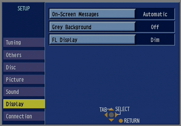

    Just wondering if anyone could shed some light on this.
    I've used a Panasonic DMR EX79 to capture VHS and Betamax with a Black Magic Shuttle & Win10 Laptop & had fantastic results!
    The only problem I'm having now, is that for some reason it has stopped caputuring video (goes black) if the image is slightly unstable. Audio remains ok.
    I'm not sure what could have changed to make this happen as I was previously able to capture absolutely everything from tons of distortion on a tape, to the blue screen when a VHS isn't playing.
    Could it be possible to change my settings on the DVD Rec to make it work as it did again?
  26. Originally Posted by Neil-Betamax View Post
    Check DVD recorder settings
    For PAL models:
    Display -> Gray background -> off
    For NTSC models:
    Display -> Blue background -> off

    I didn't see a setting in display to adjust a gray or blue background.
    I noticed under picture there's an option:
    Input NR
    It was 'on', so I've just turned off NR (I assume that's noise reduction).

  30. Originally Posted by Neil-Betamax View Post
    Input NR
    Yes, NR is noise reduction.
    So the Display setting option has been dropped for your model it seems
