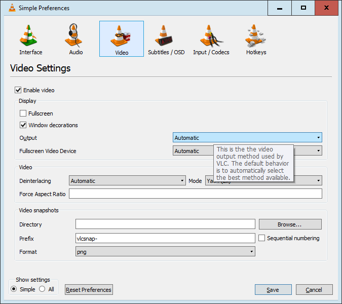

VLC.. Check which output device you are using:
Tools -> Preferences -> Video -> Output
[Attachment 61620 - Click to enlarge]
If Automatic doesn't work try one of the others, starting at the top and working your way down. Stop playback, change the setting, the start playback and see if there's any improvement.
Also on that dialog check that Deinterlacing is set to Automatic and check the Deinterlace Mode. I use Yadif (2x) because it has the smoothest playback. But it is one of the most CPU intensive (with your Xeon processor that shouldn't be a problem).
At the bottom of that dialog select the Show Settings -> All option. Then check Video -> Filters. Some of them may cause problems, turn them all off. You have to exit VLC and restart it for filter changes to take effect.
If your monitor isn't running at 60 fps (or 59.94 fps) you will get some jerkiness on playback.Last edited by jagabo; 4th Nov 2021 at 09:21.
