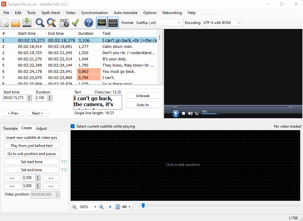

  13. The yts srt is most likely from an 23.976 fps movie, your movie is 25fps, so you have to change the srt timings from 23.976 to 25 fps first.
    Do this in subtitle edit and save the changed file.

  15. Give the new srt the same name as the movie so you can see the movie with the sub with Vlc player
  16. Here a little guide...

  20. Load your srt in subtitle edit, open race.mp4 (open video file), click add waveform. Adjust the first sub with (synchronization, adjust all times).
    Then click on the last subtitle. Is it too early or too late in relation to the last dialog?

  22. Take a look again at my guid above to understand how to load video and audio waveform.
    Double click the first subtitle and it should appear into the video windows, showing the postition into the waveform window too.
    If you play the video, you can control if the subtitle appears in synch with the dialog. If not, you must correct the timing with 'Adjust all times', earlier or later.
