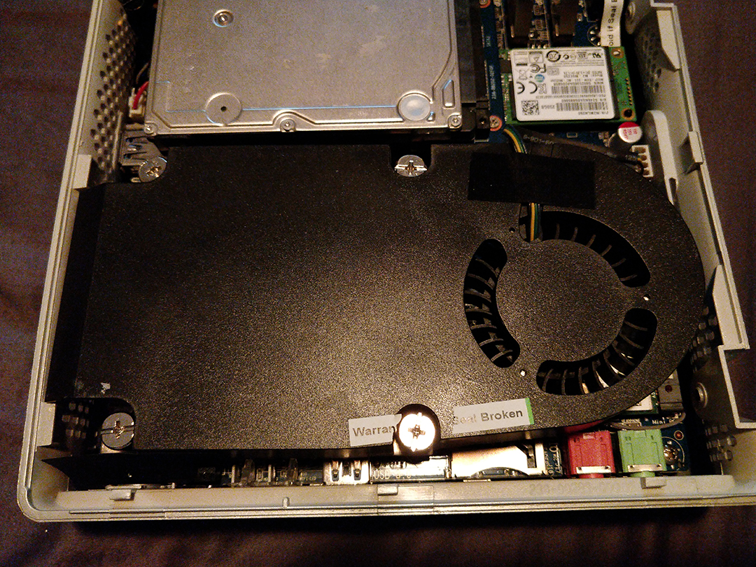

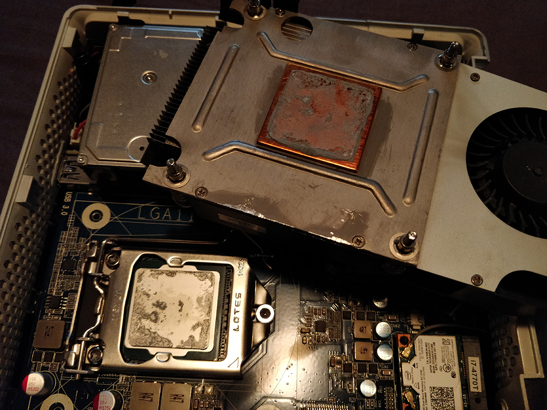

    How hot does a CPU have to get for the fan to kick in? I opened the case and I noticed the fan shroud and the CPU underneath was extremely hot, but the fan wasn't on. I unplugged and replugged the fan and restarted the PC, when it restarts, you can see the fan spinning, then it stops. That's normal, right? But when the system starts to heat up the fan doesn't do anything. I've had external fans on top of this PC for years, so if the internal fan hasn't been working, I wouldn't know. I only notice this today because I disconnected everything to open up the case. So what do you think? Add new thermal paste, but does this fan/shroud unit need to be replaced too?
    [Attachment 61606 - Click to enlarge]
    [Attachment 61607 - Click to enlarge]

    the fan should be spinning to help keep the computer cool.
    is the fan clogged with dust ??
  8. Originally Posted by october262 View Post
    Originally Posted by kanamit View Post
    Originally Posted by TimA-C View Post
    Check your HDD and RAM. If you've had the PC for a while then it might be time to replace the thermal paste on the CPU and/or GPU coolers? Have the fans gotten noisier recently?
    You might also want to check the voltages out of the power supply in case they're no longer up to spec. If you're using the on-board network card then it might be worth dropping in a PCI/PCI-E replacement network card. Over the years I've seen many on-board network cards fail without actually appearing to fail - in other words they appear to connect, they seem to work but either VERY slowly or just refuse to transfer any data. Disabling in BIOS and replacing with a sub-£20 card has usually solved the problem.
    Good luck & let us know how you get on.
    Doesn't look that bad at all. Is this fan/shroud a universal design? I feel like I should replace because man, it was super hot. The whole black casing was very hot. Who's cooling the cooler? LOL!
  9. If things were as hot as you say then I'd expect the fans to be spinning. If they're not then I'd investigate whether the fan is failing or if the current 'cooling profile' is one aimed more at keeping things quiet but at the expense of higher temps. For the CPU check the BIOS for any relevant settings, as well as any utils from the motherboard's manufacturer that are running in the background. For the GPU check the graphics app(s) from the graphics manufacturer. (usually right-click on an empty part of the desktop . . . ) While you're at it, check that the case fans are spinning freely and that the grills and vents aren't blocked. Personally, I'd still be tempted to replace the thermal paste if it's been on there for several years. A bit of MX2 or MX4 can do wonders!

    I think it's safe to say it's overheating. If it burns your fingers, it's cooking, replace the fan, use new thermal paste, hope and pray to whatever deity you prefer.

  11. Personally, I'd still be tempted to replace the thermal paste if it's been on there for several years.
    Thermal paste should always be replaced once the cooling system has been disassembled.
