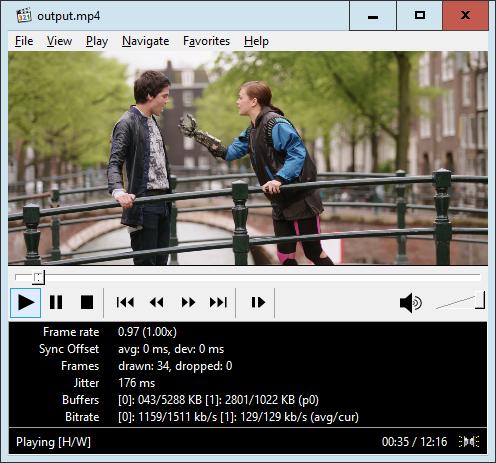

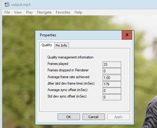

  24. Originally Posted by Skaperen View Post
    Maybe what would help me is a player that can show the frame number (an/or exact time in milliseconds) within the viewed frame (or field number/time/even/odd for interlaced), as well as easy keyboard controls for stop and forward/backward one frame at a time.
    Most media players support frame-by-frame advance. They usually only show time in HH:MM:SS But that's good enough for this. They also let you view the renderer statistics -- which will show the frame rate that's being displayed. In MPCHC for example right click on the player while a video is playing, select Filters -> "name of renderer", something like "Video Mixing Renderer 9".
    [Attachment 61785 - Click to enlarge]
    Many players also let you view statistics (including frame rate) while playing. Look through the menus or right click and select it from the context menu. MPCHC -> View -> Statistics:
    [Attachment 61786 - Click to enlarge]
