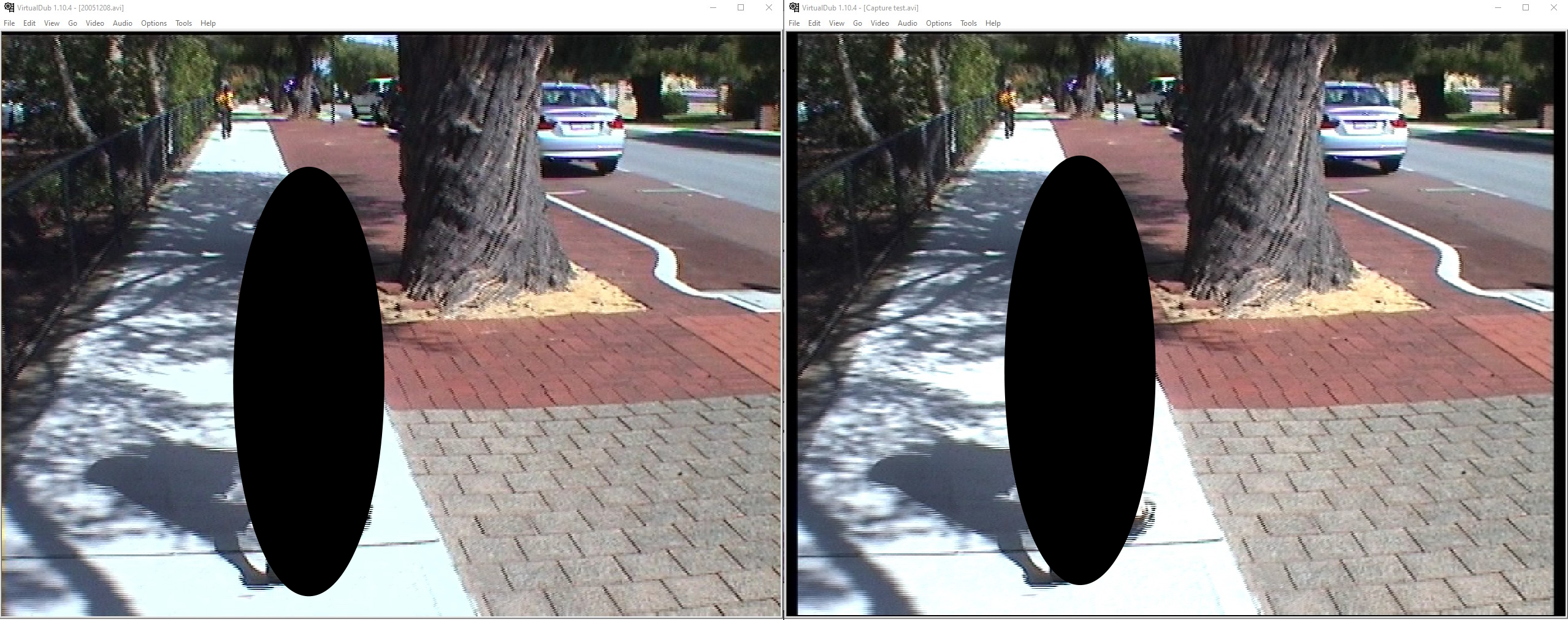

    Do it! If you can't capture as DV, it's not the end of the world. If you can, use an S-Video cable for your video; that'll yield better quality. I've found that an S-video capture is just as good as a DV capture (DV left, AVI from my IO Data GV-USB2 on the right):
    [Attachment 61584 - Click to enlarge]
