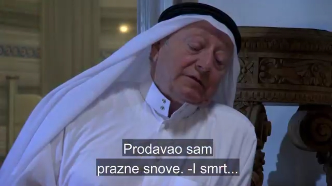

  1. Hello, can a permanently included subtitle be deleted from the background of the image taken from a series? Can you help me please with some advice?
    [Attachment 61547 - Click to enlarge]
  2. If you have the videofile, i am pretty sure, because this subtitle looks like pgs (it is soft)
  3. Originally Posted by flashandpan007 View Post
    I understand what program I can use to delete subtitles because
    I tried with MKVTOOLNIX, but it doesn't display the subtitle, it just shows the video file?
  4. Member Kakujitsu's Avatar
    Jun 2011
    Then it is most likely hard subbed and you will need to use a filter and or plugin or script to remove it, which will require the enter video be reencoded.
    VirtualDub MSU Subtitle Remover
  5. Originally Posted by Kakujitsu View Post
    Thanks so much for the recommendation I hope it works
    Aug 2006
    If the subtitle is burned-in then it is a permanent part of the video. In that case "subtitle removal"means the subtitle will be blurred or replaced with black rectangles in the re-encoded video.
  7. Originally Posted by usually_quiet View Post
    I will try whatever it is thanks for the answer! 😉
