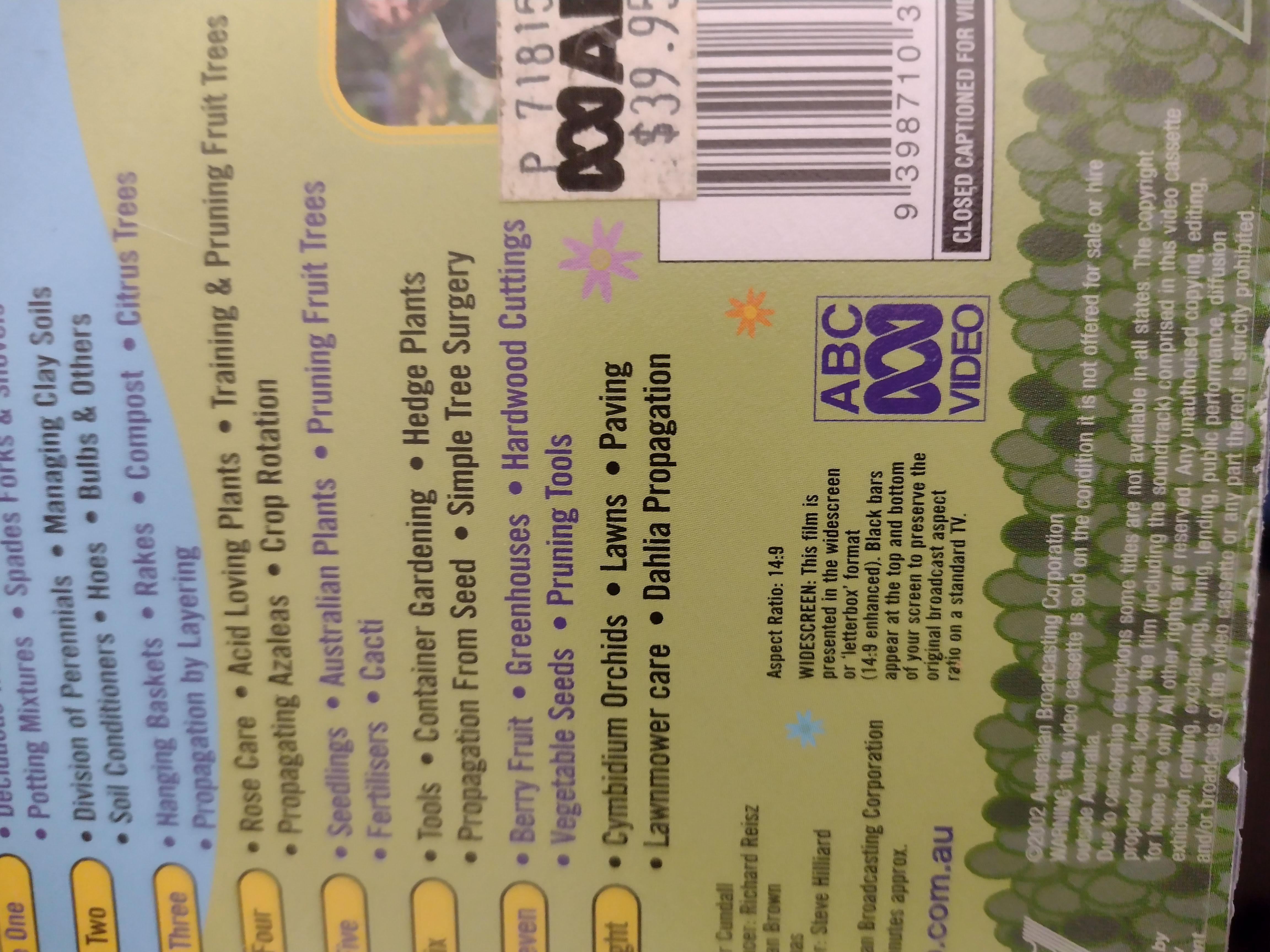

    Hi, I purchased a PAL Gardening VHS tape which I wish to put on DVD but it has an unusual aspect ratio of 14:9,
    Normally I would just convert to 4:3 but I am not sure if this is even possible.
    Any help on the settings to use for conversion would be highly appreciated
    I have attached a photo of the back cover.
    Thank you
Name:	VHS Tape 14 to 9 Aspect Ratio.jpg
    canada
    Hos did you come with a 14:9 ratio,did you capture any of the vhs or just going by the picture specs?
    Look at the box.
    Feb 2017
    Australia
    I was going by the information on the cover.
    I captured at 720 x 576 & the aspect ratio reads 5:4 with Media Info
    Maybe that is correct for a 14:9 aspect ratio?

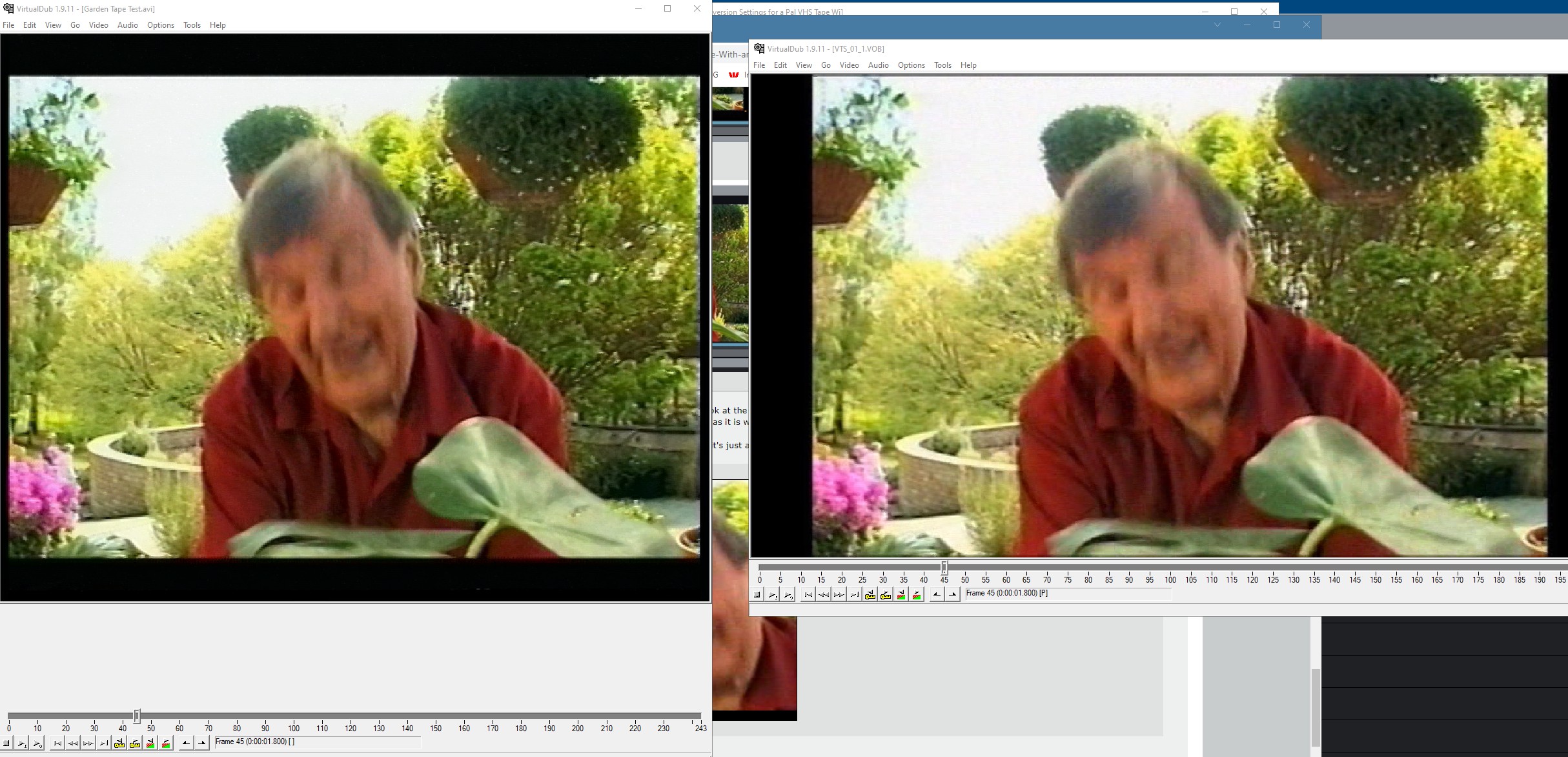

    Here is a capture I did with VirtualDub

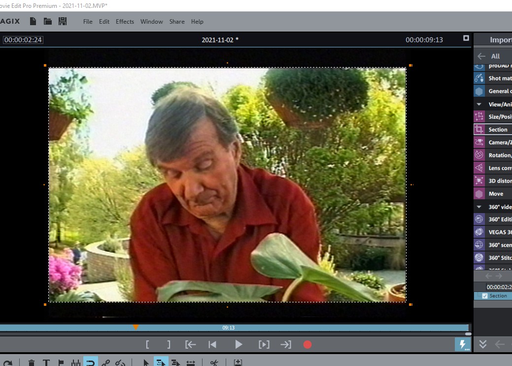

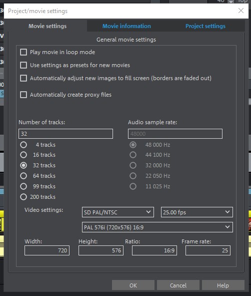

    Taz, set up your movie settings first: File > Settings > Movie... You'll find the dropdown for "SD PAL/NTSC" next to the "video settings" caption.
    [Attachment 61568 - Click to enlarge]

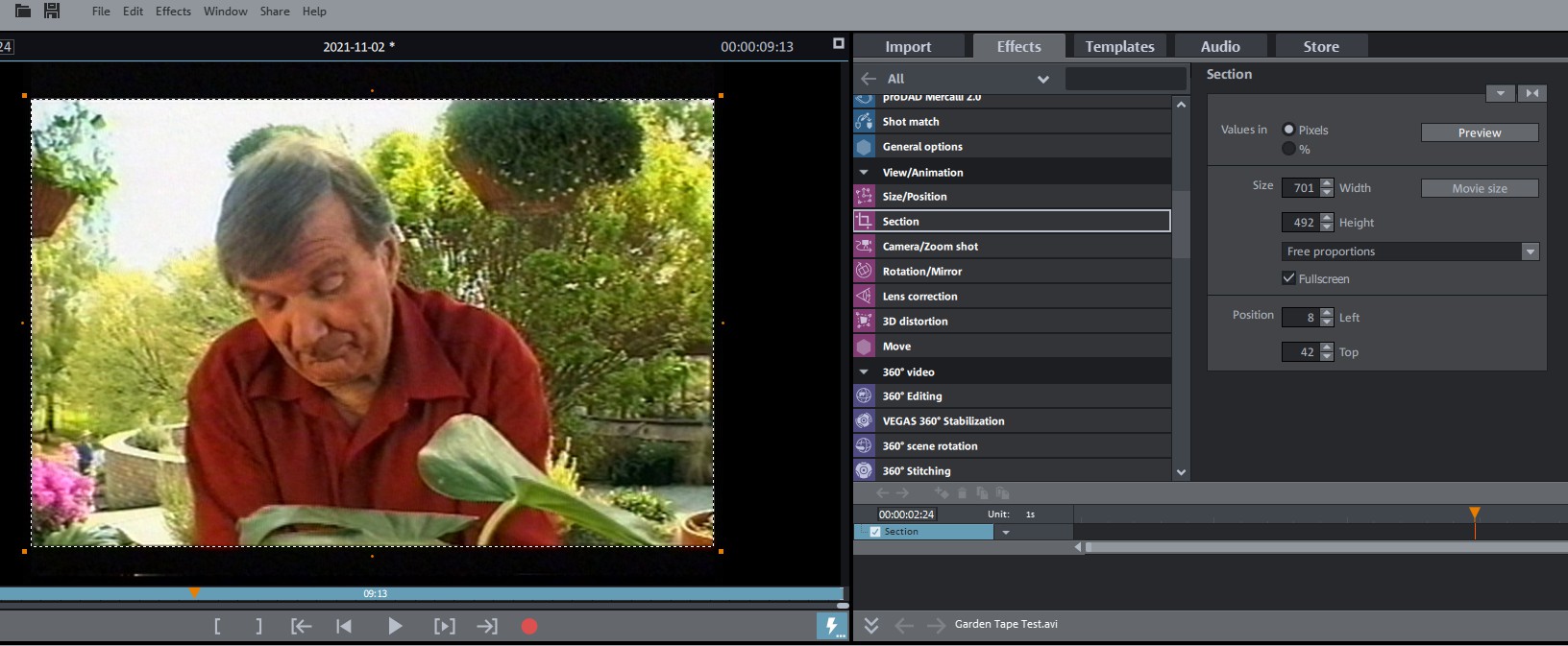

    Now drag your video onto the timeline. MEP will ask if you want to adjust the monitor: click Do Not Adjust.

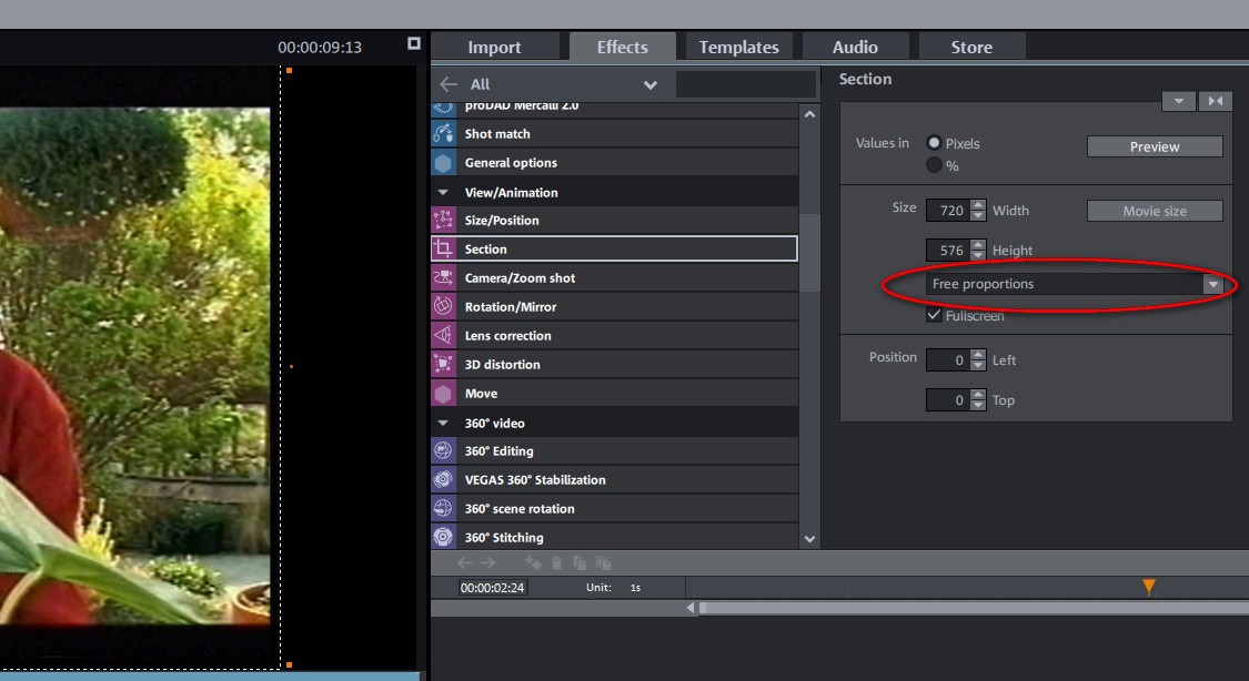

    Click on your video object, then click the Section effect button.
    Choose "Free Proportions" from the section dropdown:
    [Attachment 61572 - Click to enlarge]

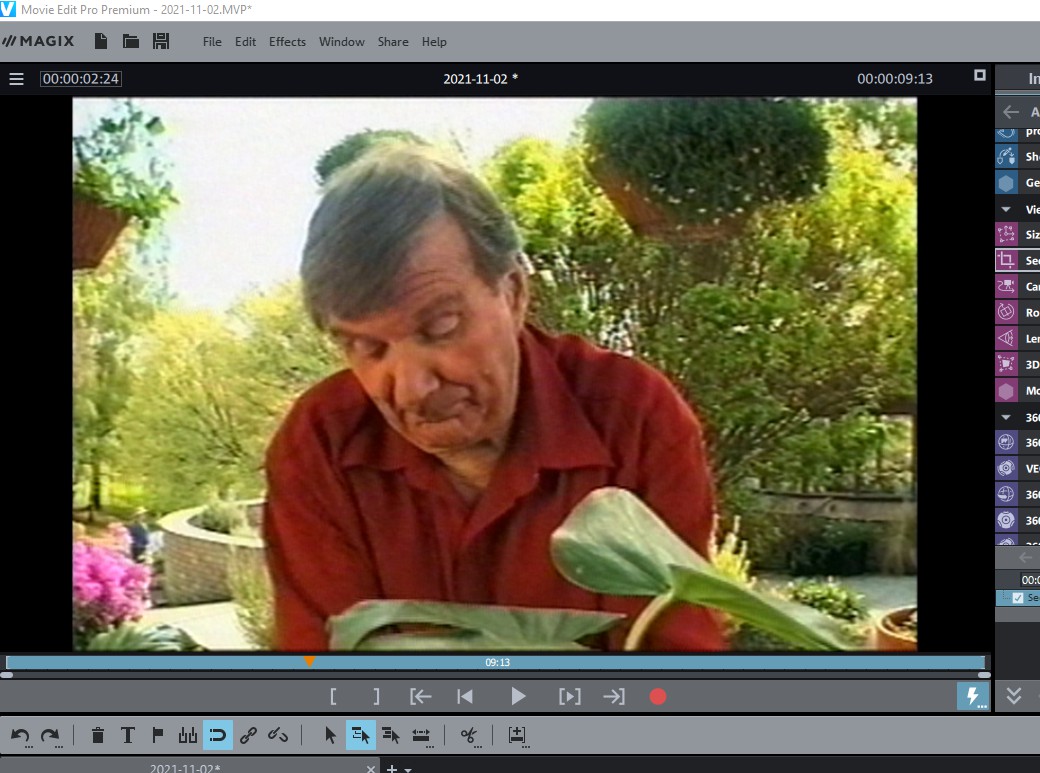

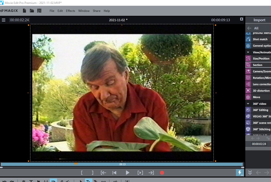

    Drag in the selection box orange handles to the edge of your video, top and bottom, and both sides:
    [Attachment 61570 - Click to enlarge]
    You're in Edit mode at the moment (as indicated by the "Preview" button, top right). Click on Preview and the video will zoom in to fit the most limiting edge (top/bottom in this case).

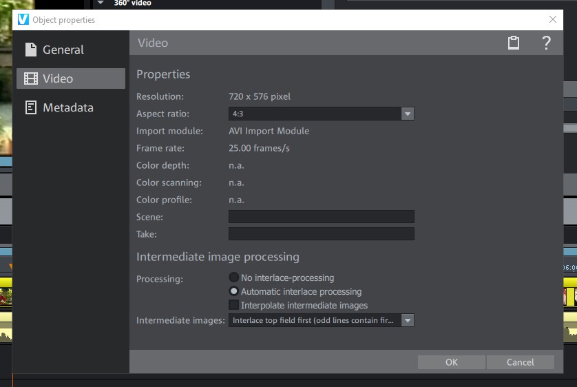

    Last but not least: set the interlacing. Right click on the video object, then choose Object Properties, then Video and set the interlacing as follows:

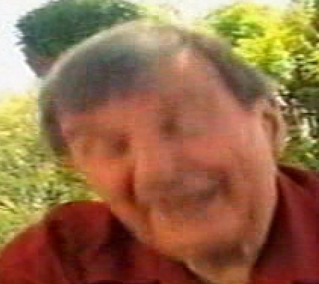

  22. Too strong mpeg2 blocking artefacts IMHO. Look at the guy's face for example. The quality of the encoded picture is clearly worse than the VHS capture. I would increase the bitrate (as much as it is within DVD constraints), or use a better encoder.
    Picture of field#192 for example. Well, maybe it's just at the limit of mpeg2 (for DVD) and one can't expect much better (spoiled by mpeg4 )

    That looks like about frame 45:
    [Attachment 61575 - Click to enlarge]
    I don't see a "significantly worse" video at all. Or another one:
    [Attachment 61576 - Click to enlarge]
  24. Fair enough. The blocks were just eye-catching when I stepped through the fields. Then only I noticed oh it's mpeg2 (a request for DVD compliance).
    On the positive the encoding masked the dotcrawl of the capture. (I guess it was captured as composite).
