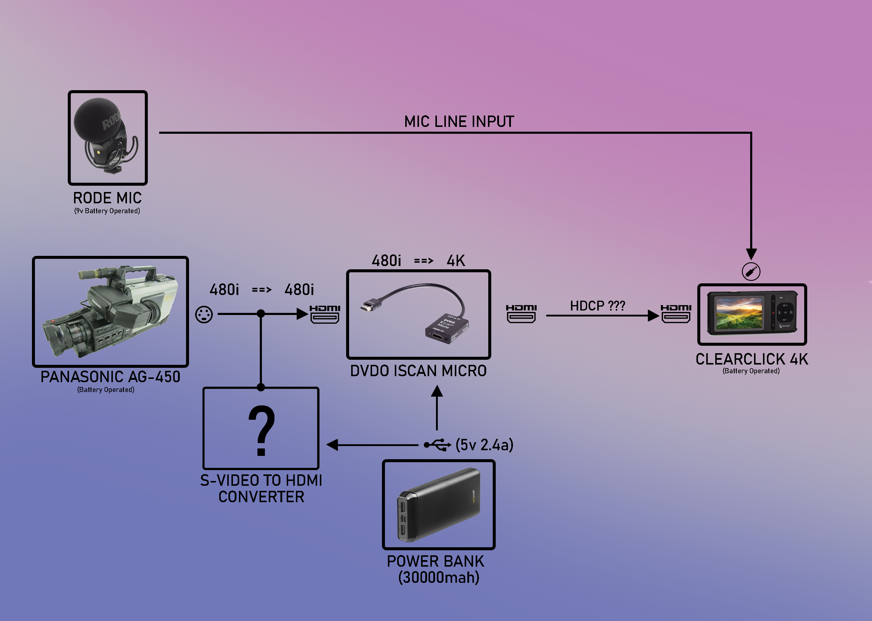

    I'm building a gear from scratch for my work. The idea is to record a lot of footage for a "making-of" of the project we're currently working on with an old VHS camera and eventually upload it online later for nostalgia purposes
    I have ten VHS cameras that I bought in 2014 because it was cheap (it still is for some models) and because I was a big fan of the low resolution quality and glitch capabilities of the media.
    For this project I picked one of my favorites: S-VHS Panasonic AG-450.
    I decided to mount the camera on top of a DSLR shoulder stabilizer and bypass the VHS transport recording system by directly feeding the camera's output signal to an external recorder/digitizer. Fortunately the 450 does have an S-Video output. The external recorder would also feature a microphone input to record audio from an external microphone and a small LCD screen to provide video feedback, (The AG450 viewfinder broke and would not be reachable anyway since the camera is on top of the stabilizer)
    To record the camera signal I opted for a "ClearClick" product. The company sells more or less cheap products (both in price and build quality) but apparently it does the job (according to online reviews) So I ordered the "Video2Digital 2.0" version and immediately faced problems with audio because the device requires line level inputs and not mic levels. Also the device lacked of the mount screw that I needed to properly fix it on the DSLR shoulder mount. So I sent that away and was left with two options:
    I could buy a little more expensive product from ClearClick that featured everything I needed (but it could complicate the task) or look for something way more expensive in the "pro" field.
    When looking closer, the "ClearClick 4k ultimate" happens to feature everything I need for a little extra cash but this device does not accept S-Video or Composite... only HDMI and that's where trouble starts.
    Since I might use a 4K recording device I can eventually upscale the AG450 signal to 4k (for fun and experimental purposes)
    For this, I plan on using a DVDO Iscan Micro which, imo, is the most compact and most efficient device for this purpose at this price level. Besides, the smaller the devices, the better because all of this gear has to be mounted on a stabilizer at some point.
    So far so good (I think) now comes the big problem: What cable/adapter should I use to get the most transparent 480i signal from an S-video source up to HDMI.
    The goal would be to feed the Iscan Micro with the cleanest 480i signal possible before upscale.
    I have looked around and it seems that a simple cable just cannot do the trick and i'm left with myriad of crappy amazon converters that, for the most part, completely wash out the video quality, luminance, black levels, color saturation etc....
    So let me sum it up in a simple screenshot:
    [Attachment 61534 - Click to enlarge]
    Also i'm not sure if the DVDO ISCAN is HDCP compliant. The documentation on both the DVDO website and various infos online do not provide this information.. Maybe i'm missing something. If the DVDO is indeed HDCP compliant, it will heavily complicate the task because the ClearClick 4k isn't and will most likely display a black screen...
    Please share any thoughts, any details you might know!
    Also if my setup sucks please tell me why! I'm here to learn too!
  2. Capturing via AV to HDMI upscaler seems like a terrible idea. I think other forum members can help you with the capture card choice, as I am not very professional in that field

  5. I did not find any better solution to record real time upscaled VHS camera feedback in 4k
    imo you would get better results by plugging cameras S-VIDEO output to a capture card and recording it with a laptop. Post processing allows for better de-interlacing and colour work.

    Regarding your graph, you do not need to worry about HDCP at all if your video source is the analog output from a camera. The DVDO doesn't add HDCP. It only passes along HDCP if it is present in the incoming HDMI signal.
    That's a relief thanks!! Are you familiar with the Iscan Micro? How does it perform when it comes to upscaling SD sources?
