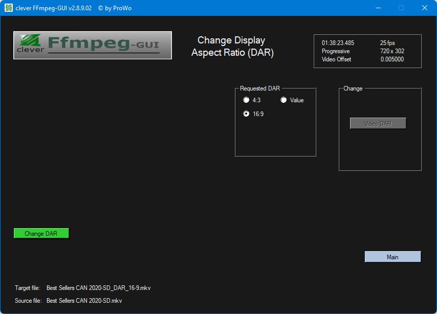

The new video has an incorrect DAR (Display Aspect Ratio, 4:3 instead of 16:9).
Download clever FFmpeg-GUI, read carefully the notes at first start, then load your new video, click main, click change video DAR, select 16:9 on requested DAR, click change DAR. Done!
No reencode needed, fast and easy.
[Attachment 61497 - Click to enlarge] -
I wonder why PowerDirector decided to do that without my instruction... Oh well... Thanks for this and I will give the tool a go
Turns out PowerDirector has an aspect ratio setting independent of the input video or timeline, and that's what it uses to create videos. Mine was set to 4:3, once I changed it to 16:9 everything worked fine.
