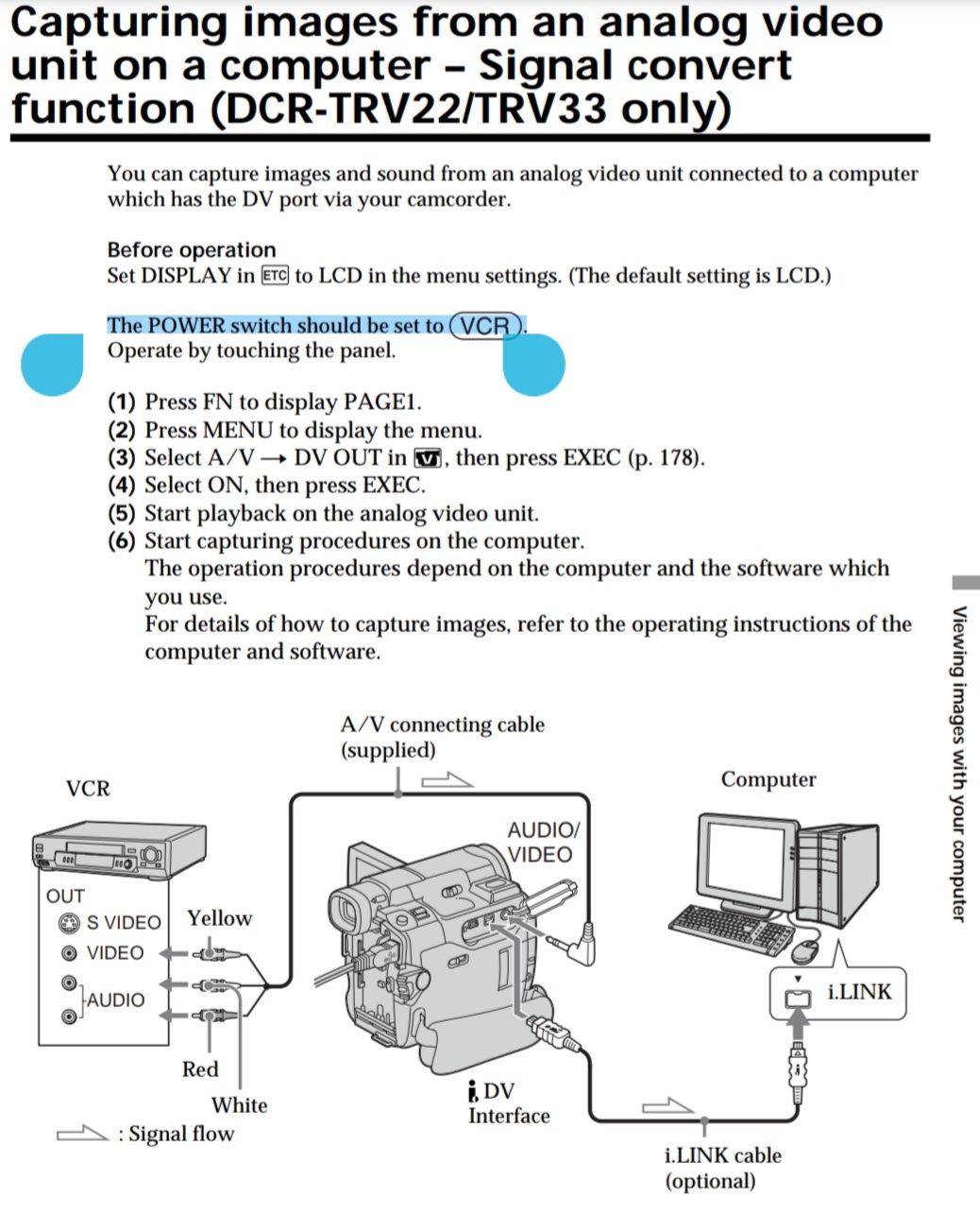

    So that's the back story. So I am trying to get the capture to go through my Sony TRV22 camcorder, which has a passthrough capability. So I should be able to run the VHS through the camcorder, then out through firewire to my PC. And I am 99% sure I've tested this successfully in the past and got it working. But it will not work for some reason. I read in another thread that in the settings I need to set "A/V > DV OUT" to ON, which I have done. And in the "etc" menu, I have set Display equal to V-OUT/LCD. I have tried going through a RCA to mini RCA plug to the A/V plug on the camcorder, and I have also tried s-video. Neither will display the VHS picture on the LCD screen, or in my capture software. Tried virtualdub as well, and can't see it there. I know this is reaching, but if anyone out there has any tips I'd appreciate it.

    I've never used a Sony MiniDV, but based on my Sony Digital8 and this YouTube video showing DCR-HC96, the signal input should display on the LCD when the settings are correct. It would be very user-unfriendly if this wasn't the case.
    I've attached the relevant manual page. It says Display should be set to LCD. Also, make sure the camcorder is in VCR (not camera) mode.
Name:	Sony DCR-TRV22 signal convert.jpg

    I use both D8 and MiniDV and both work the same way. Make sure the settings are correct on the camcorder then switch it off. Plug in the Firewire cable and switch the camcorder on in VCR mode. The computer should detect it and ask you how you want to transfer. If you have WinDV installed, that should be one of the options.

    Having used this method with Sony MiniDV camcorders myself, I am sure the camcorder's LCD would display the incoming signal if everything is set up correctly. Try archiving that first before even connecting the Firewire cable.

    LCD should display the incoming signal and winDV or sclive is the software to transfer DV stream not vdub, You could use vdub if you use A/V out of the camcorder and the diamond capture device you have with much better quality but you loose the LTBC feature you have if using iLink through DV conversion.
