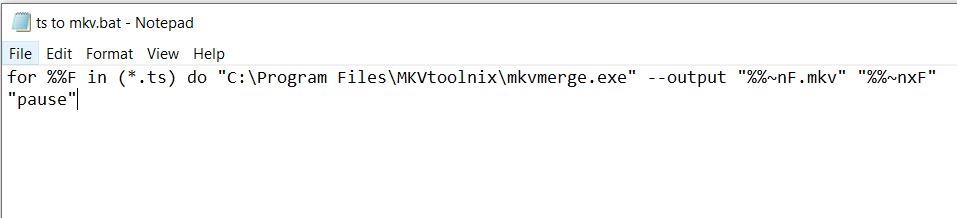

	I only have a few ts files handy to test, and they only have one video and one audio track. But the following works:
 Change the path mkvmerge.exe.Code:for %%F in (*.ts) do "G:\Program Files\MKVToolNix\mkvmerge.exe" --output "%%~nF.mkv" "%%~nxF"
	You have two quotes at the start of C:\... There should only be one.
 Also note that the %% syntax is for use in a batch file. If you type it in at a CLI you should use a single %.
 Put a pause on the next line (of the batch file) so you can see any error messages.

 can you write me the text so I can add the pause, it is important to see what is the mistake but the command screen you know disappear super fast
 is it like the attached photo?
 [Attachment 61474 - Click to enlarge]
