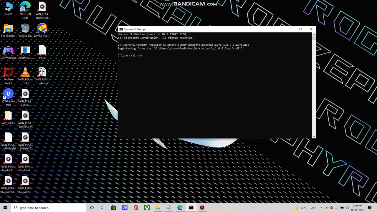

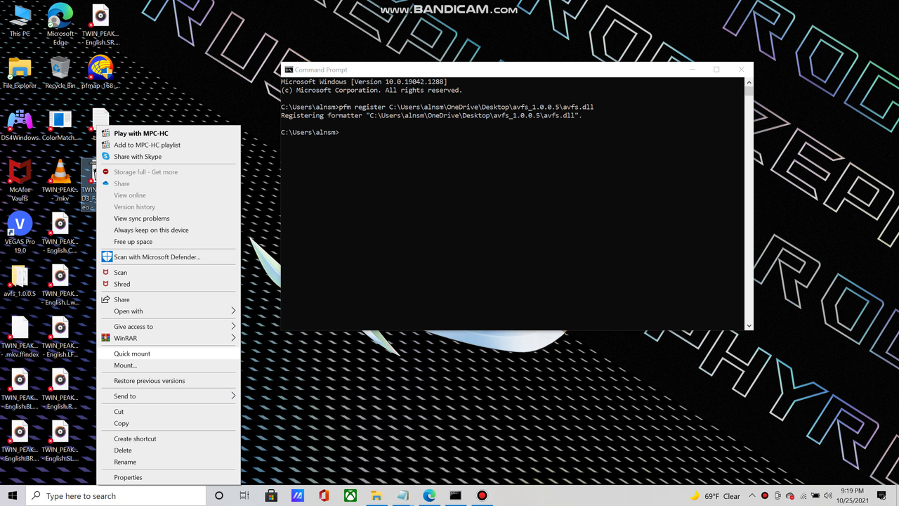

  1. For the purpose of using this guide here, I downloaded and installed all the necessary programs for this including AVFS and Pismo File Mount Audit Package.
    With AVFS, when I follow the installation instructions from the readme.txt about using command prompt to run pfm register c:\windows\avfs.dll after installing PFMAP, I get this

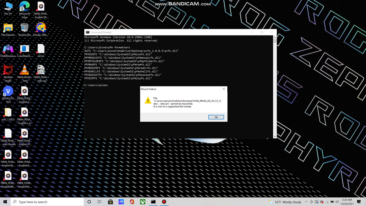

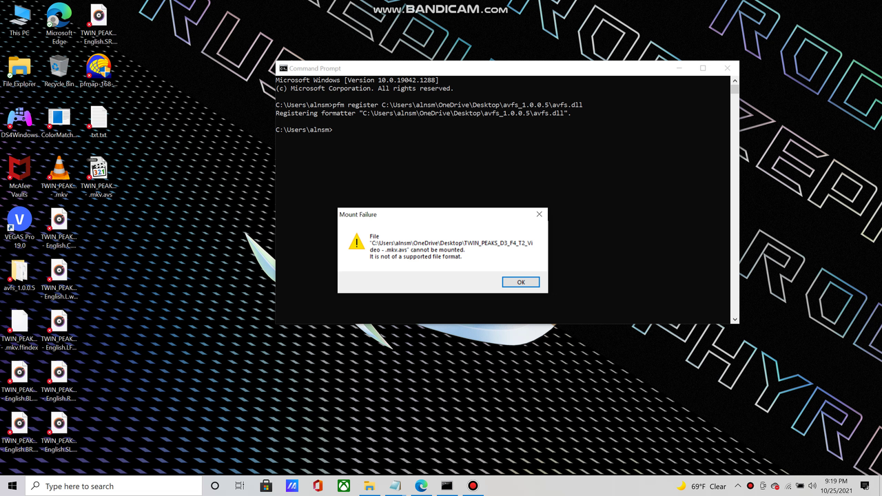

    Then when I try to mount an avs file I get this error message
    Idk what to do from here...

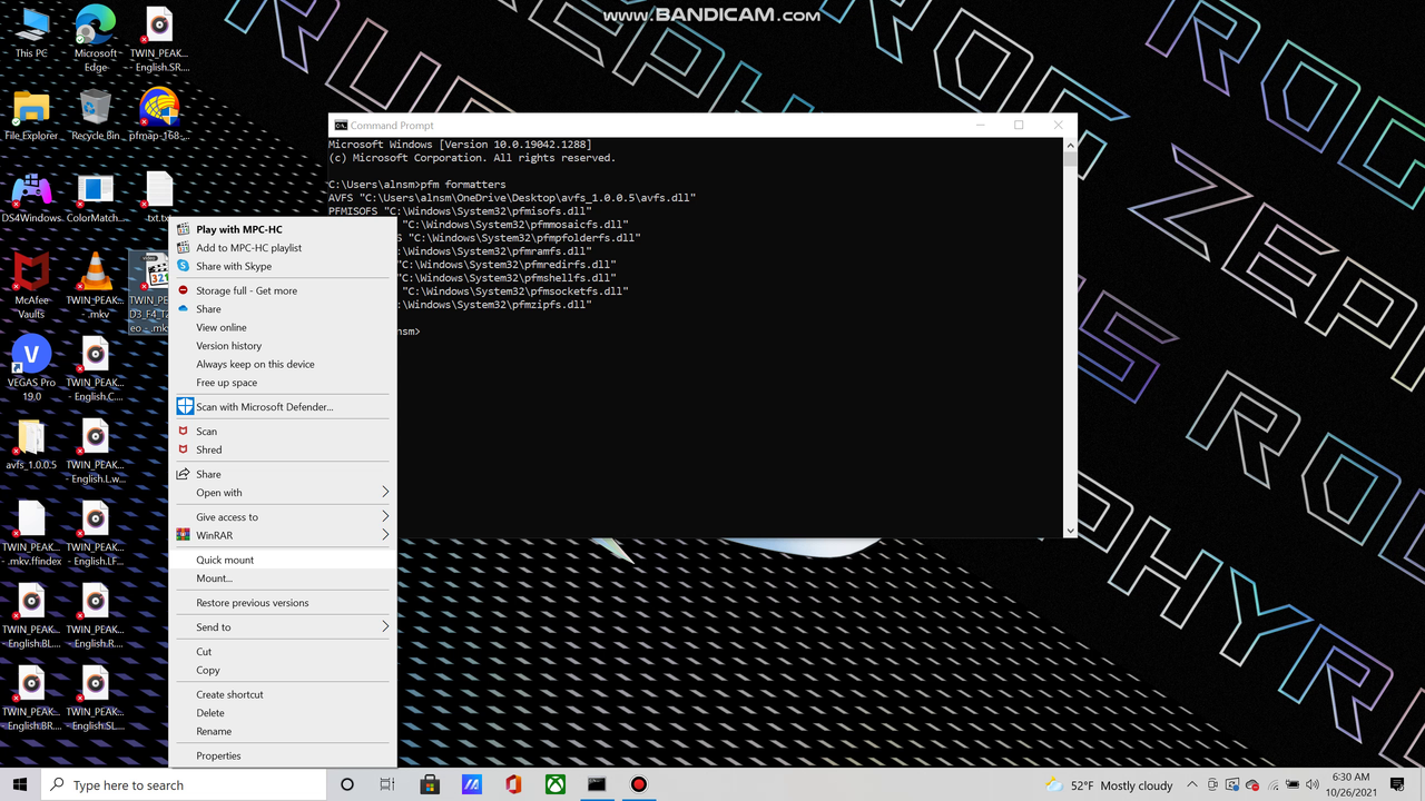

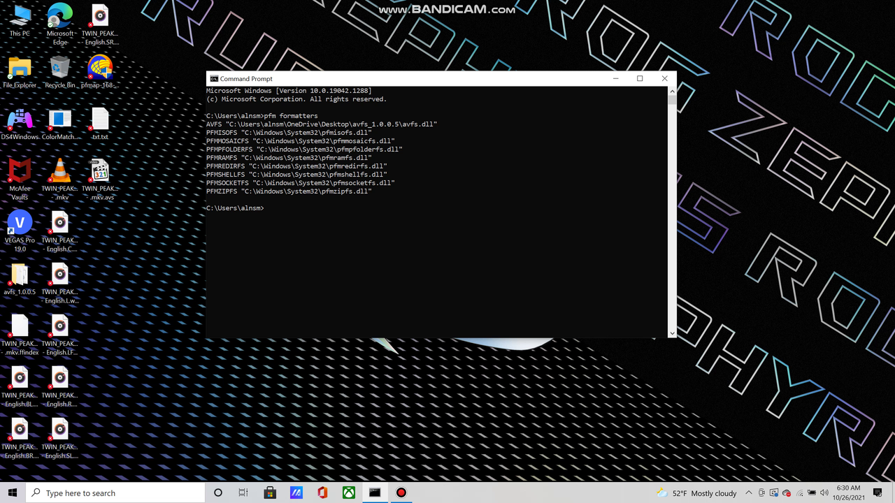

  4. Originally Posted by autodidact View Post
    To see if the avfs.dll was loaded, type in the command prompt:
    pfm formatters
    If it is not listed as an available formatter I would suggest running the register command in an administrator command prompt and see if you get a different result.
    I ran the code and it does show up
    But I'm still not able to mount a file
    For what it's worth, I recently installed AVFS 1.0.0.6 here on W10 and so far it works, following the Installation and Operation instruction in the readme.txt.
    No need to register any .dll as AVFS 1.0.0.6 is a standalone executable (avfs.exe).
    https://www.videohelp.com/software/Avisynth-Virtual-File-System
    https://pismotec.com/download/
    I'm using 10.0.0.5 because it's compatible with the version of PFMAP needed to use Quick Mount as the later versions only have PFM Mount.
