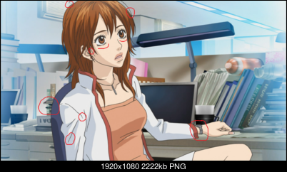

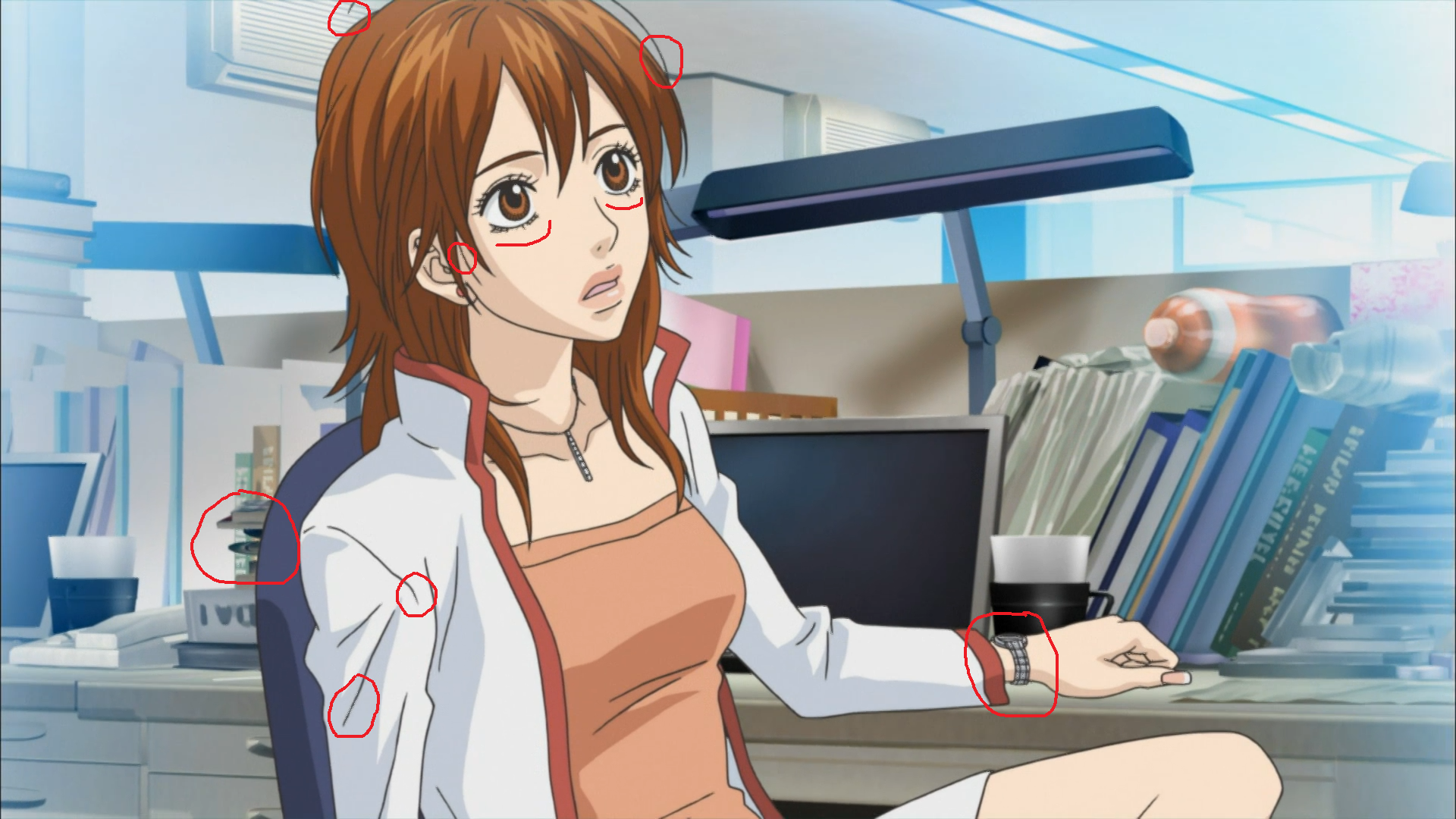

  1. Hello.
    Can you please tell me, using this picture as an example, is it possible to fix artifacts?
    An example would be nice.
    Original.
  2. Was that deinterlaced with Yadif? Dots like those are often produced by Yadif. If so, try using a field matcher like TFM() instead.
    If you're stuck with that as your starting point... The video isn't super sharp so a simple:
    Blur(1.0).Sharpen(0.7)
    will greatly reduce the dots without damaging the rest of the picture too much. Following that a little temporal noise reduction will probably take care of the rest.
