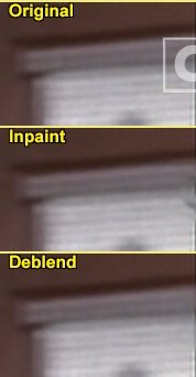

    To do 'Deblend' you need to get good alpha/color masks, in this short sample I don't see qood dark/bright frames to analyze, full video or better samples are needed.
    Anyway we can use something for example. [ @JAX75 Those below Deblend settings are not good! ]
    Mask and one output frame are in the attachments. [127th frame, selected frame where inpaint artifact is visible.]
    c=LWLibavVideoSource("D:\Iv.mkv").crop(156,0,-186,-0)
    out1=c.InpaintDelogo(mask="D:\Mask2.bmp", Loc="1538,60,-0,-948")
    out2=c.InpaintDelogo(mask="D:\Mask2.bmp", Loc="1538,60,-0,-948", Mode="Deblend", dPP=5, Analyze=4, FrW=54, FrS=2)
    Stackvertical(
    \ c.crop(1400,40,-0,-928).AddBorders(0,2,0,0,$F0F080).Subtitle("Original"),
    \ out1.crop(1400,40,-0,-928).AddBorders(0,2,0,0,$F0F080).Subtitle("Inpaint"),
    \ out2.crop(1400,40,-0,-928).AddBorders(0,2,0,0,$F0F080).Subtitle("Deblend"))
    After delogo you can add those borders back if you want - AddBorders(156,0,186,0), plus you can safely downscale it with Spline16Resize(1024, 576) as video is actually upscaled from SD.

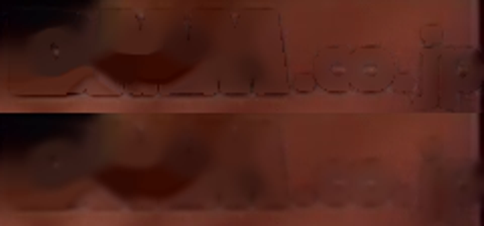

    I tried Automask = 1 weird I get results where the logo has not completely disappeared
  24. Video Damager VoodooFX's Avatar
    Oct 2021
    At Doom9
    If you ask for something then post your whole script, there is hundred parameters, and we are not the fortune tellers.
    "Automask=1" parameter just enables the basemask creation effect, it alone doesn't control effect in any way.

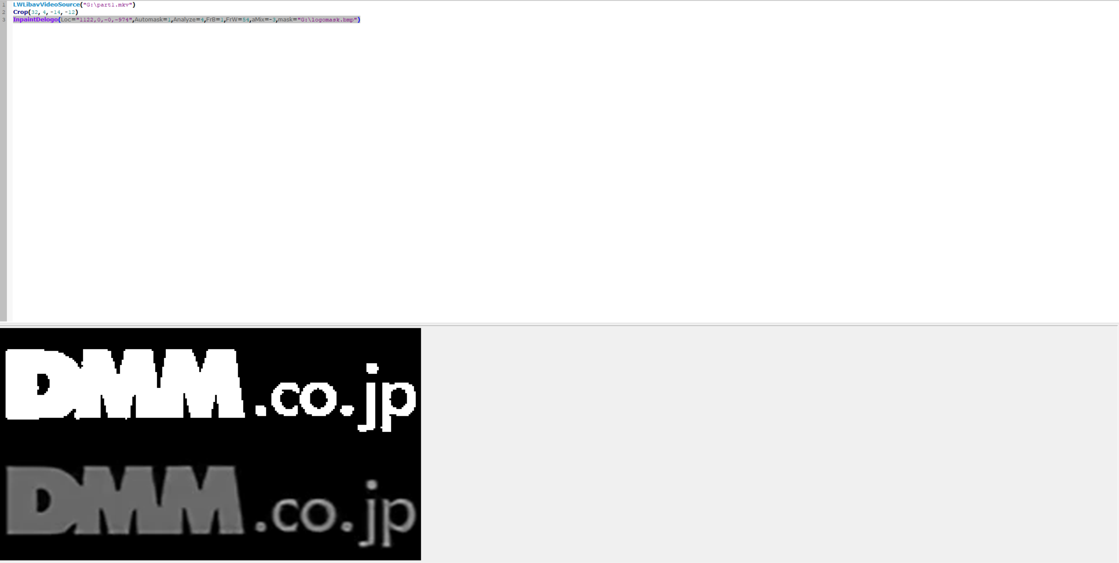

    Hello
  26. Video Damager VoodooFX's Avatar
    Oct 2021
    At Doom9
    Now I see what you meant.
    Mask looks good. You see result of the base mask creation, not the delogo results. The top image is mask, the bottom image is from what it was created.
    Now you need to turn off Automask=0 to proceed setting for delogo.
    Wasn't that clear from the manual? :
    # Int "Automask" :
    # 0 - Off (default).
    # 1 - On. Generates the base mask. Script doesn't do anything else when "On"!
    PS:
    You can right click on AvsPmod' video preview and press "Save image as...". Script is better to share as text [do Copy/Paste].

  27. Originally Posted by VoodooFX View Post
    # Int "Automask" :
    PS:
    LWLibavVideoSource("G:\part1.mkv")
    Crop(32, 4, -14, -12)
    InpaintDelogo( mask="G:\Mask2.bmp",
    \ Automask=0, aMix=0,Loc="1120,6,-2,-978",
    \ Mode="inpaint",
    \ Analyze=4, FrB=0, FrW=0, FrS=0)
    [Attachment 61473 - Click to enlarge]

    Mask is not covering whole logo, see dark edges around, you can try inflate the base mask a bit with "Inflate=2".
    Probably that won't be enough and you would need to create a fatter base mask with higher aMix setting.
  29. Video Damager VoodooFX's Avatar
    Oct 2021
    At Doom9
    Btw, you can use Show=1 to show more steps of what is going on.
    Create a fatter base mask, then use "Inflate=2" and "Show=1" for delogo, then post a screen of what you get.
  30. Originally Posted by VoodooFX View Post
    I must have made a error in loc the logo
