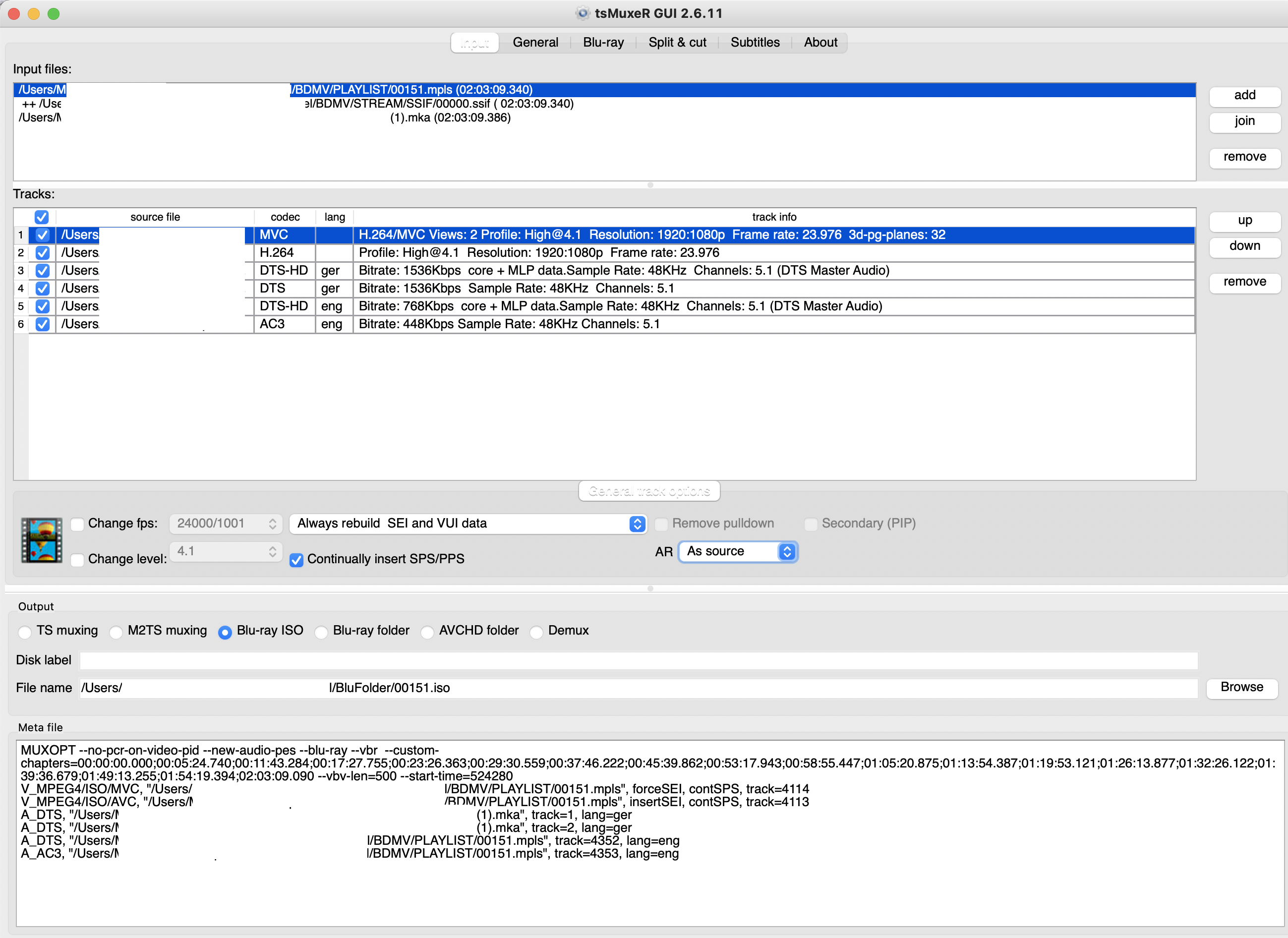

I have a problem with tsmuxer to create a 3D Blu ray. I always get a 2D Blu Ray out.
Am I doing something wrong with the settings?
This is what I did. Opened the playlist of the 3D movie in tsmuxer and added 2 more audio tracks.
Output: Blu-Ray ISO. Then burned to Blu ray BD-R DL. The result is a 2D Blu Ray.
[Attachment 61424 - Click to enlarge]
I don't know. I have to try this.
Another question: Is it possible that the H.264 track must always be the first track? Could this cause the issue? -
I don't think so. It shouldn't matter, but you may try.
How do you play the .iso? Is the folder structure correct? Do you see the .SSIF folder with the .ssif file and the two .m2ts streams (one for the base stream and one for the dependent stream) in the \BDMV\STREAM folder?Last edited by Sharc; 25th Oct 2021 at 03:25.
