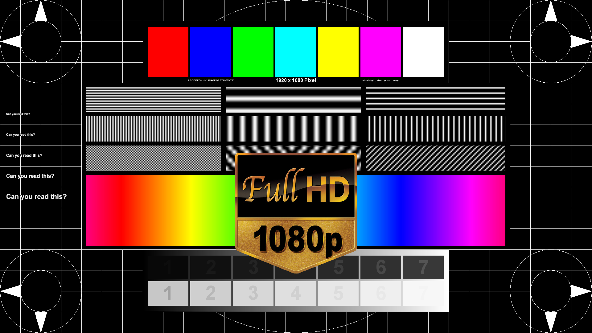

  7. Be sure to view the following images with pixel-for-pixel mapping.
    Starting with a 1920x1080 video:
    [Attachment 61429 - Click to enlarge]
    If you view this pixel-for-pixel you will see that the the grey boxes in the middle have alternating black and white lines and checkerboxes, single pixel and multiple pixel. Most real-world video will not be this sharp.

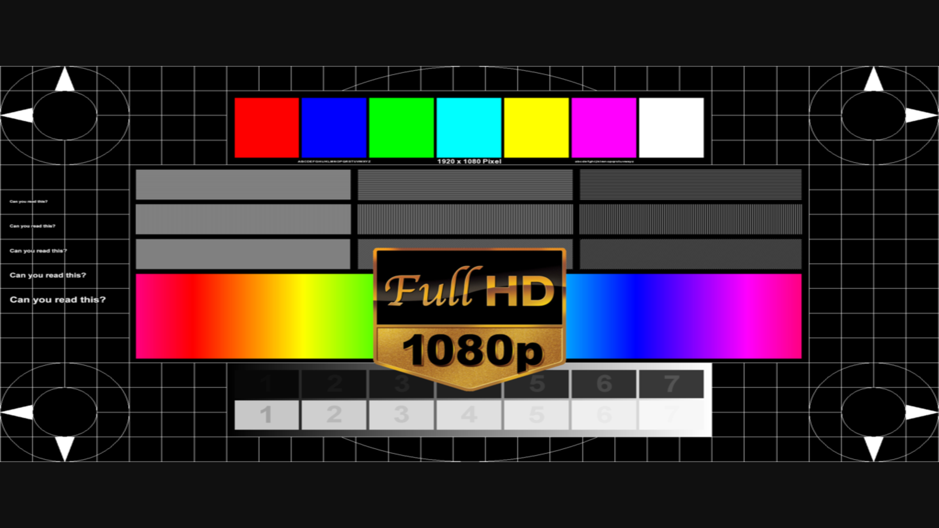

    Your tablet will take that 1920x1080 video, downscale it to 1024x576 to keep the aspect ratio, then letterbox it to fill out the 768 line display:
    [Attachment 61430 - Click to enlarge]
    Note that the letterboxing here is very dark grey so you can (hopefully) distinguish it from the black background in the original video. The letterboxing will likely be full black on the tablet. See how the alternating black/white lines in the center are now grey and full of moire artifacts. Since most real video won't start out as sharp as the video I started with it will usually show less of such artifacts. The smaller text is pretty much unreadable.

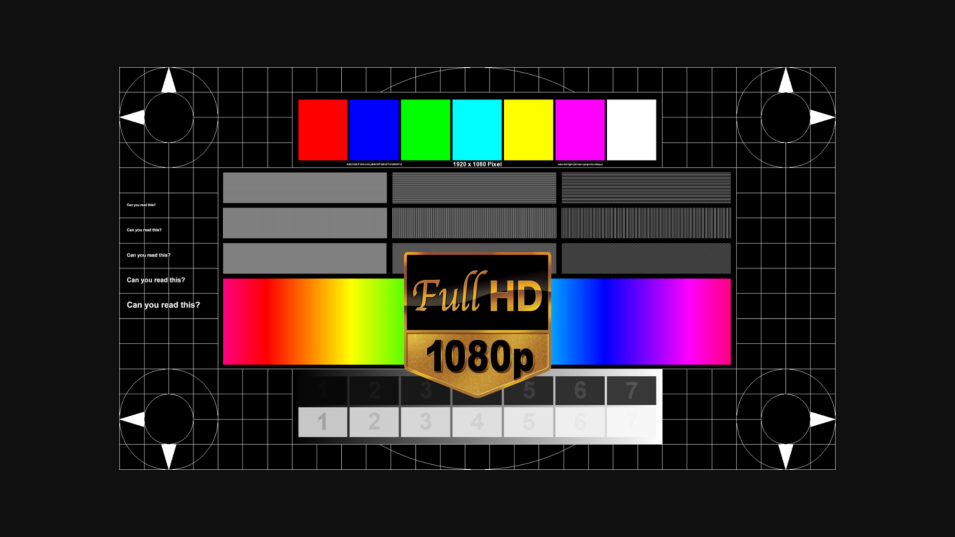

    Then, if you're lucky, the VGA-to-HDMI converter will upscale the 1024x768 frame to 1440x1080 to maintain the aspect ratio, and pillarbox it to 1920x1080:
    [Attachment 61431 - Click to enlarge]
    Again the letterbox and pillarbox bars added here are dark grey but will likely be full black in the final display. And in practice the scaling may not be as clean because of the analog to digital conversion. The smaller text is still unreadable.

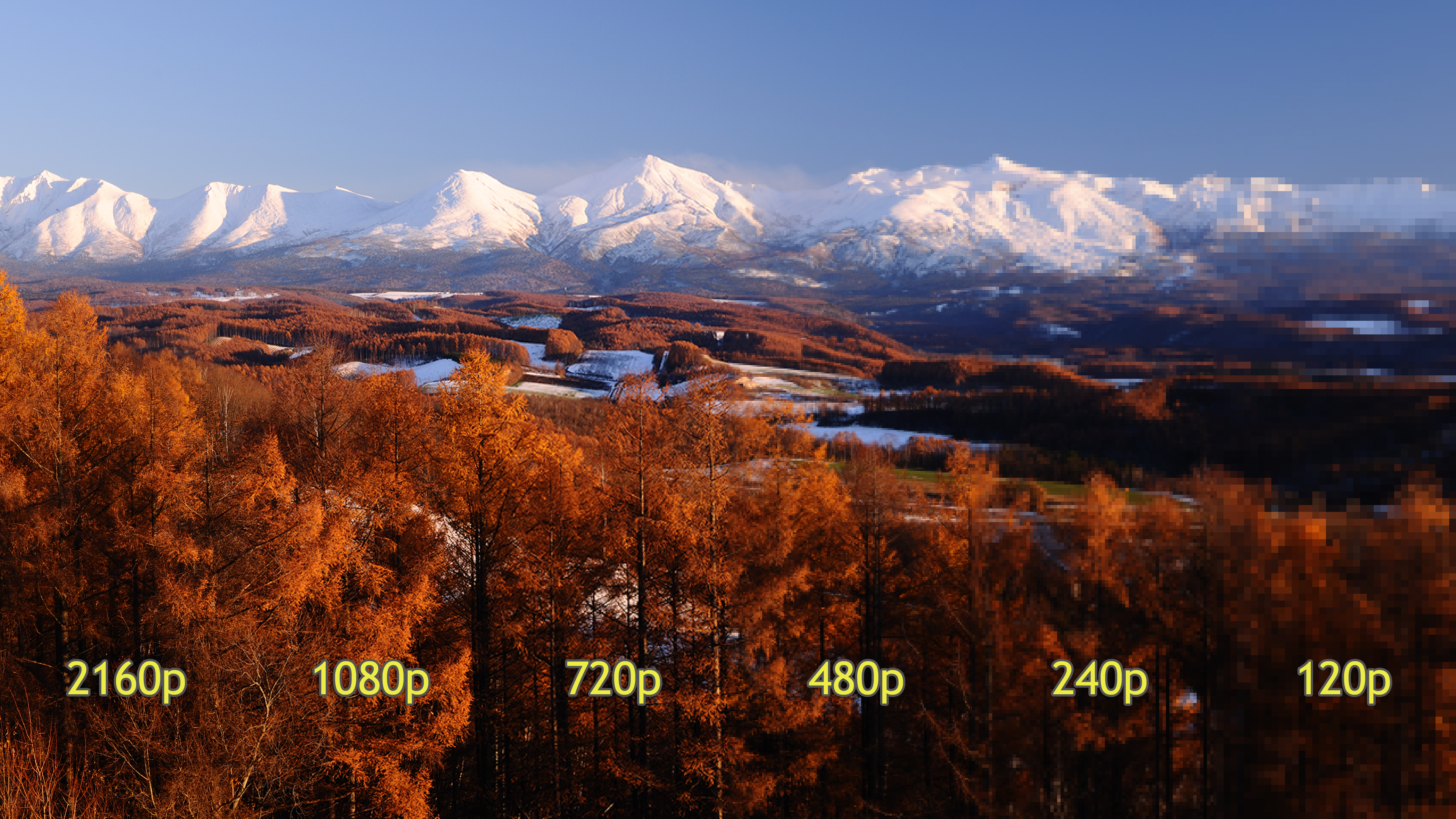

  15. Member Cornucopia's Avatar
    [Attachment 61621 - Click to enlarge]
    This image has sections of comparative resolution in vertical stripes, designated by the text at the bottom.
    Put this image on your device in full screen mode and DON'T ZOOM IN. Get up close enough to your normal viewing distance using that device. What section of the image SHOWS visible pixelation? The section(s) that shows pixelation is BELOW the overall resolving capability of the system. The section(s) that don't show pixelation is AT or ABOVE the overall resolving capability (at your current viewing distance - remember, you are part of the equation). That border then is where your system capabilities lie. Higher resolutions than that border are not more beneficial to you, because your system cannot fully resolve them anyway.
    You can use this comparatively, as you also could with those test patterns. See which stage you are at with the existing setup with VGA conversion, etc. Then see what stage you would be at with straight HDMI.

  17. Thanks Pandy, that was very helpful. But even with an excellent adapter, I would still get a better picture on the TV if I connected a new computer with HDMI output to the TV, right? It all seems like too much trouble and I should probably just buy a new PC, especially since this old one has a dead battery that I can't get a replacement for, and its USB ports have become unreliable through overuse...
  18. Thanks Cornucopia. That image is blurry at 120 and 240, marginal at 480, and 720, 1080 and 2160 all look about the same.
