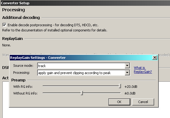

  6. If you want to change the volume "on the fly", try foobar2000. You first have to run a ReplayGain scan on the file and save the data. It's quite fast and supports all the common formats, including wave files.
    In the ReplayGain section of the converter configuration you can configure the volume. 89dB is the ReplayGain default target volume. It's a sound pressure level based on a SMPTE standard but it translates to -18dB on an output meter. The ReplayGain data saved to tags contains the peak level for each track and the volume of the track in relation to the target volume. So if the result of a track scan is -4dB, it means the volume is 4dB above the target volume.
    In the converter setup, when you enable the ReplayGain volume adjustment, there's a slider for adjusting the volume above or below the default target volume, should you desire a different volume. If you want to use old-school normalising so the audio peaks are at maximum, select the "prevent clipping according to the peak" option and set the pre-amp volume to +20dB. Foobar2000 will adjust the volume to 20dB more than the default target volume, or until the peaks are at maximum, whichever comes first. Unless the volume is unusually low, it'll be the latter.
    [Attachment 61726 - Click to enlarge]
    When you use a lossless encoder you can select the output bitdepth. The default is "auto" which outputs a 16 bit file for lossy sources, and for lossless sources it's the same bitdepth. I always adjust the volume of audio tracks to the default ReplayGain volume. For movie/TV soundtracks the industry standard is 5dB lower, as they tend to be more dynamic.
