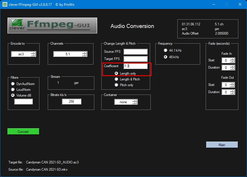

  4. Download the newest beta here:
    https://files.videohelp.com/u/292773/clever_ffmpeg_gui_newest_beta.7z
    Then load your mp4, click main, click Convert Audio stream, Continue, type 1.2 in the coefficient field, select pitch only below, leave all other settings as they are, click convert.
    [Attachment 61385 - Click to enlarge]

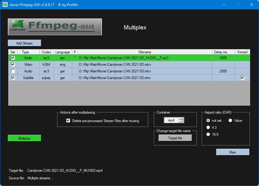

    When done, click Multiplex, all necessary streams are already loaded (the new created audio stream is shown in green color), deselect the old audio stream, select mp4 as container (if it is not already selected), click Multiplex.
    [Attachment 61386 - Click to enlarge]
    All done!

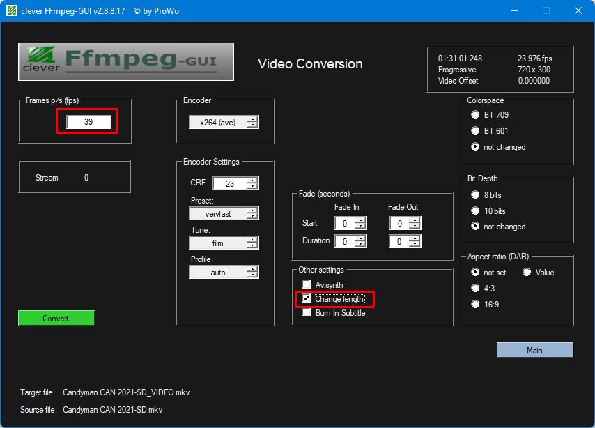

  8. The video currently has a frame rate of 30.
    If you want to shorten the video by a factor of 1.3, it must be encoded at 39fps.
    This shortens the time from 67 min to 51.53 min.
    To achieve this, load your video, click main, click convert video stream, click continue, enter all data as on the picture, click convert.
    [Attachment 61387 - Click to enlarge]
    If done, click Convert Audio stream, Continue, type 1.3 in the coefficient field, select lenght only below, leave all other settings as they are, click convert.
    [Attachment 61388 - Click to enlarge]
    Mux afterwards as indicated above.

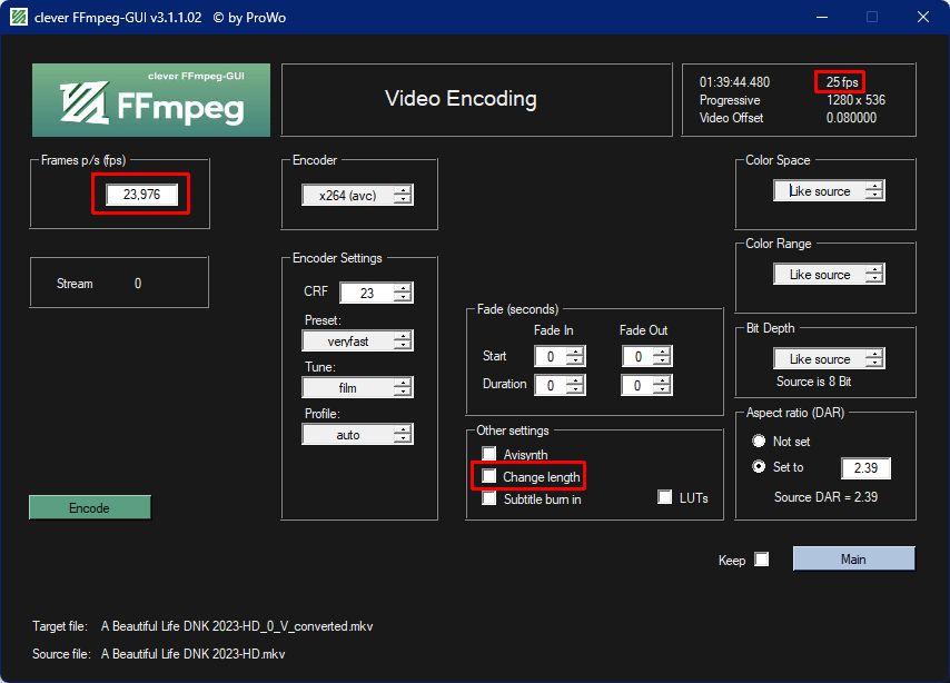

  12. Originally Posted by ConverterCrazy View Post
    I updated the software to latest version 3.1.1 and the ffmpeg to the recommended version.
    Now, the option in the image [Change length] has vanished.
    Reverting to older version 2.8.8 doesn't work.
    What can be done now?
    You mean Change Length in the Video encode section?
    The checkbox is only displayed if the target FPS is different from the source FPS.
    Otherwise it makes no sense.
    [Attachment 71563 - Click to enlarge]
