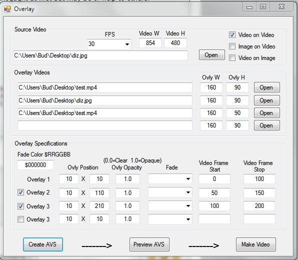

    Just my preference but I use Avisynth because the timings for each overlay, position, and duration can be set. You can also mix and match Images/videos for different base file and mixed overlays. Below I have a image as the base file and overlay both image and video. Setup is shown below. Takes a little thought at first but may be of help to others.

    P.S. (I Cheat)
    [Attachment 61567 - Click to enlarge]
