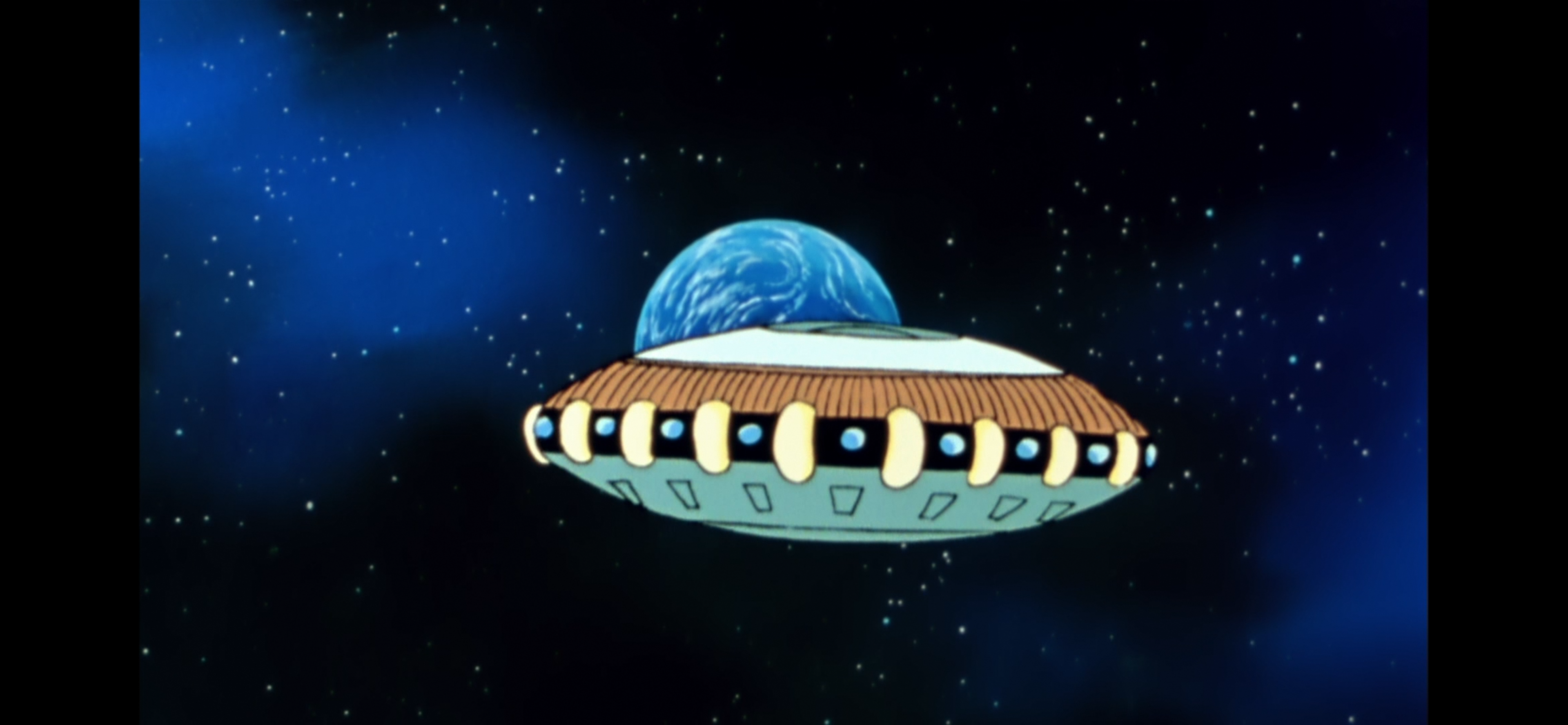

    Hi I am doing a personal project and I want to brighten the german video of DBZ Kai which after episode 54 gets very dark and saturated for some reason. I am using Davinci Resolve and I used the french video as reference because it doesnt have these issues. However I don't want to use the french video because it is bitstarved and possibly DNR'd as well because it has less grain and a few details get deleted, whereas the german video has as far as I can tell all the grain and has higher bitrate. It is much harder than I thought though, as I can't seem to match it exactly as something is always a bit off. But the biggest thing is that dark areas show a lot of blocking and that is what bothers me the most.
    Here is the german video untouched for example

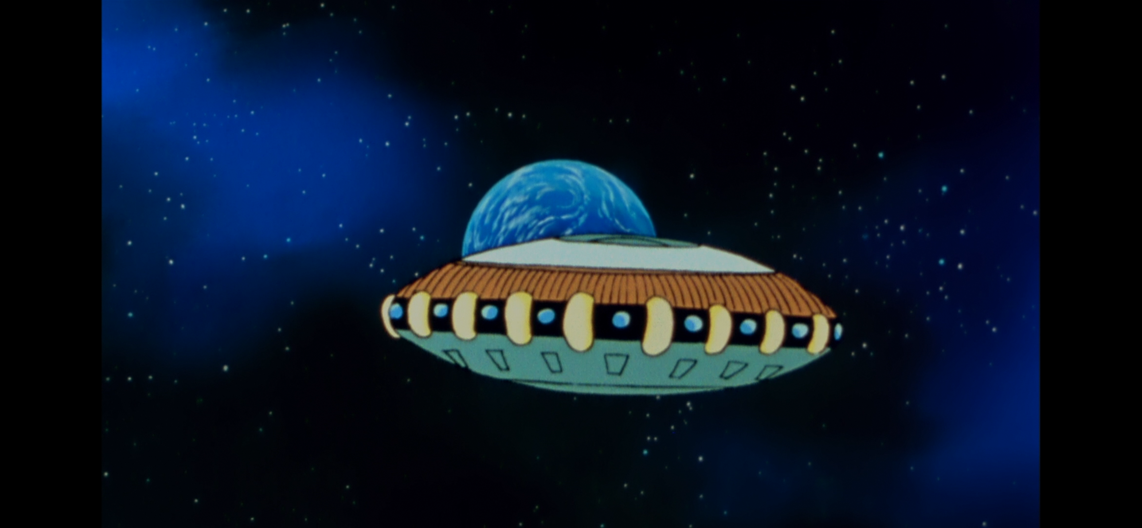

    This is the french video
    [Attachment 61315 - Click to enlarge]

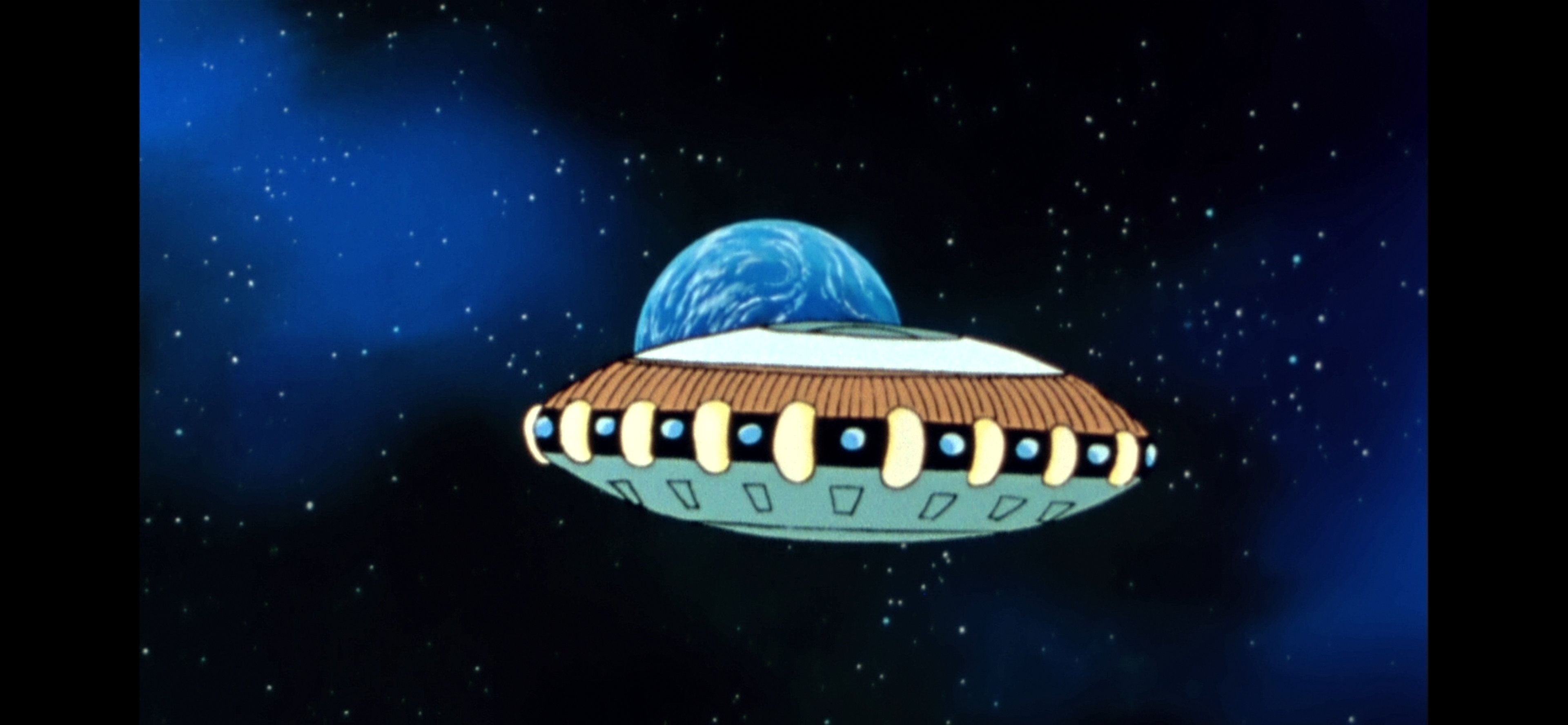

    And this is the best I have managed so far to make it look right
    [Attachment 61316 - Click to enlarge]
    So I would like it know if there is any way to fully restore the picture to what it should be because I have been trying for days and can't make it look exactly the same and I would like to know if it actually is possible to do so. Thanks!
  2. iirc Davinci Resolve has some "Shot Match to This Clip" option have you tried that?
    If using Avisynth ColourLike (http://forum.doom9.org/showthread.php?t=96308) might be interessting.
  3. To reduce the posterization you'll need something like GradFun3() in AviSynth. Some temporal smoothing may help too. Upload video samples (and not reencoded), not images.

    I tried that in Davinci Resolve but it isnt accurate at all really, it adds a lot of contrast and makes the blocking look very green. Does your program Hybrid have ColourLike? And I think it already has GradFun3 which jagabo mentioned.

    Using AviSynth, I had good results "matching" videos from different sources using GamMatch:
    https://forum.doom9.org/showthread.php?p=1846777#post1846777

    Yes, and another option is MatchHistogram , which has both avisynth and vapoursynth implementations

    colourlike is an older plugin and nobody made a x64 version. You can use it with x86 avisynth, or you can use it with mp_pipeline (avisynth x64 host that can run x86 plugins and processes). It's a bit complicated and requires 3 passes (1st pass each for the source and reference to write their histograms to a text file, and a final pass for output) . It requires YV12 , so I cropped 1 line from bottom. (Why did upload a 3840x1776 screenshot instead of 1920x1080 ???) . It wasn't as close to the "French" reference, and there are not really any settings to tweak for a single image
    MatchHistogram is less complicated, doesn't require multiple passes or writing text files, and has a smoothing setting you can adjust where the interpolation of the histogram values can be smoothed more or less (more or less transition zones). It was the closest to the reference out of these 3
    GamMatch should work, post your script if you want to debug it. But it adjusts channel min and max, and average - the values in the middle are not adjusted as much, so it's less likely to match. You might be able to tweak some settings to get it to match more, I didn't play with it too much
    Here are previews on that single image with default settings (not necessarily reflective of what you get in other sections of actual video)
    In all cases, whenever you "brighten" a source, you usually reveal compression artifacts, blocking and increase posterization - what jagabo mentioned earlier - so you might want to apply other filtering

    For me, I would question if "matching" the French version is the right thing to do in the first place. You could just correct it normally however you want
    If you want to use one of these, e.g. MatchHistogram -
    I would check other sections to make sure. Because it's close on 1 frame doesn't mean it will be close on other sections. You can preview scripts in megui or staxrip (or other tools like vdub2 , avspmod, or media players like mpchc)
    You would edit the avisynth script that megui or staxrip generated for you , basically copy and paste the lines, edit the paths, change the source filters for the reference and your clip
    If you put the .dll in the appropriate plugins directory it will autoload, or you can use LoadPlugin explicitly in the script
    http://avisynth.nl/index.php/MatchHistogram
    Because I used an image that you uploaded, not a video, I had to change the source filter, and convert to YUV
    ref=ImageSource("PATH\00013.m2ts_snapshot_11.26_[2021.10.16_21.58.35]_french.png").ConvertToYV24(matrix="rec709")
    clip=ImageSource("PATH\New folder (135)\00001.m2ts_snapshot_11.26_[2021.10.16_21.58.40]_german.png").ConvertToYV24(matrix="rec709")
    MatchHistogram(clip, ref, y=true, u=true, v=true)
    But yours might look something like this , it should already be in YV12
    ref=LWLibavVideoSource("PATH\00013.m2ts")
    clip=LWLibavVideoSource("PATH\00001.m2ts")
    If you post the script, and what error messages (if any), or a log file someone can help you out . Or if you're using vapoursynth in staxrip, it's a bit different but I can help you out there too, you just have to provide some info
