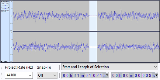

  1. Hello to all. I have a 3 hour audio file where there are very small mute audio gaps caused by microphone problems. They are really short, less than 10 milliseconds, but clearly noticeable and very annoying.
    [Attachment 61304 - Click to enlarge]
    My problem is none of the programs I have used, including Reaper, Audition and Audacity, are capable of detecting silence gaps of less than 10 milliseconds ...
    How can I do?
    I don't want something that automatically eliminates these gaps because I want to fill them manually to keep the file length unchanged, I just want something that tells me where they are. I hope someone can help me. Thanks

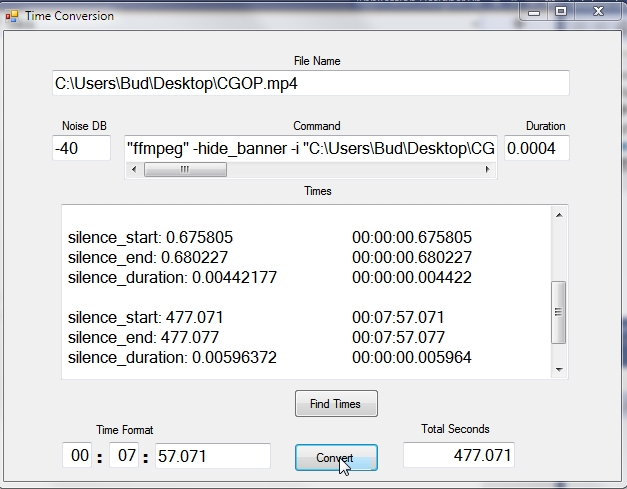

    I have no life.... LOL Quick view... Actual conversion to complete.. Anyone see anything missing that would be needed for time conversion?
    [Attachment 61360 - Click to enlarge]
    OOOPS... Yes final would be in HH:MM:SS.mmm

  12. Sorry I don't understand ... What is that? Are you creating a software?
  13. Member Budman1's Avatar
    Jul 2012
    NORTHWEST ILLINOIS, USA
    Yes, i just created that to drop your video at the top and it uses silencedetect to find the gaps you requested and convert them to standard HH:MM:SS.mmm format in one fell swoop.
    When its dont it will also have an interactive dynamic conversion from/to either seconds or formatted entries. That is you enter seconds and it coverts or you enter formatted to convert to seconds.
    This program i wrote to do all you requested just by drag/drop video in filename box. Finds gaps, lists them, converts to formatted dates.
