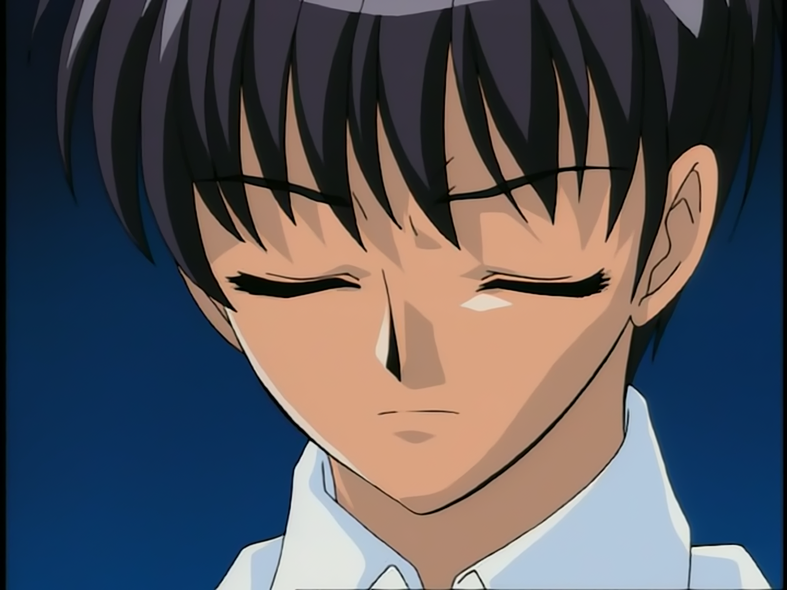

    Currently here are the best results I have achieved with VapourSynth:
    This is the source footage:
    [Attachment 61299 - Click to enlarge]

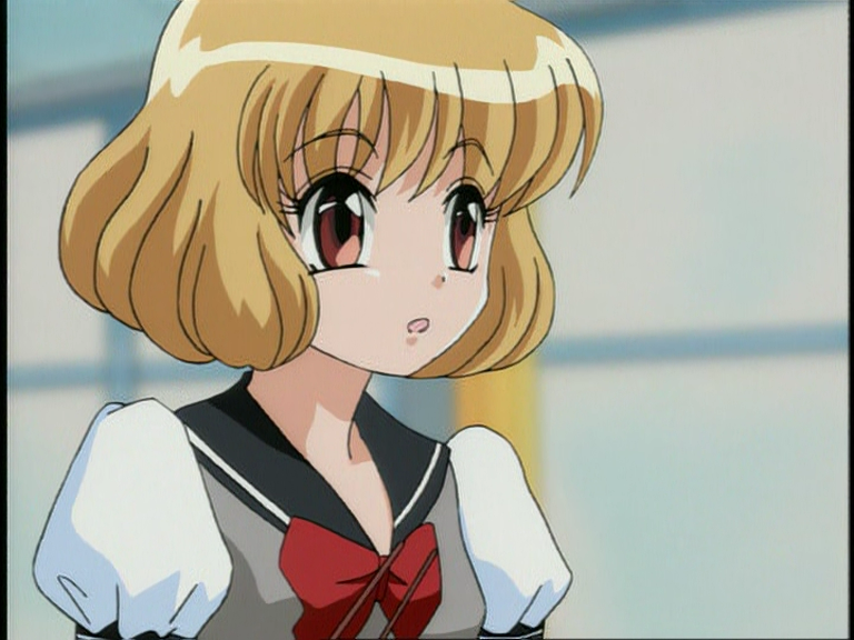

    This is my current version of the remaster:
    [Attachment 61300 - Click to enlarge]
    This is before additional noise reduction and sharpening in After Effects
    And here is an example of the full process including upscaling and After Effects:

    There are still things I am tweaking and actively working on. You will notice some of the lines are thinner or rounder.
    This is due to awrapsharp and Hysteria. Its a conscious choice that results in much, much sharper and clearer line work and
    is a sacrifice I am willing to make.
    But any more advice would be appreciated

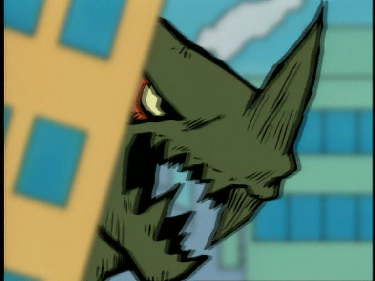

    The problems
    The thing I haven't been able to solve is Double Images/ghosting.
    Japan is NTSC and SA is PAL. Idk how Funimation converted NTSC to PAL but it appears that they blended every 3rd frame.
    So there is a lot of ghosting on all frames and fields both before and after deinterlacing and on individual fields.
    This is an example of the worst of it and its not present in every frame but about 40% of them are this way.
    Source Image:
    [Attachment 61301 - Click to enlarge]
    As you can tell, not only is the ghost shifted to the left, the upcoming frame ghosts into the previous frame too. Idk if this was intended. You can't notice it unless you pause but its there. Is there anyway to solve this?

  2. Without a sample hard so say anything useful.
    Assuming the frame after and before the blended frame is blend free, removing the blended frame is probably the easiest solution,..
  3. You're an anime fan that prefers dubbed audio? Yes, as Selur says, we need samples showing the problem, untouched from your source. 10 seconds should be enough. You can cut the samples from the DVD using DGIndex.
  4. You can cut the samples from the DVD using DGIndex.
    or mpeg2cut2
  5. If there are even higher quality replacements do recommend! Thank you!
    VSgan, if you have enough time and vram (obviously after the deblending process)
