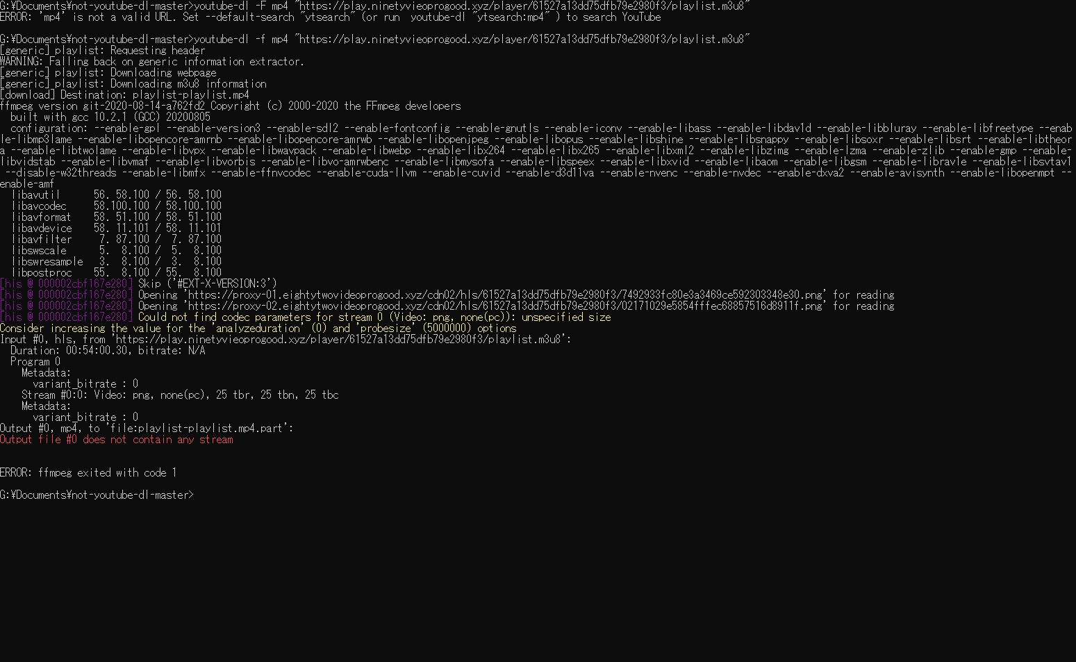

I am attempting to download a video and I get this error when I press enter
Here is an image of my cmd showing this erorr
[Attachment 61287 - Click to enlarge]
How can I fix this?
Very interesting challenge.
The playlist #EXTM3U looks like this
Code:#EXTM3U #EXT-X-VERSION:3 #EXT-X-TARGETDURATION:8 #EXT-X-MEDIA-SEQUENCE:0 #EXT-X-PLAYLIST-TYPE:VOD #EXTINF:5.100000, https://proxy-01.eightytwovideoprogood.xyz/cdn02/hls/61527a13dd75dfb79e2980f3/7492933fc80e3a3469ce592303348e30.png #EXTINF:8.500000, https://proxy-02.eightytwovideoprogood.xyz/cdn02/hls/61527a13dd75dfb79e2980f3/02171029e5854fffec68857516d8911f.png #EXTINF:8.500000, https://proxy-01.eightytwovideoprogood.xyz/cdn02/hls/61527a13dd75dfb79e2980f3/03fd114296b1df5f3cc8dbc92af53d18.png #EXTINF:8.500000, https://proxy-02.eightytwovideoprogood.xyz/cdn02/hls/61527a13dd75dfb79e2980f3/153ea369a9d30c1eed8b777e7e738cbb.png #EXTINF:7.067000, https://proxy-01.eightytwovideoprogood.xyz/cdn02/hls/61527a13dd75dfb79e2980f3/6c790394ebecd031e8da936e0e8c24a7.png #EXTINF:8.133000, https://proxy-02.eightytwovideoprogood.xyz/cdn02/hls/61527a13dd75dfb79e2980f3/bdf6a20f75de00efe238df4def1eaad9.png #EXTINF:8.500000, https://proxy-01.eightytwovideoprogood.xyz/cdn02/hls/61527a13dd75dfb79e2980f3/b8bfa23a23548c6730bd522291c7115b.png #EXTINF:8.500000, https://proxy-02.eightytwovideoprogood.xyz/cdn02/hls/61527a13dd75dfb79e2980f3/233a32dde84ccc9f96514f8240fb6d44.png #EXTINF:8.500000, https://proxy-01.eightytwovideoprogood.xyz/cdn02/hls/61527a13dd75dfb79e2980f3/cdcb3a752f62b7640b78002427429d35.png #EXTINF:8.500000, https://proxy-02.eightytwovideoprogood.xyz/cdn02/hls/61527a13dd75dfb79e2980f3/50a61448d7203d256f5e21c84858090d.png #EXTINF:5.134000, https://proxy-01.eightytwovideoprogood.xyz/cdn02/hls/61527a13dd75dfb79e2980f3/7e254806e06bc32369c140bed451affd.png #EXTINF:8.500000, https://proxy-02.eightytwovideoprogood.xyz/cdn02/hls/61527a13dd75dfb79e2980f3/8741d7738d9cb34ea88d94fc7cf69e63.png
This type of playlist is not a candidate for yt-dl as yt-dl does not expect urls to be in .png format
Downloading a sample .png indicates that the reference file is not a .png file. This file is actually a mp4 file renamed to .png.
Therefore, you have to download all the .png files and after download, you rename to .mp4

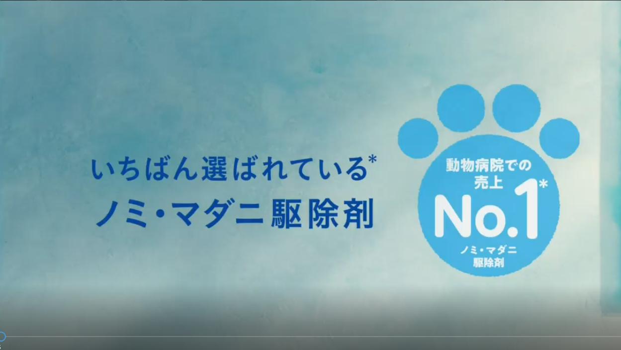

I downloaded the first video file and here a frame capture ...
[Attachment 61288 - Click to enlarge]
Hope this helps -
