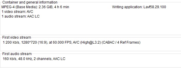

    Here is the information from one of the videos in that program.
  9. For a 4h 6 min video with 1280x720 resolution the size is ok. There is nothing to change.
