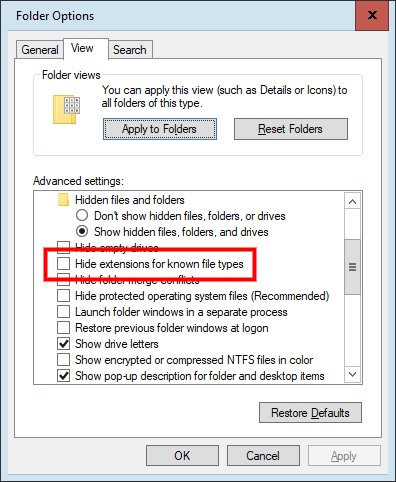

    The first thing to do is to turn off Windows Explorer's "Hide extensions of known file types" -- one of the worst defaults in the history of computing. The extension is an important feature of any O/S that uses it to determine what the file type.
    [Attachment 61271 - Click to enlarge]
    Then you'll be able to see all extensions and change them when necessary.
