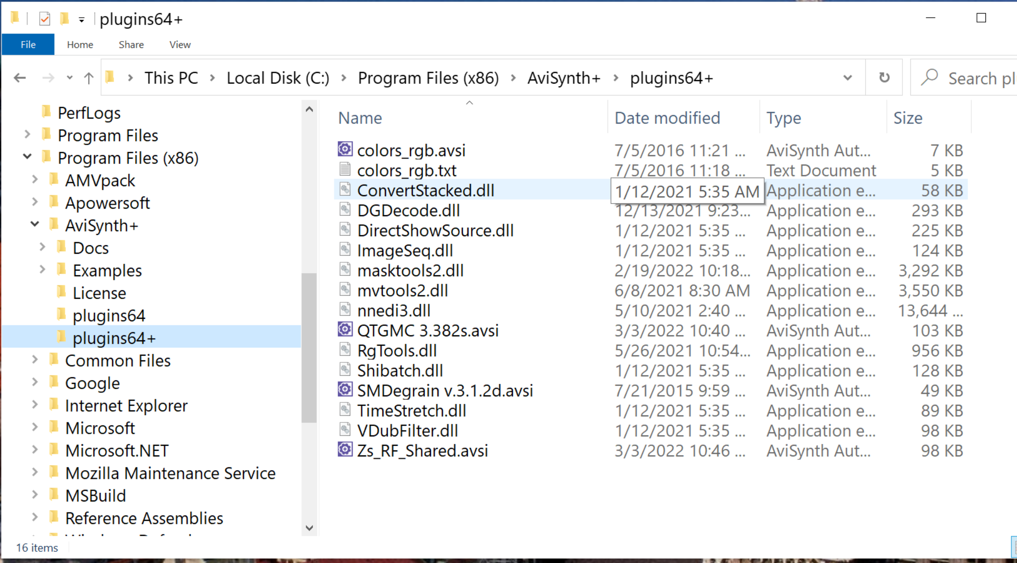

    Originally Posted by satimis View Post

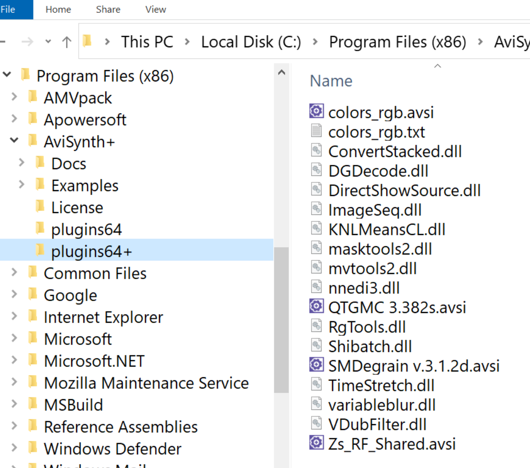

    nnedi3.dll is for w7. What shall I do ?
    Copy (move) it to the plugins64+ folder.
    Already done

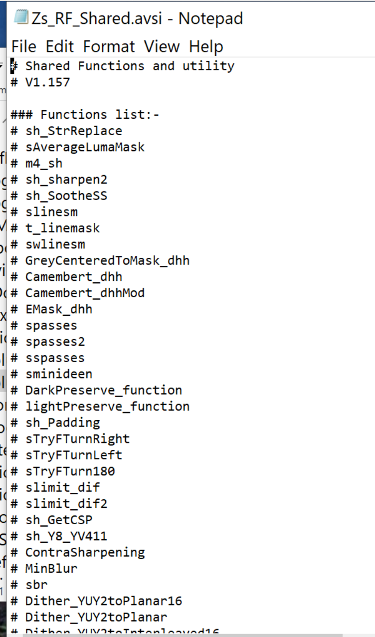

    Also the Zs_RF_Shared.avsi as seen in your first image in post #106 above is over 700KB.
    The real Zs_RF_Shared.avsi is only 100KB. Perhaps you should open that in Notepad also and check it
    Here it is

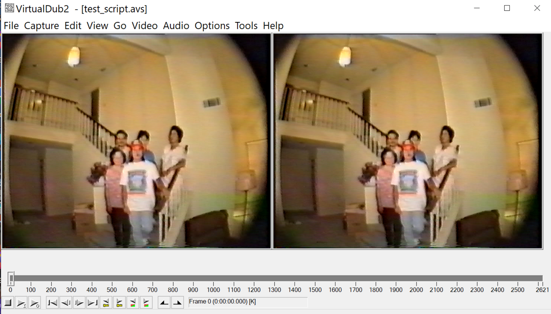

    Create a single line script named test_script.avs
    Mpeg2source("C:\Users\satim\Downloads\may_home_orig.d2v")
    It works

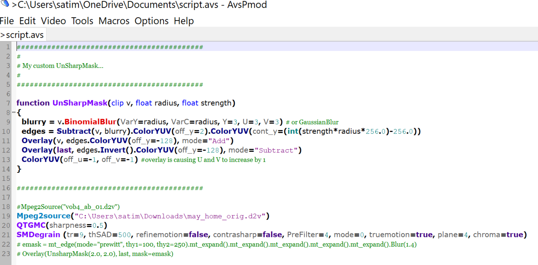

  9. I said same as #121 or #125, i.e. with all #, except the Mpeg2Source line.
    Now remove the # in front of QTGMC and leave the rest with #.
    So remains a simplified script like
    Mpeg2Source("......")
    QTGMC(.....)
    and all the rest is still with # (means ignore)
    This will show whether the QTGMC is working or not.
    If it works you can take the next step and remove the # in front of the SMDegrain(....) and so on. Step by Step, until it fails again.
    Aug 2014
    Hong Kong
    QTGMC(.....)

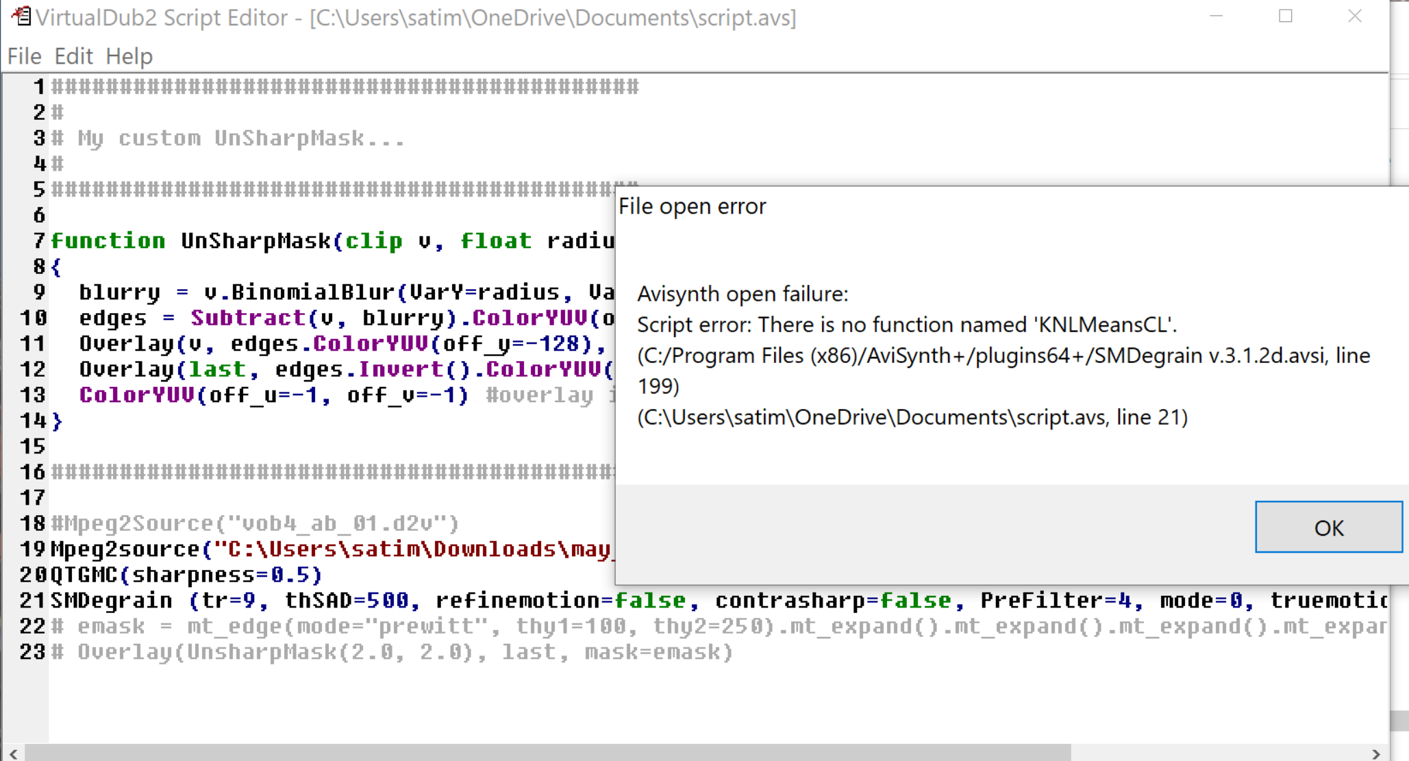

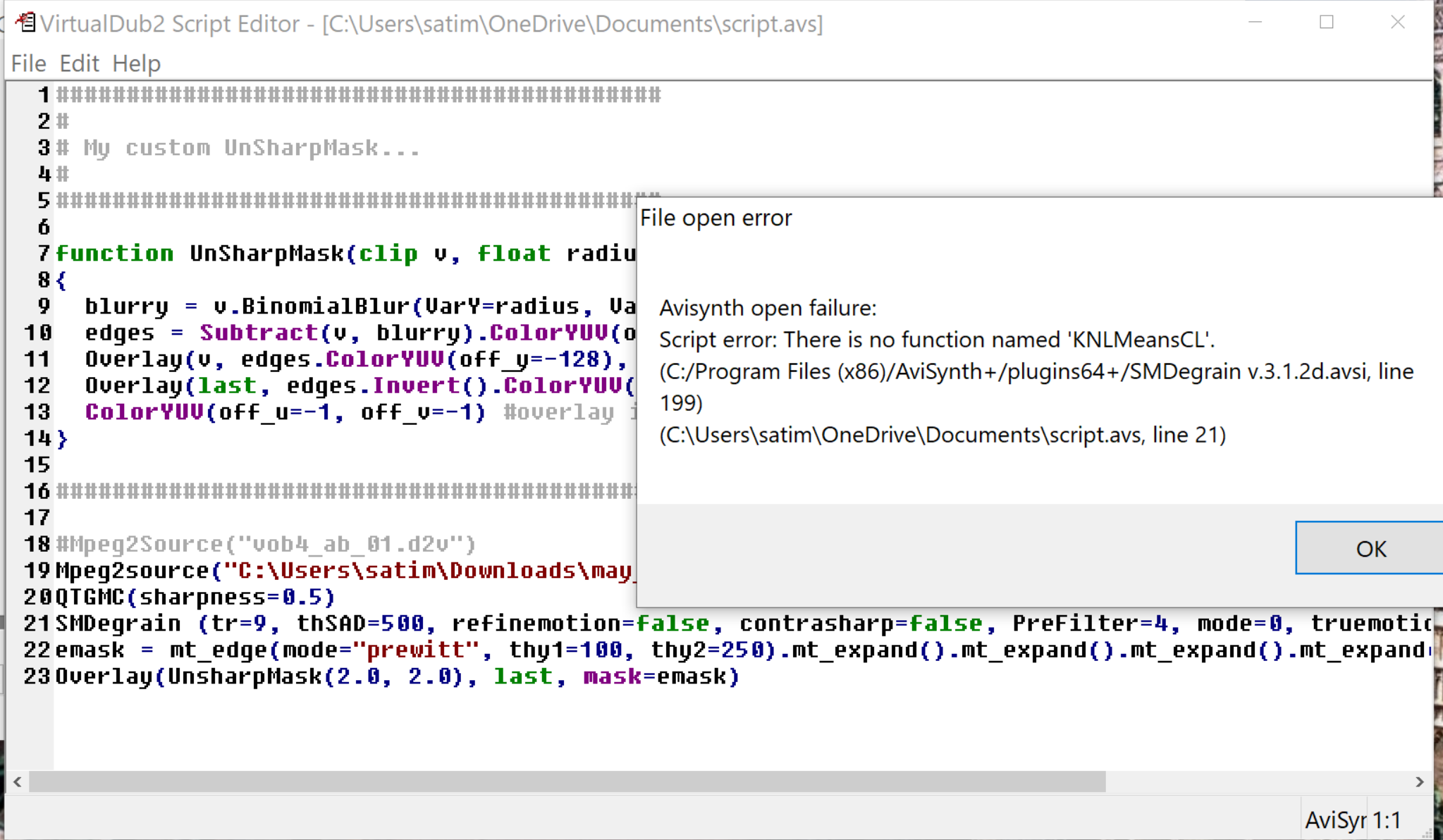

    No complaint
    Uncomment following line, popup complaint
    SMDegrain (tr=9, thSAD=500, refinemotion=false, contrasharp=false, PreFilter=4, mode=0, truemotion=true, plane=4, chroma=true)
  11. Very good. So QTGMC is working now, and the remaining problem is with SMDegrain() and/or KNLMeansCL.
    Maybe somone else can chime in and suggest a working combo of these.
    Edit:
    I still don't see the KNLMeansCL.dll in your plugins64+ folder. See my post #119 where I attached it.

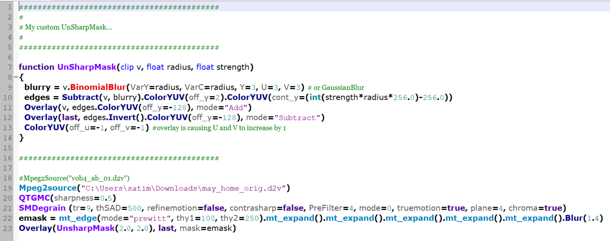

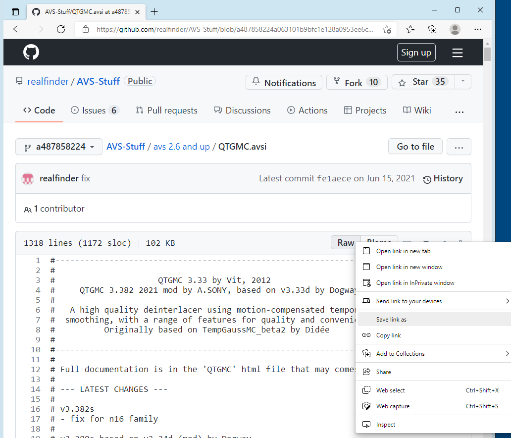

  12. Originally Posted by satimis View Post
    Looks like qtgmc.avsi is bad.
    Open it in Notepad and post the top 30 lines to the thread here
    The real qtgmc.avsi is not 500KB as is seen in your image above
    screenshot attached
    For future reference, saving qtgmc.avsi from github is a little tricky. From the web page pictured right click on the Raw button and select Save As (or Save Link As, depending on what browser you're using) from the context menu.
    [Attachment 63661 - Click to enlarge]
    If you do that from the download link at the avisynth.nl page you will save an HTML page that displays the qtgmc.avsi text, not the actual qtgmc.avsi file. You probably made the same mistatke with Zs_RF_Shared.avsi.

    I don't see KNLMeansCL.dll in the most recent image of your plugins64+ folder. Or in the call to SMDegrain you can use use PreFilter=3 instead of 4 (so it doesn't try to use KNLMeansCL).
  14. Originally Posted by jagabo View Post
    Yes, I attached the KNLMeansCL.dll in post #119. Apparently it did not find its way to the plugins64+ folder, or has been removed .....
    Aug 2014
    Hong Kong
    screenshot attached
    I always download packages in following way;
    For example;
    https://github.com/pinterf/masktools/releases
    Right click
    masktools2_v2.2.30.7z
    -> Save link as
    then save the package to my selected folder.
    Aug 2014
    Hong Kong

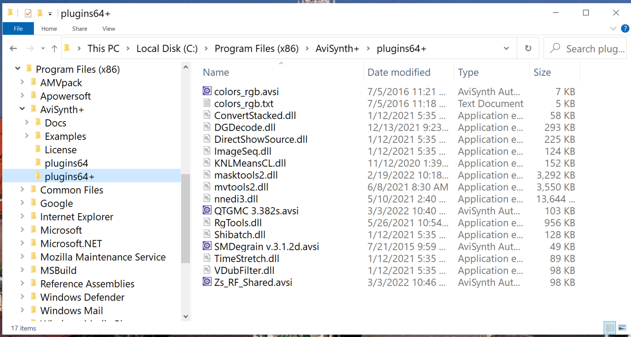

    Pls refers to the attached screenshot

    Also, I think the variableblur.dll is missing in your plugins64+ folder. It is required for BinomialBlur().
    Here it is, just in case:

    Performed following steps:
    1)
    Change;
    PreFilter=4
    To
    PreFilter=3
    2)
    Download -> Extract -> variableblur.zip -> copy variableblur.dll -> Plugin64+
    Now it works without complaint, showing 2 photos, side-by-side
    Remark: PreFilter=4 can't work
    What will be the next steps? Thanks

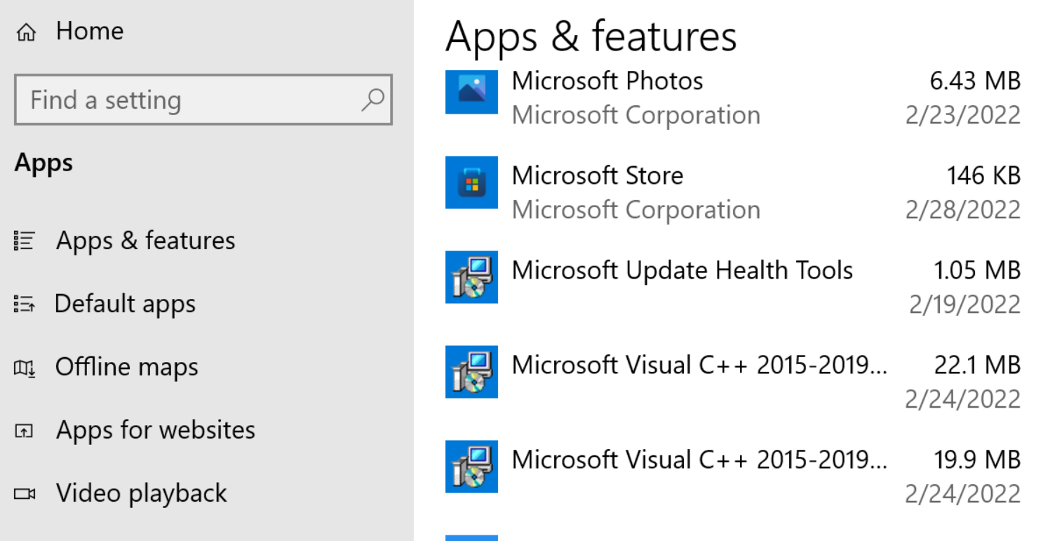

  23. Did you install Microsoft Visual C++ runtime Redistributable Package for Visual Studio 2015, and the AMD APP SDK v2.6 as indicated in the KNLMeans requirements?
    https://github.com/Khanattila/KNLMeansCL/wiki/Requirements
    Those are Windows system libraries, not an AviSynth dlls.
  24. Member
    Aug 2014
    Hong Kong
    Did you install for Visual Studio 2015, and the AMD APP SDK v2.6 as indicated in the KNLMeans requirements?
    CPU info:
    $ inxi -C
    CPU:
      Topology: Quad Core model: AMD Ryzen 5 3400G with Radeon Vega Graphics
      bits: 64 type: MT MCP L2 cache: 2048 KiB
      Speed: 1310 MHz min/max: 1400/3700 MHz Core speeds (MHz): 1: 1379 2: 1400
      3: 1388 4: 1385 5: 1390 6: 1353 7: 1391 8: 1383
    "Microsoft Visual C++ runtime Redistributable Package"
    Pls refers to screenshot re installed packages
  25. As PreFilter=3 is working I would not worry much about KNLMeansCL (PreFilter=4) not working for now. You could tackle this later. It's not critical for your work.

    The path is;
    Mpeg2source("C:\Users\satim\Downloads\may_home_ori g.d2v")
    orig = original
    Before I have trimmed a section on the original video and name the trimmed section as "may_home_orig.vob". I couldn't recall whether later re-named it as "may_home_orig.d2v"
    Anyway I can't trim another new section on the original .vob video testing his script
    And don't overdo with installing and piling up all kind of SW without a purpose.
    I don't think one script (parameter/setting) able to work on the whole .vob video because the video were captured on different scenes. Videos captured outdoor/nature are not bad, quite clear. Only those videos captured indoor are unclear.
    I have trimmed the videos on DVD ripped from VHS tapes into 27 sections, running ffmpeg. The trimmed sections are untouched, same as the original .vob. I'm prepared to do the quality enhancement on the newly cloned Win10 VM.
    Regards
