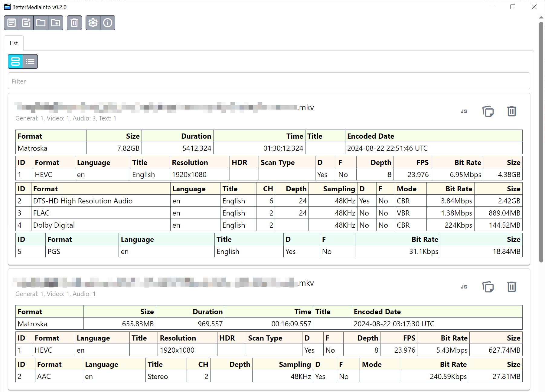

  9. There is a new option BetterMediaInfo. It can show the precise duration by default.
    [Attachment 82191 - Click to enlarge]
