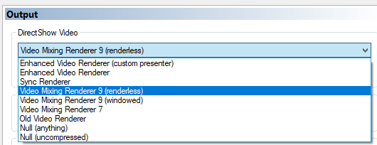

  17. Originally Posted by silverstar2003 View Post
    using the showbiz software I got audio from the sat tv channel but in the tv square just a few coloured lines
    I went ahead and began recording and got a short vid file
    playing it back the tv quality and sound are good so the video signal is there
    I would just like to see the tv as Im recording it ...... ! there must be something wrong in the settings ?
    The fact that your recording was successful indicates you just have a display problem in the capture software. Look through its settings for the graphics output device. It may options for Enhanced Video Renderer (EVR), Video Mixing Render 9, DirectX, Windows GDI, etc. Here's an example from a media player:
    [Attachment 61067 - Click to enlarge]
    Try different settings until you find one that works. You might have to close the program and restart it after each change.

  19. No, he clearly stated at least twice that he has successfully captured audio and video and the playback of the file is fine.

  21. A guy from the firm sent me ...... Direct X Repair zip....... and I used that to make a change in
    windows 10
    the tool helped me disable the.... Direct Draw Acceleration....
    once this was done I now get a tv pic in Showbiz software so I can see what I am
    going to record..... I managed to get a short video file from the sat tv channels
