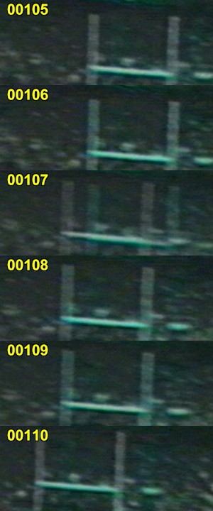

    Here's what I mean by "ignoring blended frames." This image shows a portion of six successive frames during a panning shot:
    [Attachment 61061 - Click to enlarge]
    Frames 105 and 106 show the goal post in the same place. Frame 107 is a blend of two film frames so it should be not be counted as a "different" frame (the film was advanced while the camera was capturing the field so it got a blend of the two film frames). Frames 108 and 109 show the posts in the same place, but they have moved left from frames 105 and 106. In frame 110 they have moved to the left again. So there are 3 unique positions in this 6 frame sequence.
