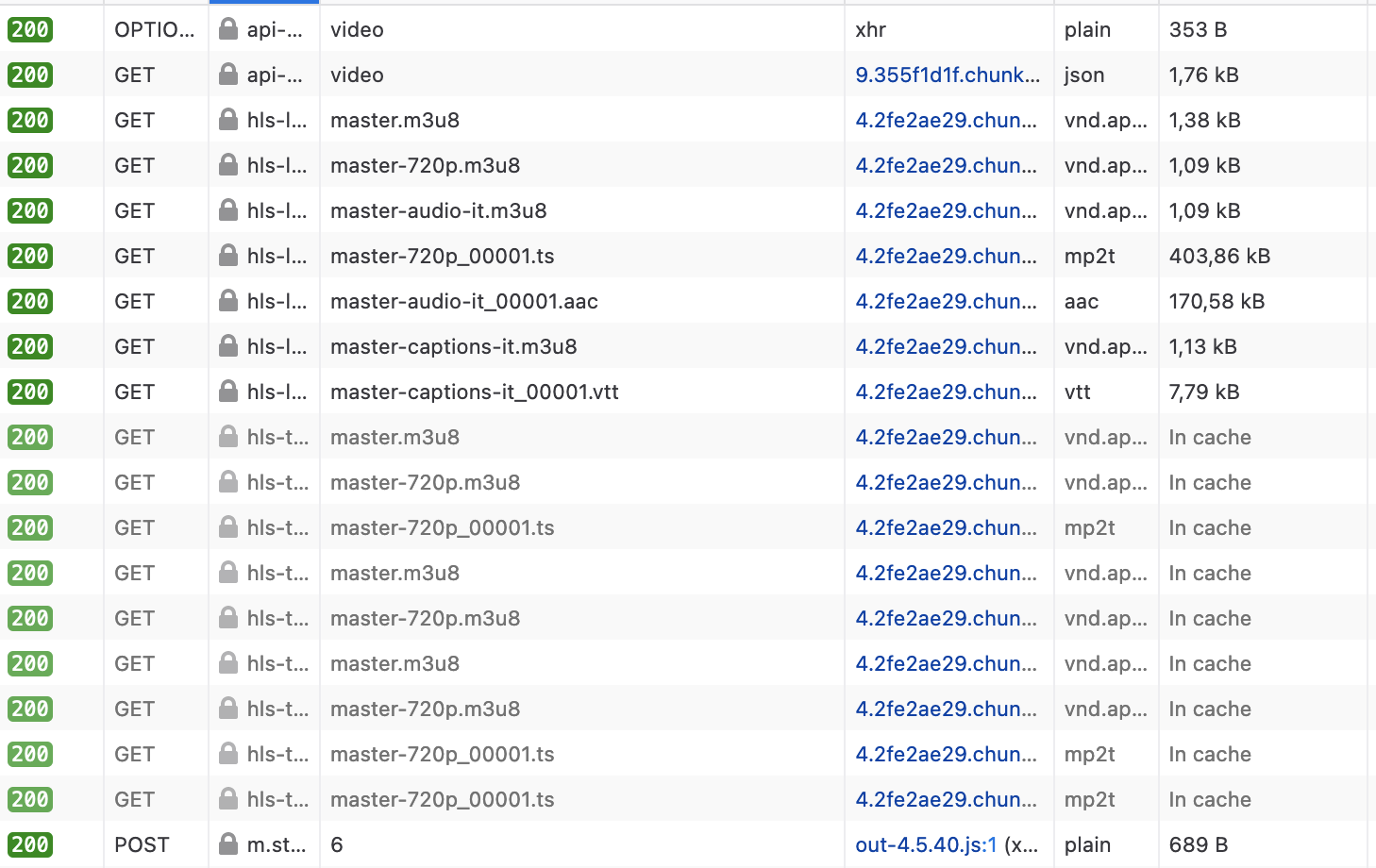

    I'm trying to download a video from a website that has this structure:
    [Attachment 61026 - Click to enlarge]
    The first 2 links don't do anything. Then we have the master.m3u8 file that is the one I am interested in. Then we have smaller resolutions and various audio and subtitles file.

  7. I haven’t tried this one yet but my idea is that the subtitle file is not linked to the master m3u8 video streaming as you can see from the inspector. Should I try to download the .ts stream. If so, how?
