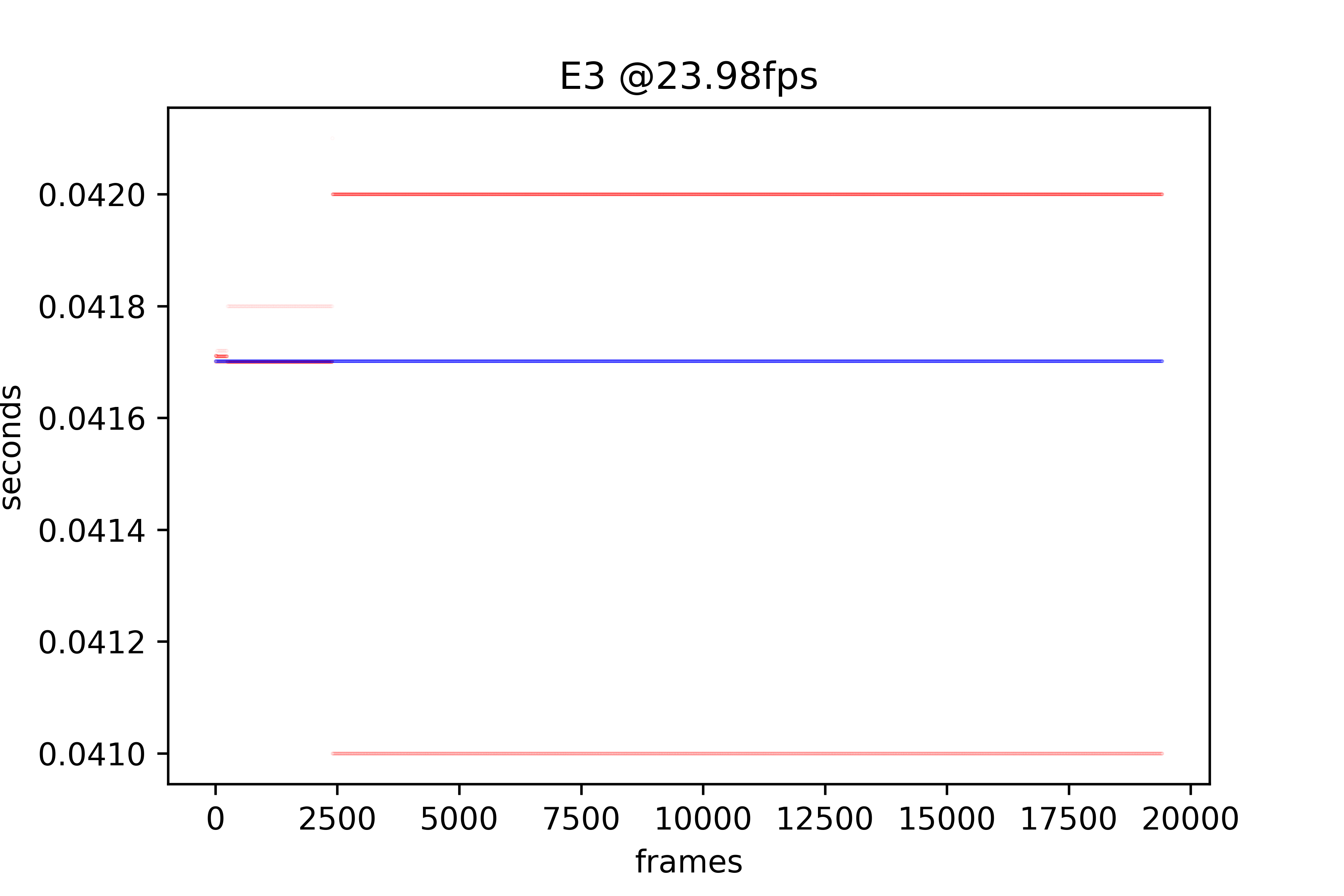

    Trying to clear the confusion, I wrote a program to read the .txt file from ffmpeg's showinfo and get the time for all the frames in the video, and did it for several videos, from different sources and different frame rates, to plot and see the patterns. What I plotted is the duration of frames according to ffmpeg's analysis, taking the time of each frame minus the time of the previous frame. These are the plots for what I found.
    In red, you'll see the duration of each frame according to ffmpeg's analysis. In blue (constant), you'll see the duration of each frame according to 1 / frame rate, which is, for example, 0.041701418 seconds @23.98 fps. The title is just an identifier for the source and series of the video.

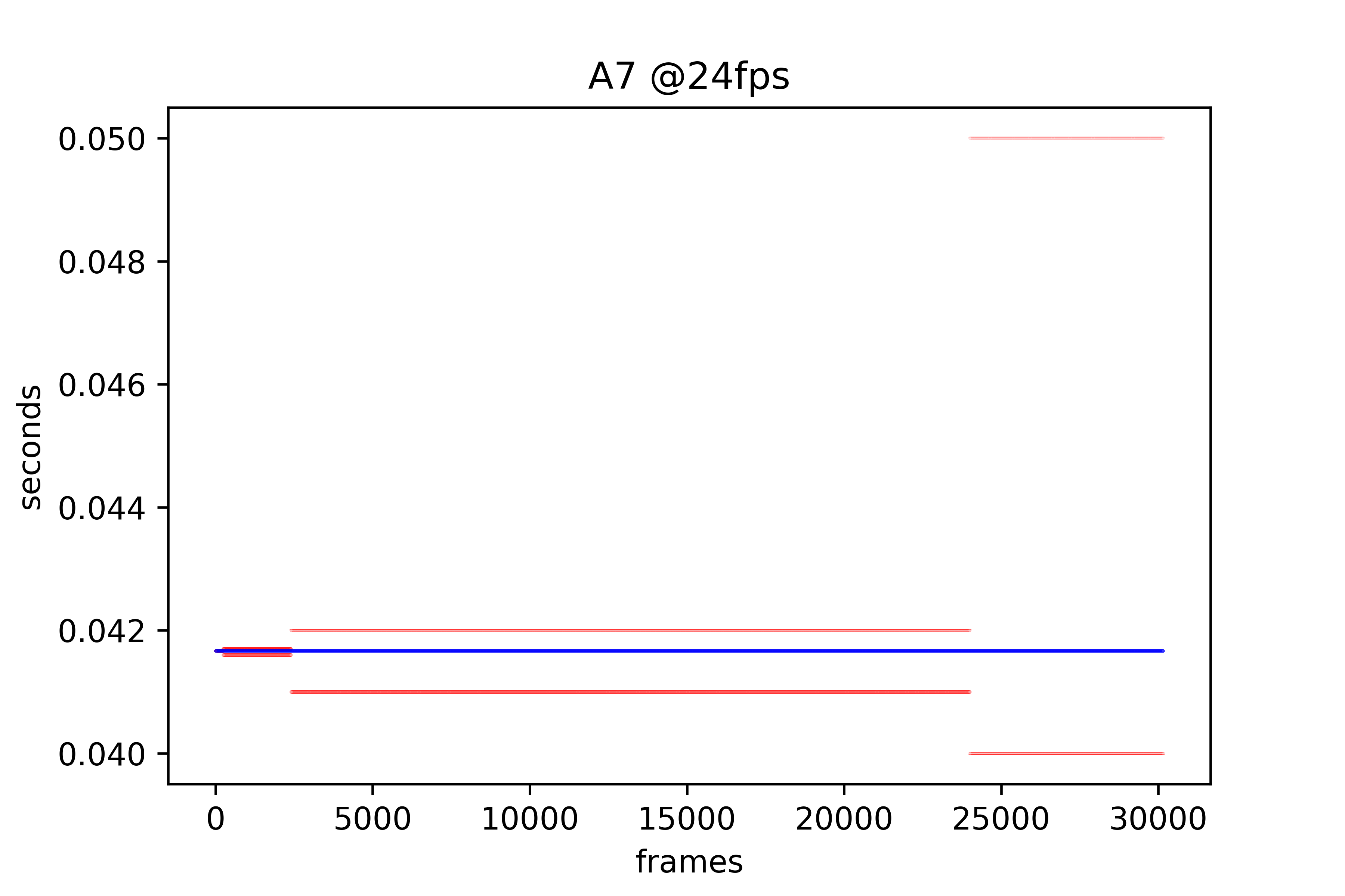

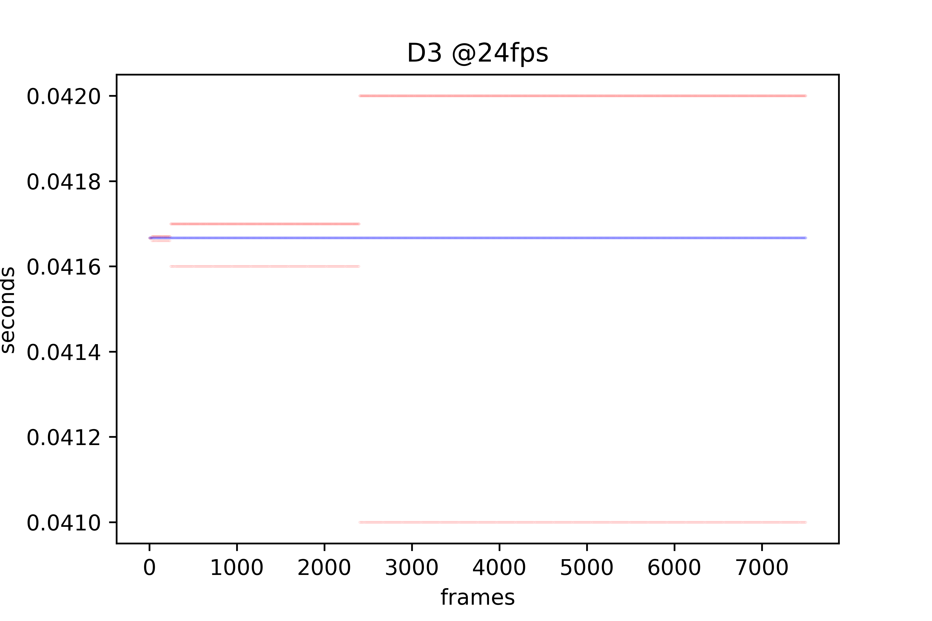

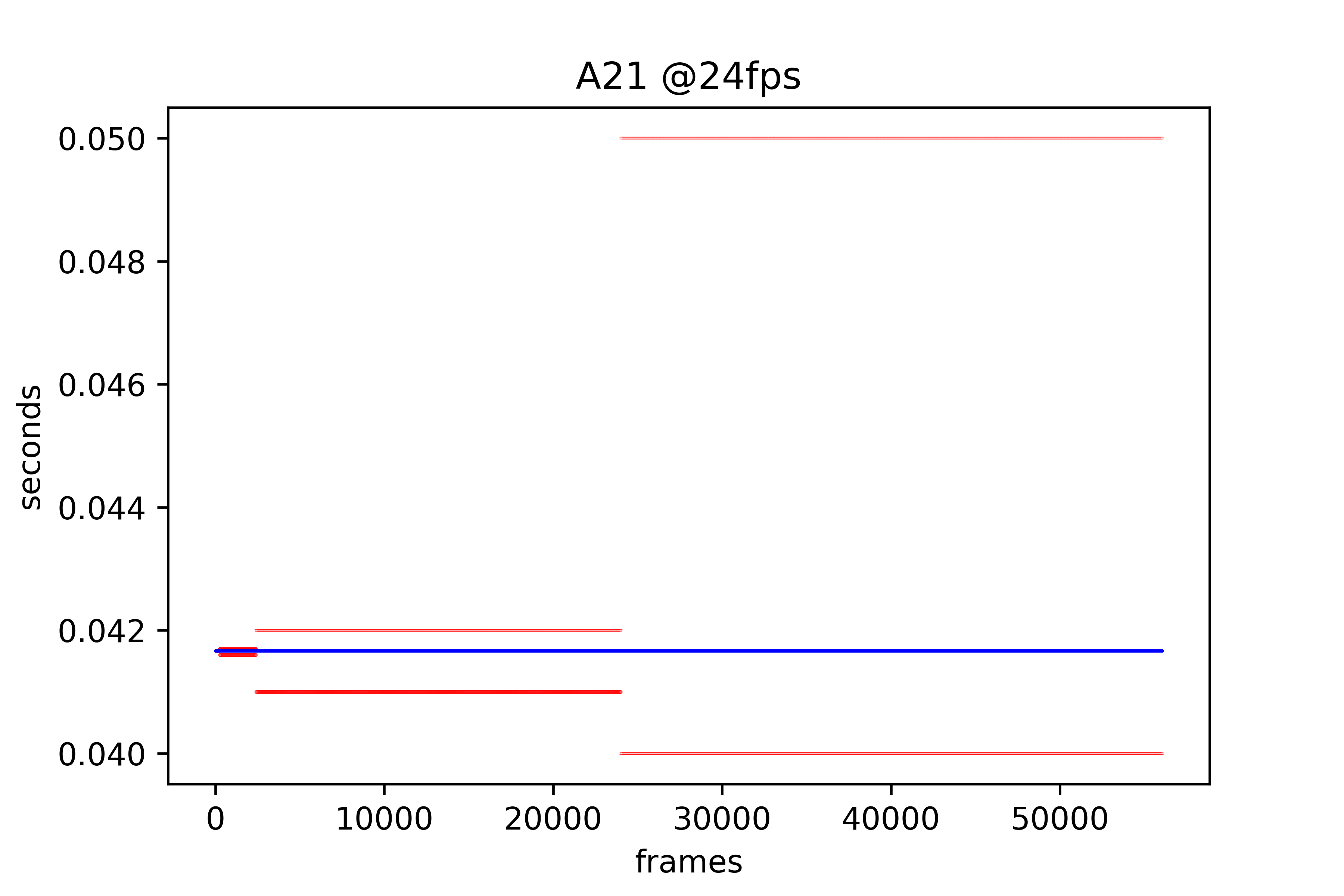

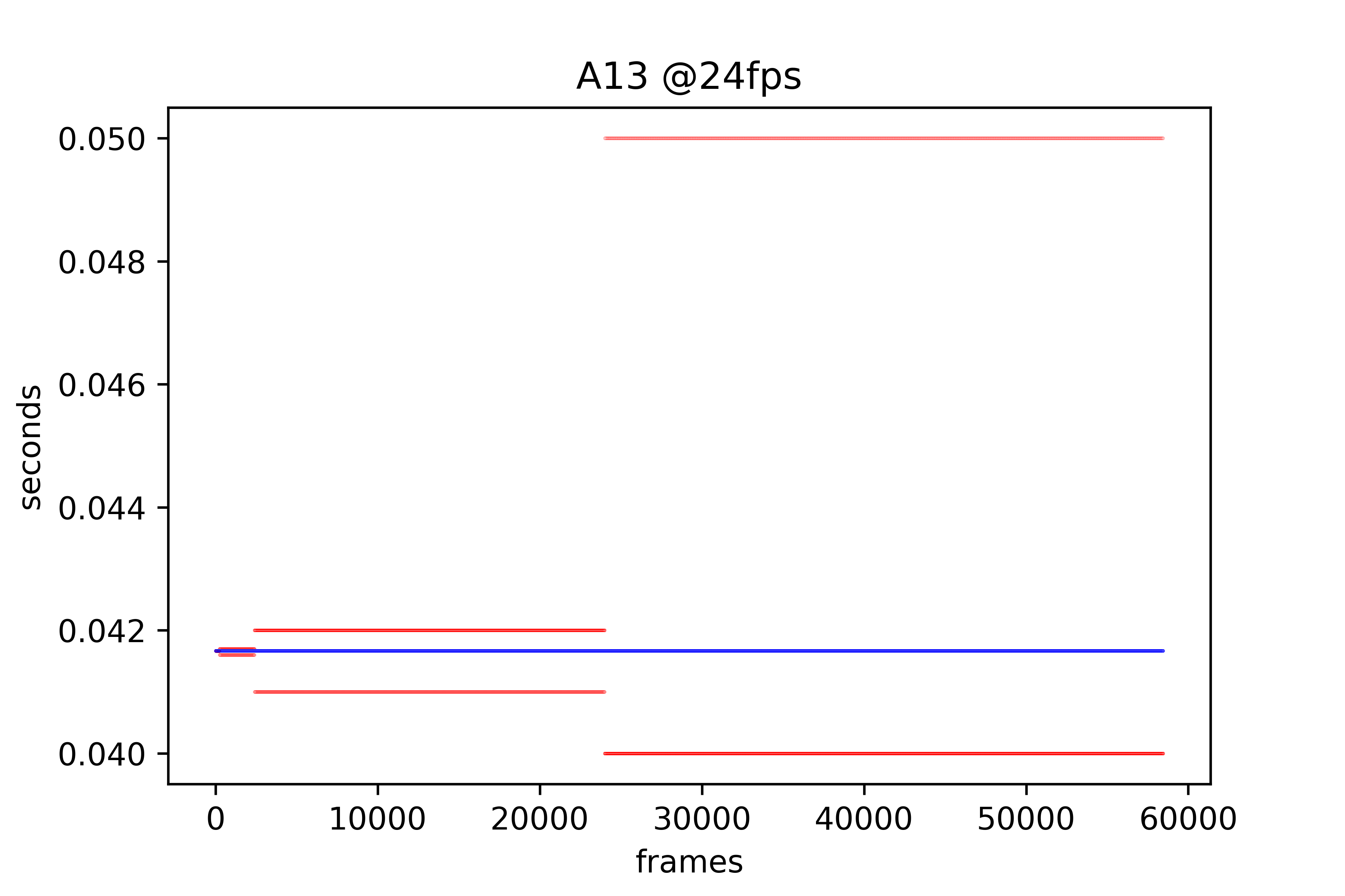

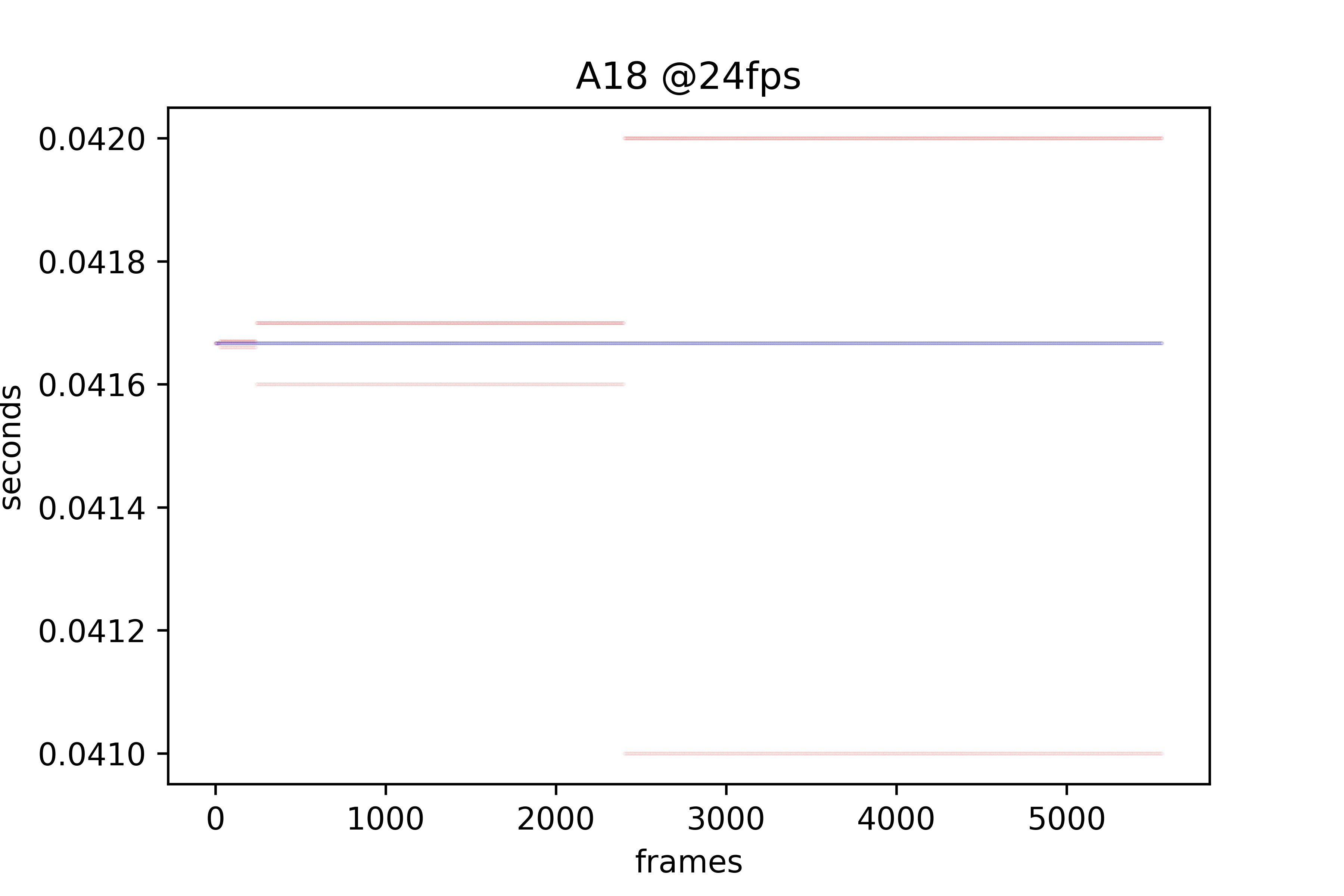

    - Videos @24 fps recorded with a camera from the same series, different durations:
    [Attachment 60965 - Click to enlarge]
    [Attachment 60966 - Click to enlarge]
    [Attachment 60967 - Click to enlarge]
    [Attachment 60968 - Click to enlarge]
    As you can see here, there is a pattern in all videos. The duration of frames always oscillates, but with a different amplitude in different ranges. In the first 300 frames (more or less), the oscillations are very close to the value of 1/24 = 0.041666666666 seconds, but then start to oscillate further away from it. Then, in all videos except for the shortest one, the oscillations get even bigger at around 24000 frames. In the shortest one, this happens at around 2400 frames, but the values are a bit smaller. When I get the average of all these durations in red, the value is always the same as in the blue line, which I calculated with 1/24 = 0.041666666666. Maybe this also happens in the longest videos too, but it's not easy to see in the plot.

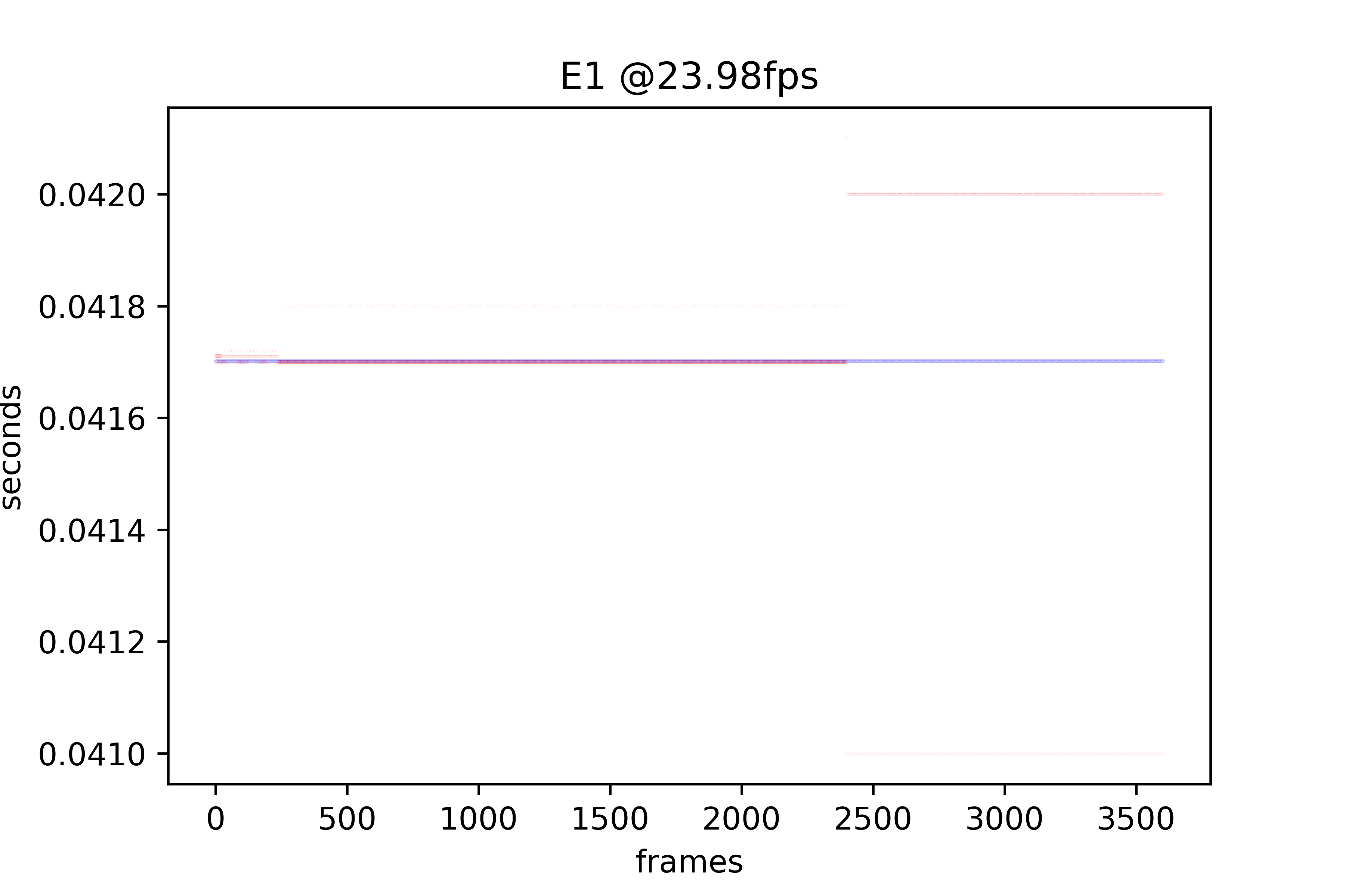

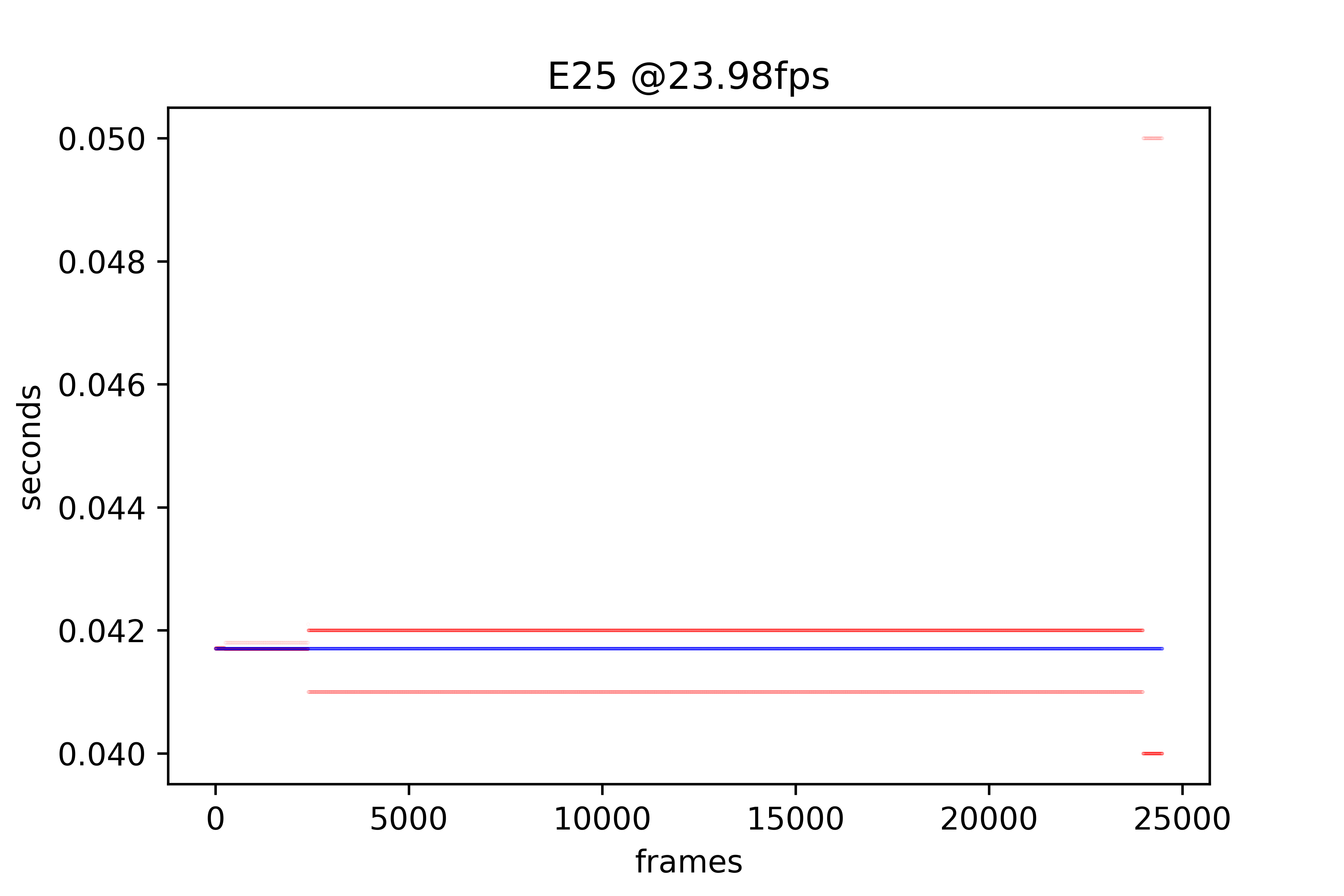

    - Videos @23.98 fps from a camera, same series:
    [Attachment 60970 - Click to enlarge]
    *There is a line that's very, very clear here in the second oscillation segment. This is because the values there were very few.
    [Attachment 60971 - Click to enlarge]
    [Attachment 60972 - Click to enlarge]
    A similar pattern, but not quite the same. Changes around 300 frames and 2400 frames, and also around 24000 frames for the longest video.

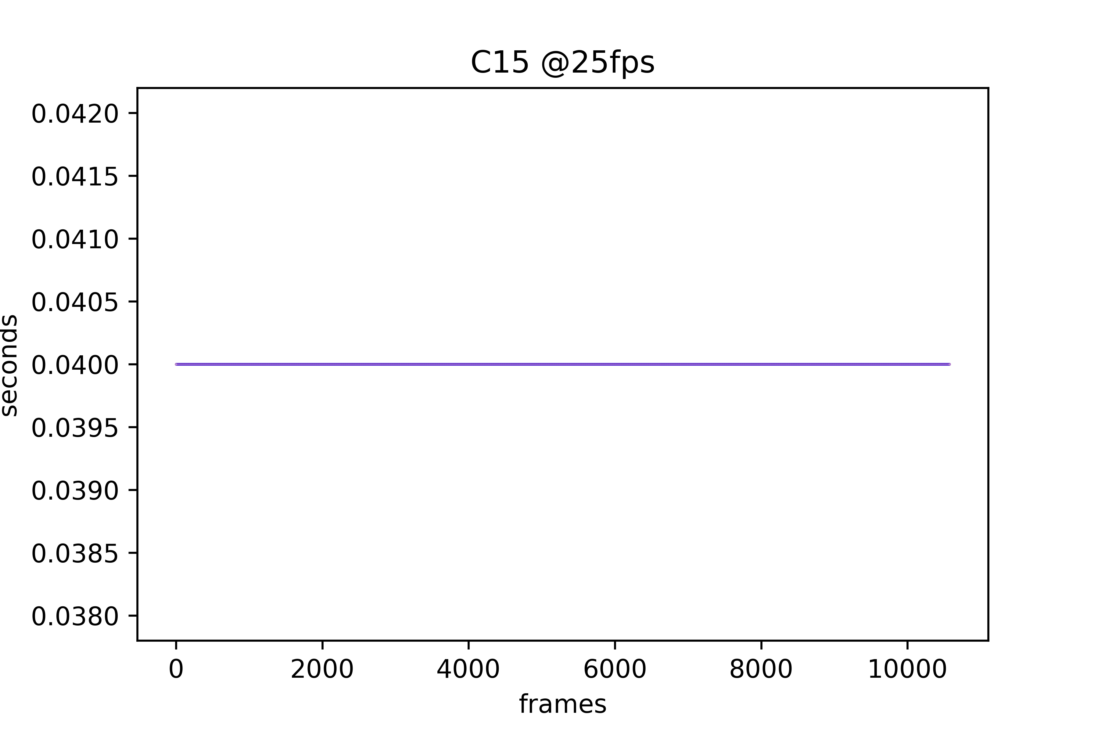

    - Video @25fps, screen recording:
    [Attachment 60973 - Click to enlarge]
    Here the durations are identical to my calculations.

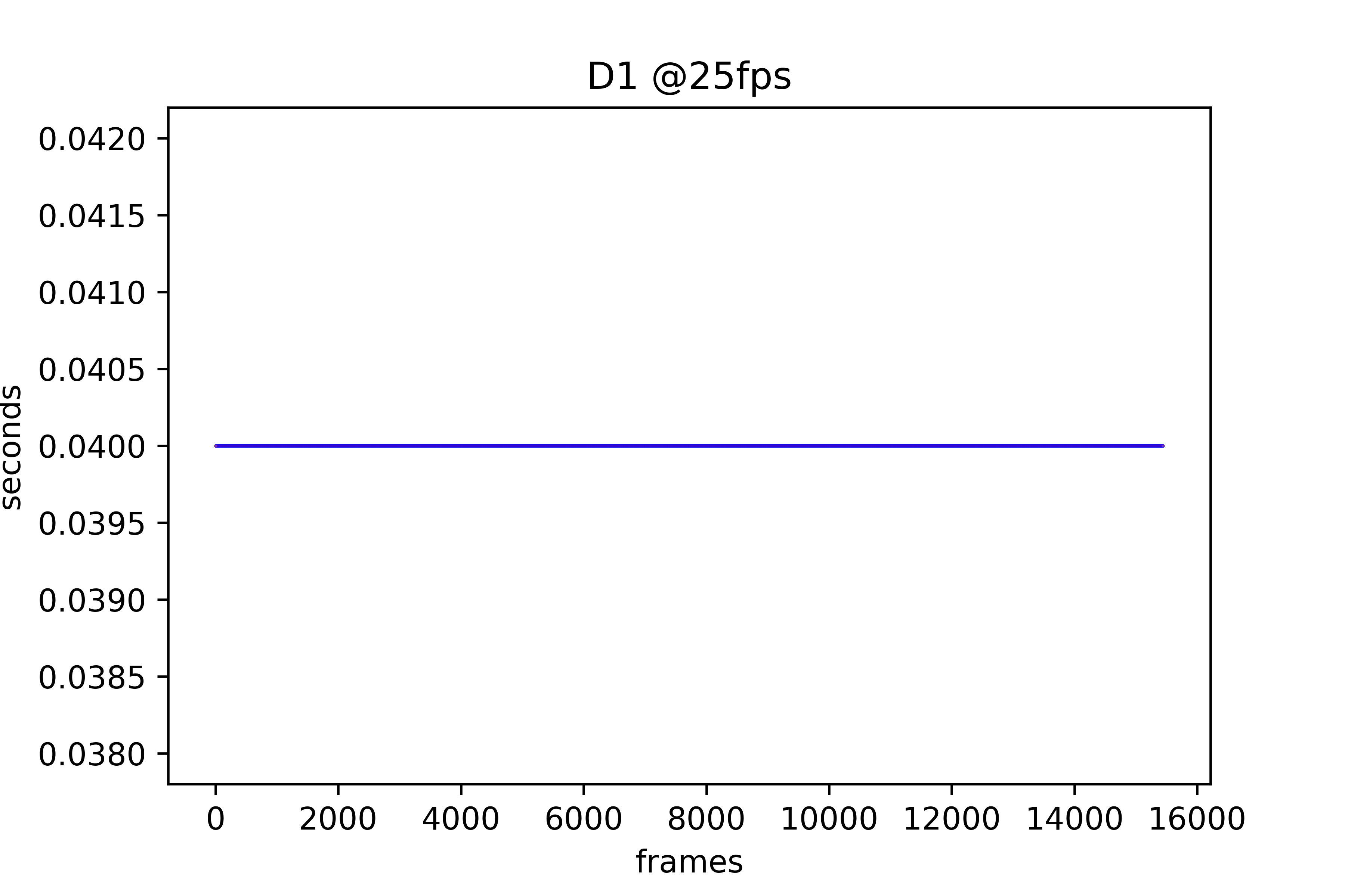

    - Videos @25fps, animation:
    [Attachment 60974 - Click to enlarge]
    [Attachment 60975 - Click to enlarge]
    Durations are identical, even though the sources are different. There is no problem with 25fps.

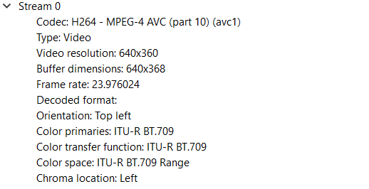

    For the video that corresponds to the plot I identified as E3 @23.98fps, I get this in VLC
    [Attachment 60976 - Click to enlarge]

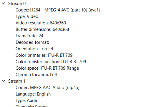

    For the one that corresponds to the plot I identified as A121 @24fps, I get this:
    [Attachment 60977 - Click to enlarge]
    I also get the same frame rates from Windows's file properties and from ffmpeg. Could they be showing 24 but it's wrong and actually it's 23.98? I could do another check using OpenCV, but that would take more time.

  13. Also, mp4 usually uses a time base of 1/90000 seconds as recommended in the spec. NTSC frame times can't be represented exactly by N/90000 where N is an integer. So the muxer alternates between two values. For example, 90000 / (24000 / 1001) = 3753.75. So you get a pattern of three frames at 3754/90000 and one frame at 3753/90000, which averages out to 3753.75/90000 over time.
    My guess is that some of your videos had portions which originally had a lower time base which was multiplied by a constant when muxed with 90000 time base, hence the larger oscillations.
