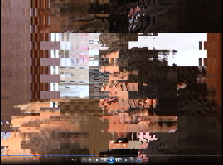

I cannot capture Mini-DV in PAL format.
I was capturing in NTSC without problem with my sony DCR-HC52 camera via Firewire cable and Adobe Premiere Pro 2021 software.
But some tapes are half recorded in NTSC and half in PAL.
1-The PAL format is perfectly reproduced on the camera.
2-In Premiere there is no trace of any PAL signal.
3-In SCLIVE if it recognizes the PAL signal but the result is faulty (attached image of the PAL result in SCLIVE), places the following message "the capture drive incorrectly sends PAL video in NTSC frames or vice-versa. Ou might want to update directx."
[Attachment 60868 - Click to enlarge]
How can I capture PAL DV?

S-live is the right tool, NLE software may work but not a dedicated transfer software like S-live and WinDV.
The problem could be that when you switch from NTSC to PAL you may have to restart the program and disconnect and reconnect the firewire cable for the system to establish the right format, You can't just capture PAL and NTSC in a single file, they have different frame rates, different resolutions and chroma subsampling. -
I did exactly what you propose, but the same thing keeps happening. Try rebooting the whole system but it doesn't work anyway.
Some camcorders do playback PAL in the viewfinder but PAL stream via firewire is disabled by firmware, In that case you would need a PAL camcorder. Check the manual of your camcorder.
I just read in the manual that the camera is native NTSC and that it can play PAL but it will appear with a sign on the screen that says PAL (as is my case). It does not clarify more about it but I suppose it must be then a firmware compatibility problem, I will have to get another camera but native PAL.

Try this.
Run the tape to the point where PAL should start. Leave SC-Live off
Start the tape for PAL playback and then turn on SC-Live. Clear picture now ?
If so, rewind tape back to start of PAL playback and transfer with SC-Live. -

This works! Well, I can continue with the captures. Thank you!Try this.
