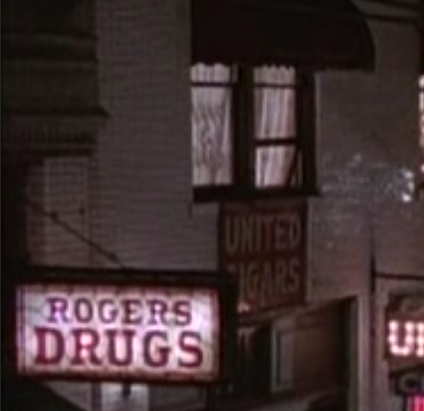

  3. Originally Posted by davexnet View Post
    Inverse telecine followed by levels, or something to deepen the shadows
    Thanks! That does look better, but still has some of the issues I'd been getting. Example - the detailing on the white buildings: Image
    [Attachment 60911 - Click to enlarge]

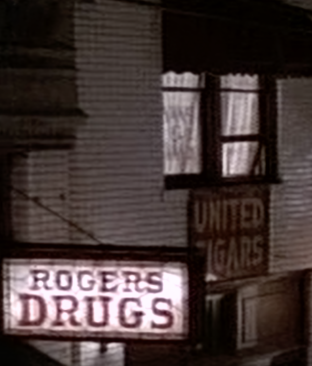

    I've had a breakthrough since posting this - so I've managed to improve it some - (this is after playing with the levels on your suggestion:Image
    [Attachment 60912 - Click to enlarge]
    Happier with the results, but I still feel like I could be doing a better job.
