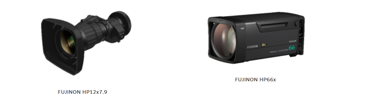

    https://www.fujifilm.com/us/en/news/optical-devices/fujifilm-announces-development-of-...adcast-lenses#
    The difference between small objective for mobil so-called CINEMA cameras, VS. 5-6X more expensive bigger TV camera lenses (25kg).
    [Attachment 60842 - Click to enlarge]
    How can you explain the very high price of TV Cameras (starts 250 000 $) over the cinema cameras which are more cheaper even in high end category. (They are not even the same price category)

    That video, and your graphic, just re-iterated exactly what I told you.
    I think you are also refering to (other) sources that are antiquated, particularly in the weight expectations. And - like I already said - the TV camera itself is fairly small (there is a range). It is all the accessories that can make it larger/heavier. If you need an ENG camera, you can bet that it will only be 2-20kg, because that is necessary for the job (MOBILITY). Studio cameras are different than field cams. Sports cams are different than news cams. NOT necessarily the camera, but the SYSTEM.
    I already explained the need for expensive lenses in SPORTS cameras (wide, fluid, stabilized zoom range). Did you not even read my response?
