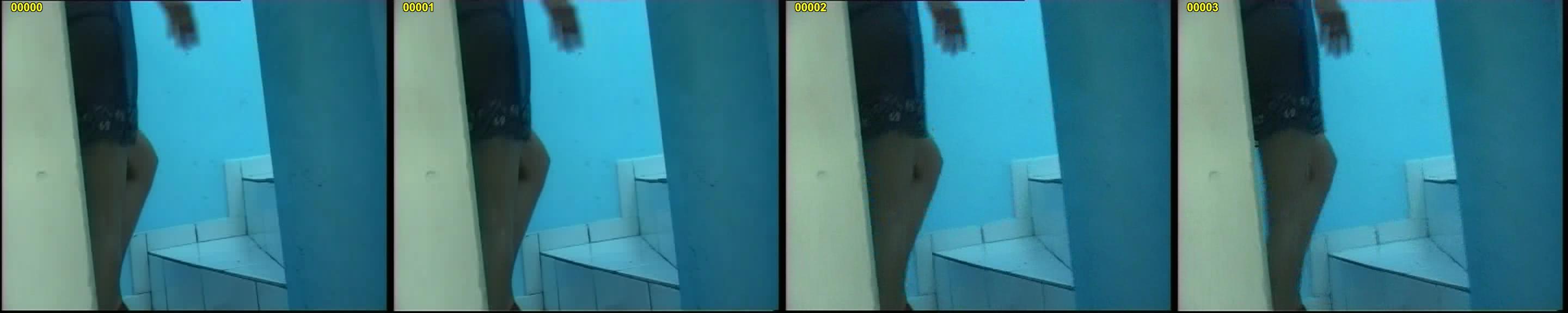

  1. Hello. As usual, the first thing I did was to call separatefields() but I'm not sure what to make of the result. Even with assumetff()/assumebff() there's a 'picture wobble' I've not encountered before. Anyone willing to have a look and tell me how to handle it has my thanks.
  2. What do you mean by picture wobble? I see some jerky camerawork but otherwise it's normal interlaced tff video.
    Mpeg2Source("sample.d2v")
    QTGMC(preset="fast")
  3. Hi and thanks, jagabo. I can't explain my 'wobble' in words so here's a pic of 4 consecutive frames with separatefields() called. See how the wall is more or less straight in the first two frames yet appears bent one way then the other in frames 3 and 4...
  4. Those are just compression artifacts. SMDegrain() might be able to reduce that.
  5. OK, thanks.

  7. I thought he was talking about the yellowish wall just behind the woman's knee. But I don't see those artifacts when I use SeparateFields() and step through the video. I think he has some temporal filtering issue.
    AssumeTFF()
    Bob(0.0, 1.0)
    ShowFrameNumber(x=20, y=20)
    StackHorizontal(last, last.Trim(1,0), last.Trim(2,0), last.Trim(4,0))
    [Attachment 60855 - Click to enlarge]
  8. Yes, it was the blue wall on the right I meant. There's an obvious bend (one way then the other) in the last two frames (post #3) which aren't in jagabo's attachment. I've just loaded the script again with separatefields and the bend has gone this time! Very weird...

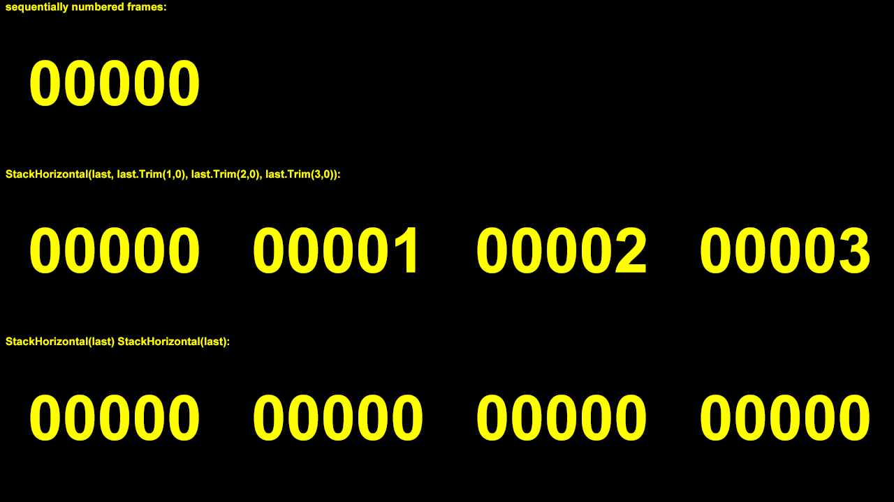

  16. Noted, thanks. What would you say to my StackHorizontal observation?
  17. Originally Posted by pooksahib View Post
    It's wrong.
    StackHorizontal(last, last.Trim(1,0), last.Trim(2,0), last.Trim(3,0)) stacks four consecutive frames side by side.
    StackHorizontal(last) stacks the same frame side by side.
    BlankClip(width=320, height=240)
    AssumeTFF()
    ShowFrameNumber(x=40, y=150, size=100)
    v0 = Addborders(0,0,960,0).Subtitle("sequentially numbered frames:")
    v1 = StackHorizontal(last, last.Trim(1,0), last.Trim(2,0), last.Trim(3,0)).Subtitle("StackHorizontal(last, last.Trim(1,0), last.Trim(2,0), last.Trim(3,0)):")
    v2 = Subtitle(last, "StackHorizontal(last) StackHorizontal(last):")
    StackVertical(v0, v1, v2)
    [Attachment 60918 - Click to enlarge]
    Oops, I noticed that the last Trim() in post #7 was Trim(4,0) -- it was supposed to be Trim(3,0).
