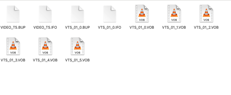

I'm using "Subtitle Edit" to create an srt for use with a movie in a VIDEO_TS folder on a mounted iso (Codec Details attached). I aim to share it with the community when I'm done. I'm having trouble syncing.
The problem:
From Subtitle Edit I click Video>Open Video File and select VTS_01_1.VOB
[Attachment 60817 - Click to enlarge]
I make some subtitles, timed perfectly if played from the beginning and if tested in VLC.
However, if I click on a line within Subtitle Edit, the sync is way off, and unpredictably so, making it impossible to work.
What am I doing wrong?

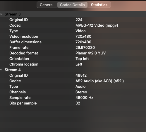

I also had (different) trouble trying with Aegisub. I'm guessing that they don't like VOB files and that I should use Handbrake to convert them to something. If that's right, what settings should I use for the conversion to something quick and disposable but accurate? MPEG2? MPEG4? 29.970030 fps? I'd like an efficient way that ensures a good sync between the final srt and the VOBs.
Thanks!
[Attachment 60816 - Click to enlarge]

As for the sync problem, instead of opening VOBs directly in SE, try File --> Import --> Subtitle from VOB/IFO (DVD) and browse to the proper IFO file. Timings can be more accurate.
I'm extremely confused.
I tried this. SE attempted to rip subtitles from the NTSC VOBs. As I said, there are no subtitles on the VOBs. The subtitles are not in the VIDEO_TS file. They are a deeply flawed srt file I downloaded from Subscene and am trying to overhaul.
I also used PgcDemux. The result was splitting the video into its audio and video tracks (ac3 and m2v). I tried using this with SE, but it played video without audio, so that wasn't helpful. I used PgcDemux to create a single VOB. It didn't help the problem.
What's more confusing is that the timecode when I play the video in VLC is completely different than the timecode in SE. It's off by about 30 seconds, audio and video. That goes for playing the VIDEO_TS folder or the PgcDemuxed mega-VOB.
Editing in SE is impossible because the timecodes keep drifting around. It's maddening.Last edited by Lostdog; 23rd Sep 2021 at 21:31.
I can imagine. I totally didn't read your initial post well enough. Please accept my apologies.
As I understand you want to create a srt for the whole movie, I'd suggest you work with one file that is created out of the VOBs that contain it. Such as a mkv. MKVToolnix can do that for you. No re-encoding needed, just a remux of VOBs into one mkv.
Looking at your source, you need to import the "VTS_01_0.VOB". MKVToolnix will then auto-load and append the proper VOBs into the source window.
Your dvd containing a movie, chances are that the frames are stored as 23.976 progressive. In which case, you have to set "Default duration/FPS" to 24000/1001p (this could be a reason why you're having sync issues, btw). Now you'll have one file to work with in SE.
If you're having trouble with MKVToolnix, please let know. -
Thanks! I'll do as you say. This video I'm working with is a bit unusual. According to "codec details" in VLC (see screenshot in OP), the framerate is 29.970030 fps (NTSC, I believe). How does that impact my MKVToolnix settings?
EDIT: Actually, all the "Properties" in the "Input" tab of MKVToolNix are greyed out (including "Default duration/FPS"). I'm just going to "start multiplexing" and keep my fingers crossed...Last edited by Lostdog; 26th Sep 2021 at 19:52.
I think I may have gotten some insight:
I loaded "VTS_01_0.VOB" into MKVNix and it spit out the mkv. When played, the mkv starts with the dvd menu for ~34 seconds before launching into the feature. That may have contributed to the timing problem?Last edited by Lostdog; 26th Sep 2021 at 21:45.
Yes, I tried again with "VTS_01_1.VOB". I didn't change any settings in MKVNix. The result was an MKV which had the whole movie. I opened it with SE, ran a few tests, and everything seems to be working perfectly. No more weird timing issues!
As far as I can tell from VLC, the framerate seems to be (see screenshot in OP) 29.970030 fps (NTSC, I believe).
Thanks for the help!
SOLVED. -
All NTSC DVDs output 29.97fps (really 59.94 fields per second). But the content might have a different framerate and be padded to output 29.97fps.
You should read up on 3:2 pulldown and telecine. Unless you're going to keep it as a DVD, maybe. -
What I did was play the Video_TS in the iso with VLC, clicked "Play" in the dvd menu, and then opened Tools/Media Information after it was already playing. The result is the screenshot. Am I making the wrong assumption?
Right now, I'm happy with the MKV spit out by MKVToolNix (which plays nicely with with my HTPC Kodi setup), unless there's a good reason to do more research into some sort of Handbrake conversion (IVTC) you suggested. I don't know why I'd want to do that.Last edited by Lostdog; 30th Sep 2021 at 19:25.
