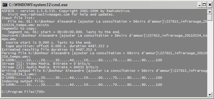

  2. Maybe asfbin with -nostr for the unwanted streams numbers.
    http://www.radioactivepages.com/asfbindetails.aspx
    Should be batchable with commandline version

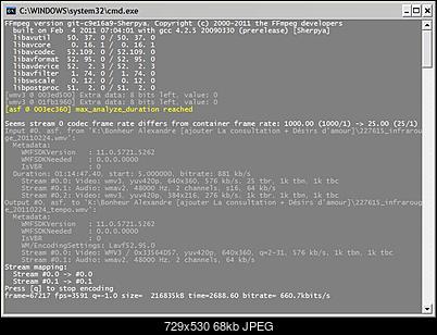

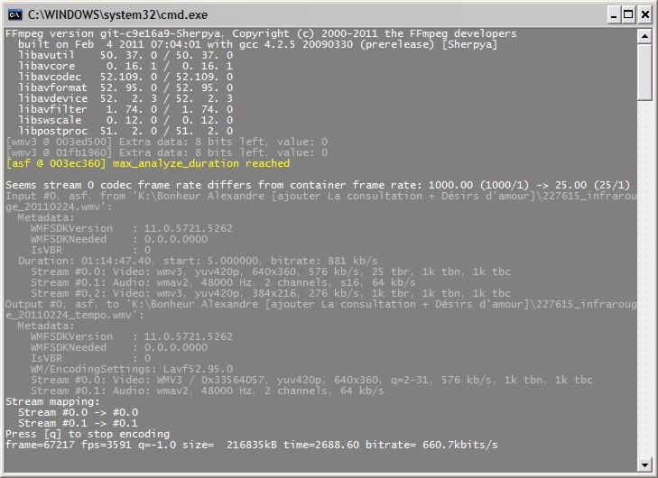

  3. If I remember correctly, asfbin was the tool used by an all-in-one TV replay recording software I was using at the time, called TVO (now defunct), to process (“index”) WMV files after download (below are two screenshots I took on 2011/08/19 — that's almost archeology at this point !), and the resulting files exhibited the kind of issues I mentioned above, with common media players in their contemporary versions. For instance I noted in the name of one such file processed by TVO (running ffmpeg then asfbin under-the-hood) : “after TVO processing, stuttering sound in VLC, desynchronized in MPC”, problems that didn't affect files processed with Windows Media Stream Editor. If I play that same file now with VLC Media Player 3.0.16, I don't hear any audio stuttering, but about 1s is missing at the beginning with the picture appearing garbled for about 5s (if I go back to 00:00 with the left arrow key then it plays normally, i.e. not garbled, but a small bit is still missing) ; if I play it in MPC-HC 1.7.8.162 (which is not exactly up-to-date), there's a slight delay (video slightly lagging behind audio), but the same happens with the file processed with WMSE, and the beginning is fine with both files. So I'm not sure if such defects are caused by an improper processing or by intrinsic playback issues with the media player. I have yet to test with a recent version of asfbin.
    Automatic “indexing” processing of WMV files by TVO in 2011 (first step with ffmpeg, second step with asfbin) :
Name:	TVO - indexation WMV phase 1 (FFMPEG).jpg
Name:	TVO - indexation WMV phase 2 (ASFBin).jpg
