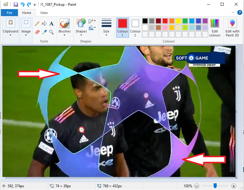

    Hello:
    Let me know if I understand correctly.
    I think you want to select a rectangle from each areas indicated by the red arrow, since those two areas use solid color to cover the background objects. Therefore, if the similar transit scenes appear, then the selected rectangles will remain the same, and thus could have the same Average V values, right?
    However, I have something don’t quite understand is the coordinates.
    For this image: in my image collection, it is named: I1_1087.PNG.
    It has weight of 768 pixel, and height of 432 pixel.
    Inside the upper red arrow, the arrow header’s coordinates inside MS-Paint is: (191, 91); and inside the lower red arrow, the arrow header’s coordinates in MS-Paint is: (592, 374).
    So, I don’t know which coordinates you are using in Python code.
    You can see my picture:
    [Attachment 60877 - Click to enlarge]
    Please let me know how to find the rectangle’s coordinates in your code? Do you open the image with MS-paint or other software?
    Thanks,

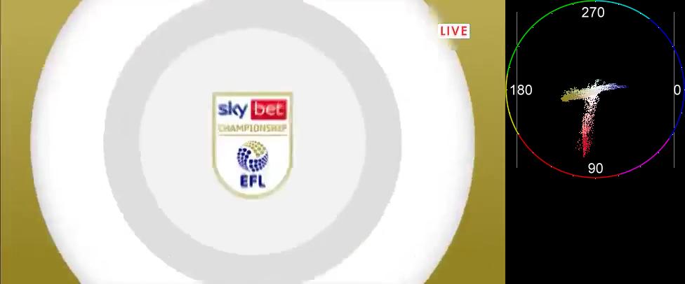

    Originally Posted by _Al_ View Post
    This seams more accurate for that transparent transition.
    The least transparent areas were selected, blue and purple gradients , but U and V values are verified at the same time. So you can use very wide range -10 and +10 for thresholds and it still finds all off it and only those parts.
    More conditions the better (in this case 4) means higher tolerances for values is allowed.

    for transitI1.mp4 (there are actually three transitions in transitI1.mp4)
    12
    1087
    1847
    and transitI2.mp4:
    1233
    2513

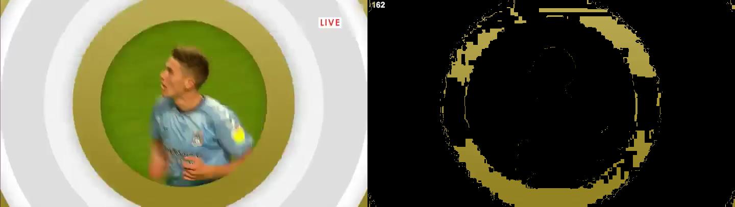

    I try that jagabo's idea, to check for HUE instead. To explain it, we try to check on correct color and we do it now checking chroma U and V. Instead jagabo tries only a color in HSV color space. HSV color space is defined by color, saturation and value. It might be even faster, not sure. I do not know what is faster , to chane RGB to YUV or HSV.

  13. This is jagabo's method in opencv, using masks with Hue and saturation, but changed a bit. If there is half points in range for a rectangle, it qualifies:
    def process_img(img_rgb, frame_number):
        r1 = cv2.cvtColor(img_rgb[y1:y2,x1:x2], cv2.COLOR_BGR2HSV)
        lower = np.array([92,125,0])  #hue from 92 to 98, saturation from 125 to 150, any value
        upper = np.array([98,150,255])
        mask1 = cv2.inRange(r1, lower, upper)
        if np.average(mask1) > 128:
            r2 = cv2.cvtColor(img_rgb[Y1:Y2,X1:X2], cv2.COLOR_BGR2HSV)
            lower = np.array([134,130,0])
            upper = np.array([152,150,255])
            mask2 = cv2.inRange(r2, lower, upper)
            if np.average(mask2) > 128:
                 print(frame_number)
    surprisingly, speed is fine, looks the same, and code is easier to read

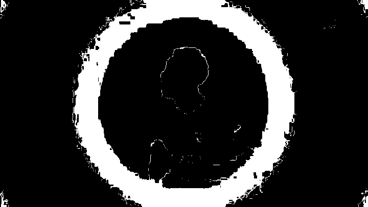

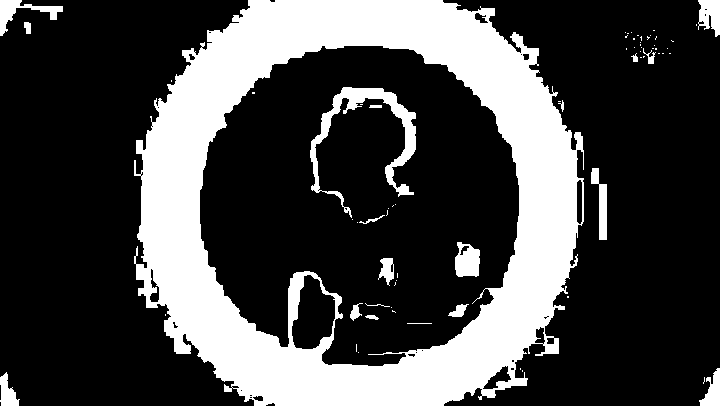

  15. Originally Posted by _Al_ View Post
    U,V vs. H,S... But speed is about the same as it seams.
    Given that U,V are components of the video and H,S must be calculated from U,V I'd expect the former to be a little faster. No doubt it's done with a lookup table so there's not much of a speed penalty.
    But it seams to be more straightforward and more intuitive to look for hue and saturation then U and V range.
    I see it as just two ways of addressing the colors. U,V are Cartesian coordinates, H,V are equivalent polar coordinates. People may more intuitively understand H,V but they are harder to get when dealing with YUV video where you already have the U,V values and the tools are there to show them.

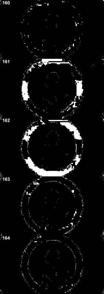

    Using frame 656 of transit_C1.mp4 to search for the hue of the yellowish band:
    function ShowHS(clip c, int hue)
        MaskHS(c, startHue=hue, endHue=hue+1)
        Subtitle(string(hue))
    v = LWLibavVideoSource("transit_C1.mp4", cache=false, prefer_hw=2)
    Trim(v, 656,-1) # frame 656 only
    Loop(360,0,0) # repeat for a total of 360 frames
    Animate(0,358, "ShowHS", last,0,  last,358)
    You can see that the yellow band has a hue around 161 to 163:
    [Attachment 60902 - Click to enlarge]
    Sep 2021
    Valencia
    Hello:
    I want to know how you can display the hue from frame 161 to 163, I will try to do the same.
    By the way, could you please explain what Animate() can do, and why you use this function here.
    Thanks,
  22. Originally Posted by zydjohn View Post

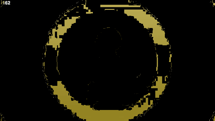

    If you want to see the actual colors corresponding to each hue (rather than the mask) you could use Overlay():
    v = v.ConvertToYV24() # necessary because of the non-mod4 frame size
    Trim(v, 656,-1)
    Loop(360,0,0)
    mask = Animate(0,358, "ShowHS", last,0,  last,358)
    Overlay(last, mask, mask=mask.Invert())
    All colors converted to black, except the current hue:
    [Attachment 60904 - Click to enlarge]
    Animate() allows you to vary a filtering parameter over a number of frames.
    http://avisynth.nl/index.php/Animate
    So Animate(0,358, "ShowHS", last,0, last,358) calls ShowHS() over frames 0 to 358 with the variable hue linearly interpolated from 0 to 358:
    frame 0: ShowHS(last, 0)
    frame 1: ShowHS(last, 1)
    frame 2: ShowHS(last, 2)
    frame 357: ShowHS(last, 357)
    frame 358: ShowHS(last, 358)

  26. Originally Posted by zydjohn View Post
    I can’t see anything useful, 99% of the time, I see only blank screen.
    The script is a tool to help you identify the hue of different picture elements. Parts of the picture that aren't the specified hue are shown as black. Only parts of the picture that match the hue value (printed in the top left corner) are shown. In the earlier version of the script they were shown in white. In the newer version they are shown in the native color. I used it here to find the hue of the yellowish circle of the transition effect in frame 656 of transit_C1.mp4 -- mostly 161 and 162. Original frame 656 and hue 162:
    [Attachment 60906 - Click to enlarge]

  27. Another way to get the hue and saturation values is to use the Histogram() filter:
    LWLibavVideoSource("transit_C1.mp4")
    Histogram(v,mode="color2")
    [Attachment 60907 - Click to enlarge]
    The angle around the circle in the UV plot is the hue (I added the angle labels in white) and the distance from the center is the saturation. When I do it this way I usually make a rough estimate for the hue first:
    MaskHS(startHue=150, endHue=180)
    Then examine the result:
    [Attachment 60908 - Click to enlarge]
    I then narrow or widen the range until just the area I want is covered:
    MaskHS(startHue=160, endHue=164)
    [Attachment 60909 - Click to enlarge]
    Then estimate the parameters for saturation and adjust its range similarly. This is where a program with an AVS editor comes in handy -- like VirtualDub2 or avspmod. You can change the script and press F5 to update the preview in the editor.

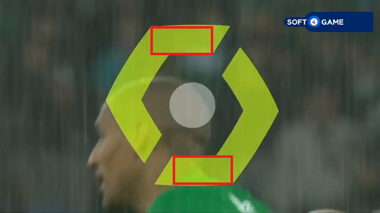

    I have yet one more difficult transit scene: transit_L1.mp4.
    There are a few factors make it more difficult: first, it was raining, so the video has extra disturbance, second, the transit scenes use the yellow sharps, which are not totally opaque, so I can still see some background images.
    Let me know how you can detect such transit scenes. Use the rectangles in red squares seem not very good, as the above reasons.
    [Attachment 60940 - Click to enlarge]
    Please advise!

  30. for transit_L1.mp4, that yellow transparent transition, you just go for the whole Hue range, yellow, range roughly 10 to 40, two rectangles selected for search (you can add if not enough), that will return always a short sequence of 6 frames, because that transition is not changing for that while. If you want to return only one frame then you'd need to compare found frames and ignore them if less then 6 difference
    crops = [
    [306,   #x1
    64,     #y1
    306+48, #x2
    64+40]  #y2
    [382,
    326,
    382+58,
    326+42]
        lower = np.array([10,125,0])
        upper = np.array([40,255,255])
        for c in crops:
            r = cv2.cvtColor(img_rgb[c[1]:c[3],c[0]:c[2]], cv2.COLOR_BGR2HSV)
            mask = cv2.inRange(r, lower, upper)
            if np.average(mask) > 140:
                continue
            else:
                return
        print(frame_number)
    1095
    1096
    1097
    1098
    1099
    1547
    1548
    1549
    1550
    1551
    1552
    1553
