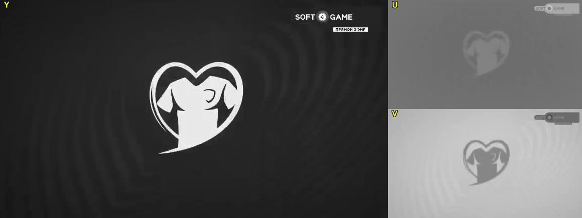

  1. With YV12 video each frame has a Y, U and V channel. The Y channel (greyscale) is at the full resolution of the frame. The U and V channels (colors components that are added or subtracted from the Y channel to produce the final color) are at 1/2 the resolution of the Y channel.
    StackHorizontal(GreyScale(v).Subtitle("Y"), StackVertical(UtoY(v).Subtitle("U"), VtoY(v).Subtitle("V")))

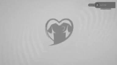

    VtoY() copies the V channel to the Y channel of a new video, creating a greyscale image of the V channel:
    [Attachment 60809 - Click to enlarge]

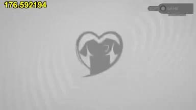

    The runtime function AverageLuma() calculates the average luma of the entire frame:
    VtoY(v)
    ScriptClip(last, "Subtitle(String(AverageLuma))")
    [Attachment 60812 - Click to enlarge]
    But since this is really the V channel from the original video it is the average V value of that frame of the original video.
    Highly saturated reds have very high V values. It's highly unlikely that other frames will have a high average V value over the entire frame (or large part thereof).

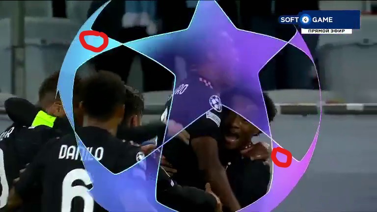

    Look at the transit_I1.mp4 file.
    And give me some idea on how to find the start/end of the replay scenes.
    Thanks,
    [Attachment 60849 - Click to enlarge]
    Last edited by zydjohn; 21st Sep 2021 at 17:15. Reason: Wrong post mp4 file with image
    Thanks,
  24. using vapoursynth previewer, manually navigated to frame 1085 where there I found two clearly blue rectangles, draw them and read x and y values. Then I ran script and printed those average values, read them, then added conditions and it found those frames:

  26. yes, it works too, but I lowered that blue threshold for first rectangle, from 180 value to 178:
    if U1>178 and U2>160:
    1232
    2511
    transitI1.mp4 got same results as posted above with that change
    you can literally lower those thresholds and come up with another small area, or even more,very small regions for example those bright outlines etc.
  27. This seams more accurate for that transparent transition.
    The least transparent areas were selected, blue and purple gradients , but U and V values are verified at the same time. So you can use very wide range -10 and +10 for thresholds and it still finds all off it and only those parts.
    More conditions the better (in this case 4) means higher tolerances for values is allowed.

  28. rectangles were selected roughly in those marked areas:
Name:	Inkedframe 1087 in transitI1.jpg
Name:	Inkedframe 1847 in transitI1.jpg
