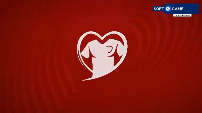

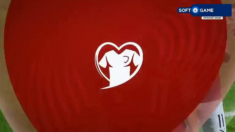

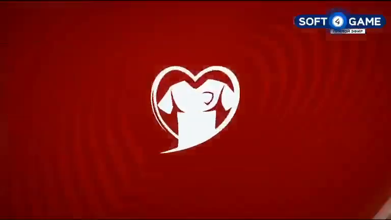

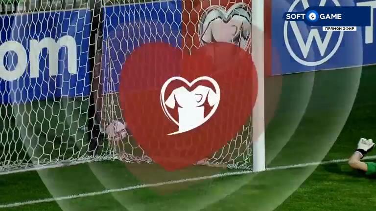

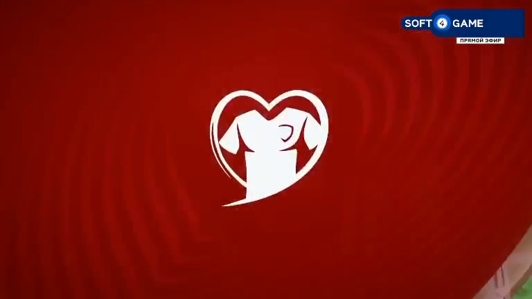

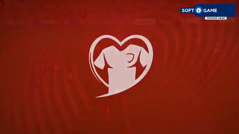

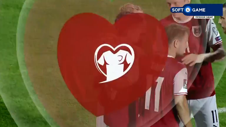

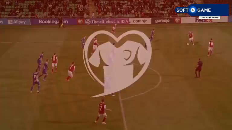

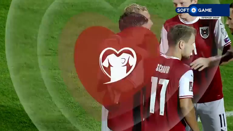

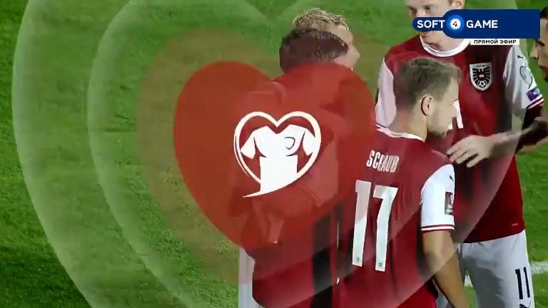

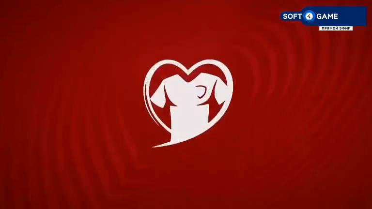

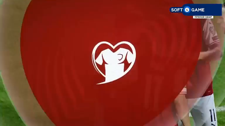

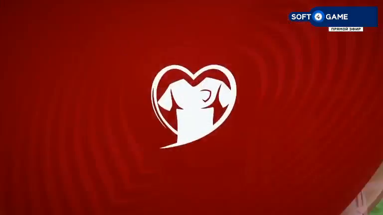

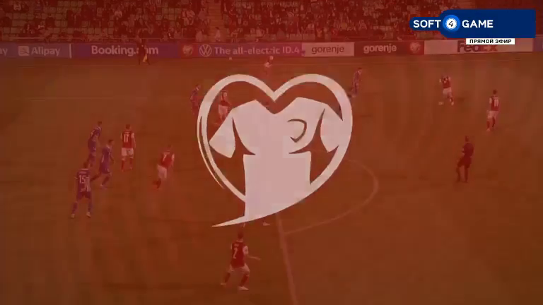

    I will try to upload the images for the long time (half a second) transition scene.
    [Attachment 60768 - Click to enlarge]
    [Attachment 60769 - Click to enlarge]
    [Attachment 60770 - Click to enlarge]
    [Attachment 60771 - Click to enlarge]
    [Attachment 60772 - Click to enlarge]
    [Attachment 60773 - Click to enlarge]
    [Attachment 60774 - Click to enlarge]
    [Attachment 60775 - Click to enlarge]
    [Attachment 60776 - Click to enlarge]
    [Attachment 60777 - Click to enlarge]
    I don't know how to upload one video from my PC yet, but I will try!
    If you can write some code to detect this transition scene, and show the time stamp for the first frame, then it is enough!
    Thanks,
  7. Here are some examples using your video:
    Using a selected frame (458) to match:
    function AbsDiff(clip v1, clip v2)
        Subtract(v1, v2)
        Overlay(last.ColorYUV(off_y=-126), last.Invert().ColorYUV(off_y=-130), mode="add")
    v = LSmashVideoSource("transit1.mp4")
    i = Trim(v, 458,458) # use frame 458 as the match frame
    diff = AbsDiff(v, i)
    WriteFileIf(diff, "match.txt", "AverageLuma<4.0", "current_frame", append = false)
    Using a PNG image as a reference (frame 458 was previously selected and saved as a PNG image):
        Subtract(v1, v2)
    i = ImageSource("image.png", fps=v.framerate).Trim(0,-1).ConvertToYV12()
    Using only a crop of frame 458 (for example, that "SOFT 4 GAME" logo may not appear on all the matching frames):
        Subtract(v1, v2)
    diff  = AbsDiff(v.Crop(270,100,232,232), i.Crop(270,100,232,232)) # crop to the central portion of the frames
    In all cases I loaded the script into VirtualDub then ran File -> Run Video Analysis Pass to scan through the video. Once that completes match.txt contains the frame numbers of all the matches, 458 and 974 in this case. Note that the transition starts about 12 frames before the matching frame, and ends about 6 frames after. In practice you may have to raise the AverageLuma threshold a bit because of compression/capture artifacts. Or lower it a bit to reduce the number of false positives.
    It might even be possible to automate the removal (if all false detections can be avoided) but I'd have to think about that...

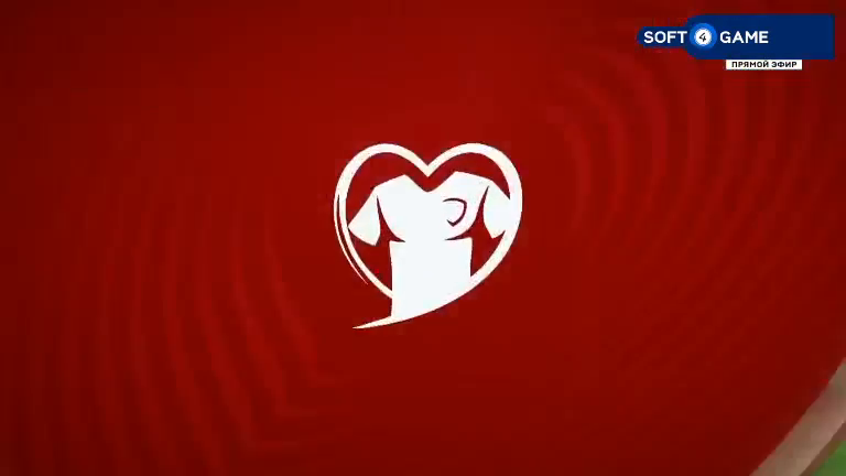

    If I understand you correctly. I can pick up frame #458 and #974 as a base frame, to compare its central area with other videos, and find the match frames, right?
    The both frames are quite similar (I extract all the frames with total number of exactly 1000, and I pick up frame #458 and #974
    [Attachment 60790 - Click to enlarge]
    [Attachment 60791 - Click to enlarge]
    If there are exactly 2 matches found, then the first one is the start of the replay and second one is the end of the replay, right? Like the matches in the text file:

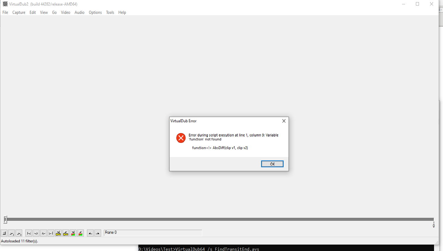

    By the way, it is not very easy to always drag and place script into VirtualDub64.exe, I added it to PATH, and run it with /s parameter, like this:
    but I got error: D:\Videos\Test>VirtualDub64 /s FindTransitEnd.avs
    See the picture.
    [Attachment 60792 - Click to enlarge]
    Can I run script from DOS command? it will be much easier, as I can launch it from C# program, but drag and place script into VirtualDub64.exe is difficult.
    Thanks again for your kind help!
  14. Originally Posted by zydjohn View Post
    Hello:
    No. You need to find one frame of the transition effect that is the same every time the transition appears (and doesn't appear anywhere else). You then use that frame to find all occurrences of the transition. Frame 453 is not suitable for this because it contains a lot of the background video:
    [Attachment 60794 - Click to enlarge]
    The next time that frame of the transition appears is at frame 969:
    [Attachment 60795 - Click to enlarge]
    The transition effect is the same but the background is different. So a simple frame match would not see the two frames as identical.
    If a different transition effect is used at the end of the replay you would need to add a second WriteFileIf() using a frame from the end effect for comparison.
    D:\Videos\Test>type match.txt
    458
    974
    Yes (assuming the video didn't start in the middle of a replay). Then next next pair is the start/end of the next replay. Etc.
    See the picture.
    Leave out the /s. /s is for VirtualDub's own scripting language, not AVS scripts. AVS scripts are A/V files as far as VirtualDub is concerned.

    Let me know how I can save the central part of frame#458 as an image, and use it to compare with other mp4 videos, like transit2.mp4 to find a match.
    By the way, I still can’t figure out how to run dos command for VirtualDub64.exe to run my script. If not using /s option, then which option I can use?
    Thanks,
  16. Originally Posted by zydjohn View Post
    Just the name of the avisynth script.
    Virtualdub64 filename.avs
    I want to do some tests to see if I can use only part of the frame#458, or #974 as base image to find match with other mp4 videos.
    The third script in post #7 shows how to use a portion of one frame within the video as a reference.
    To use an image I would open the video in VirtualDub and navigate to a suitable frame. Add the crop filter (Video -> Filters... -> Add -> Crop... Use the crop dialog to mark the part of the frame you want to keep, note the X and Y coordinates of the crop for later use (keep all cropping coordinates values numbers with YV12 video). At the main VirtualDub windows select Video -> Copy Output Frame To Clipboard. Then paste from the clipboard as a new image in an image editor. Save the image. The AVS script will look like:
        Subtract(v1, v2)
    diff  = AbsDiff(v.Crop(XPOS, YPOS, i.width, i.height), i) # crop to video frame to match the reference image
    Overlay(v, last, x=XPOS, y=YPOS)
    Replace XPOS and YPOS with the coordinates you recorded earlier. The last line isn't necessary but it lets you see the whole source frame with diff overlaid.
    Note that different videos using the same transition may have different colors, brightness, position, frame size, etc. So it may not be so easy.

  18. Member
    Sep 2021
    Valencia
    Hello:
    I want to do more tests, so I have done the following:
    1) D:\Videos\Test>ffmpeg -i 458.png -vf "crop=232:232:270:100" 458_Center.png
    I crop the Frame #458 from its center part, with width=232px, height=232px, starting point X1=270, and Y1=100. And save it as “458_Centere.png”, I can use 458_Center.png as the base image, and trying to find a match in video transit1.mp4
    2) I created a new AVS script:
    D:\Videos\Test>type FindEnd2.avs
    Subtract(v1, v2)
    i = ImageSource("458_Center.png", fps=v.framerate).Trim(0,-1).ConvertToYV12()
    diff = AbsDiff(v.Crop(270, 100, i.width, i.height), i)
    Overlay(v, last, x=270, y=100)
    3) When I run my script:
    D:\Videos\Test>VirtualDub64 FindEnd2.avs
    I saw the difference: my script run with normal transit1.mp4, the 458_Center.png is in inverse mode; but your code run with inverse mode of transit1.mp4.
    However, after run my code, I can’t see any match:
    D:\Videos\Test>dir match.txt
    Volume in drive D is SATABackup
    Volume Serial Number is 4425-E62C
    Directory of D:\Videos\Test
    18/09/2021 21:55 0 match.txt
    1 File(s) 0 bytes
    0 Dir(s) 717,527,707,648 bytes free
    D:\Videos\Test>
    If there anything wrong with my code?
    By the way, I want to know if I can either print the discovered frame’s time position, for example: Frame #458 is at about: 18.32 seconds from the start of the video, or print both the frame number and the time position, since I need the time position for further operation using FFMPEG.
    Finally, I can’t figure out how to run the script using command line, like: vdub64.exe.
    I used vdub64.exe to run your code, but I found the match.txt is empty, like my code runs.
    Because, using VirtualDub64 to run script, I have to watch the video again, but after I finish the script, I would like to run the script a lot of times, I don’t bother to watch them at all, as long as they give me the correct time positions, it is enough.
    Please advise!
    Thanks,
  19. I duplicated your procedure (1) for creating 458_center.png and ran your script (2) with transit1.mp4. It worked as expected with transit1.mp4.
    [Attachment 60796 - Click to enlarge]
        Subtract(v1, v2)
    If a different video is slightly lighter or darker, shifted left or right, etc. you will need to raise the AverageLuma threshold. For example:
    WriteFileIf(diff, "match.txt", "AverageLuma<8.0", "current_frame", append = false)
    Eight might not be the right value. Too high and you'll get false positives. Too low and you will miss some of the transitions. If you still can't get good output upload a clip from the other video(s).
    You can "run" a script with ffmpeg:
    ffmpeg -i FindEnd2.avs -c copy -f null -

  22. To use an image I would open the video in VirtualDub and navigate to a suitable frame. Add the crop filter (Video -> Filters... -> Add -> Crop... Use the crop dialog to mark the part of the frame you want to keep, note the X and Y coordinates of the crop for later use (keep all cropping coordinates values numbers with YV12 video). At the main VirtualDub windows select Video -> Copy Output Frame To Clipboard. Then paste from the clipboard as a new image in an image editor. Save the image.
    Or use AVSPMod and do a PNG screenshot directly. (Why can't VirtualDub2 do screenshots itself ? Unless I'm missing sumpting ?)
    @zydjohn
    For clarity's sake, you could put everything that is "code" or program output between those tags : [ CODE ] [ /CODE ] (remove the spaces before / after the square brackets). (A specific "code" button is available but only in "advanced" mode.)

    Sep 2021
    Valencia
    Hello:
    Thanks for your code and advice.
    Now, I make yet another mp4 video: transit2.mp2, and I tried your code, it is not working. So I extract all frames from the video, and pickup one frame#979, which shows the biggest shirt in the image. Then I crop frame #979:
    D:\Videos\Test>ffmpeg -i B0979.png -vf "crop=232:232:270:100" B0979_Center.png
    I can’t see any difference between B0979_Center.png and 458_Center.png.
    You can take a look.
    Then I run the following code, now it is working:
    D:\Videos\Test>type FindEnd3.avs
    Subtract(v1, v2)
    v = LSmashVideoSource("transit2.mp4")
    i = ImageSource("B0979_Center.png", fps=v.framerate).Trim(0,-1).ConvertToYV12()
    WriteFileIf(diff, "match.txt", "AverageLuma<10.0", "current_frame", append = false)
    D:\Videos\Test>ffmpeg -i FindEnd3.avs -c copy -f null -
    978
    1758
    D:\Videos\Test>
    I think maybe one general solution is: try both B0979_Center.png and 458_Center.png, give a large value of threshold "AverageLuma", like 20 or 30; then pick up the frames whose "AverageLuma” is the lowest, and pick up the first two. What do you think?
    If you think it is OK, then how to find out the lowest value of "AverageLuma", and pick up the top two of them?
    By the way, if I set up the first frame as starting time 0 second, then how to show the current frame’s time position in second in the "match.txt" file?
    [Attachment 60798 - Click to enlarge]
  24. Originally Posted by zydjohn View Post
    You don't see the difference in brightness and location of the two logos? Like I said before, you need to have nearly exact matches for this technique to work.
    You can get time in seconds by dividing the frame number by the frame rate:
    WriteFileIf(diff, "match.txt", "AverageLuma<4.0", "current_frame/framerate", append = false)

    WriteFileIf(testclip, "match.txt", "(AverageLuma()>176.5) && (AverageLuma()<176.9)", "current_frame", append = false)
    Output:
    458
    974
    1978
    2758
    This script detects frames that are nearly all red. The four detected frames had average V values from 176.58 to 176.87. You may need to loosen the range for other clips. Enable the commented out line to see the average V values. Limiting the test to the left ~1/3 of the frame may make it work even better (you'll have to adjust the range).
  29. Member
    Sep 2021
    Valencia
    Hello:
    It is interesting to know what you mean: The four detected frames had average V values from 176.58 to 176.87
    For the both images for comparation:
    [Attachment 60803 - Click to enlarge]
    [Attachment 60804 - Click to enlarge]
    Can you use the images and provide detailed explanation?
    I think your solution seems to be better, or a more general solution for my question!
    Thanks,
