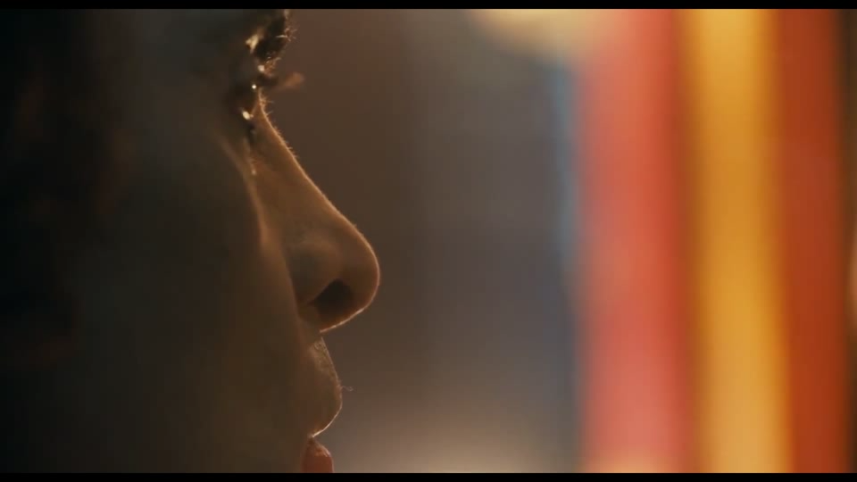

    Works perfectly with mpeg4 codec as well.
    -c:v mpeg4 -b:v 5000k  -vf  "pad=1920:1080:0:20, scale=960:540" -c:a copy
    Must be your TV which hides the small top and bottom bars.
    [Attachment 60749 - Click to enlarge]

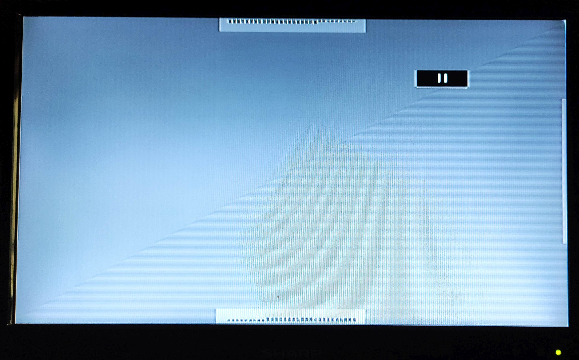

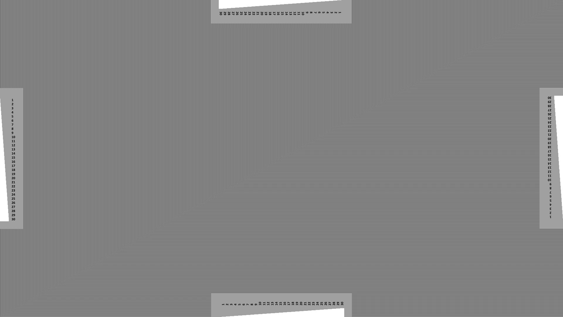

  19. In case you don't know what overscan is:
    https://www.howtogeek.com/252193/hdtv-overscan-what-it-is-and-why-you-should-probably-turn-it-off/
    Most TVs do it by default and have a way of disabling it. Turning it off will give you a sharper picture and let you see the entire picture. Attached is a sample video that lets you check for overscan. With overscan disabled you should see a picture like:
    [Attachment 60753 - Click to enlarge]
    On a 1080p monitor you should see all the way to edges of picture and there shouldn't be any distortion in the middle of the picture.
    With no overscan you should be able to see all of the gauges at the edges of the frame:
    [Attachment 60754 - Click to enlarge]
    With overscan part of the edges will be cut off:
    [Attachment 60758 - Click to enlarge]
    The center of the image should have clear alternating dark/bright lines:
    [Attachment 60756 - Click to enlarge]
    Not distortions like:
    [Attachment 60757 - Click to enlarge]
    On a 720p monitor you will see distortions in the middle but you should still be able to see all of all four gauges.

    - the third is 1280x720 = standard, play
    Can you play jagabo's test clip?
  28. yes, not play.
    start and re-start continuously...
  29. Ugghh! How about this one? Does it play?
  30. yes, your version work for me.
    [Attachment 60793 - Click to enlarge]
    and then?
