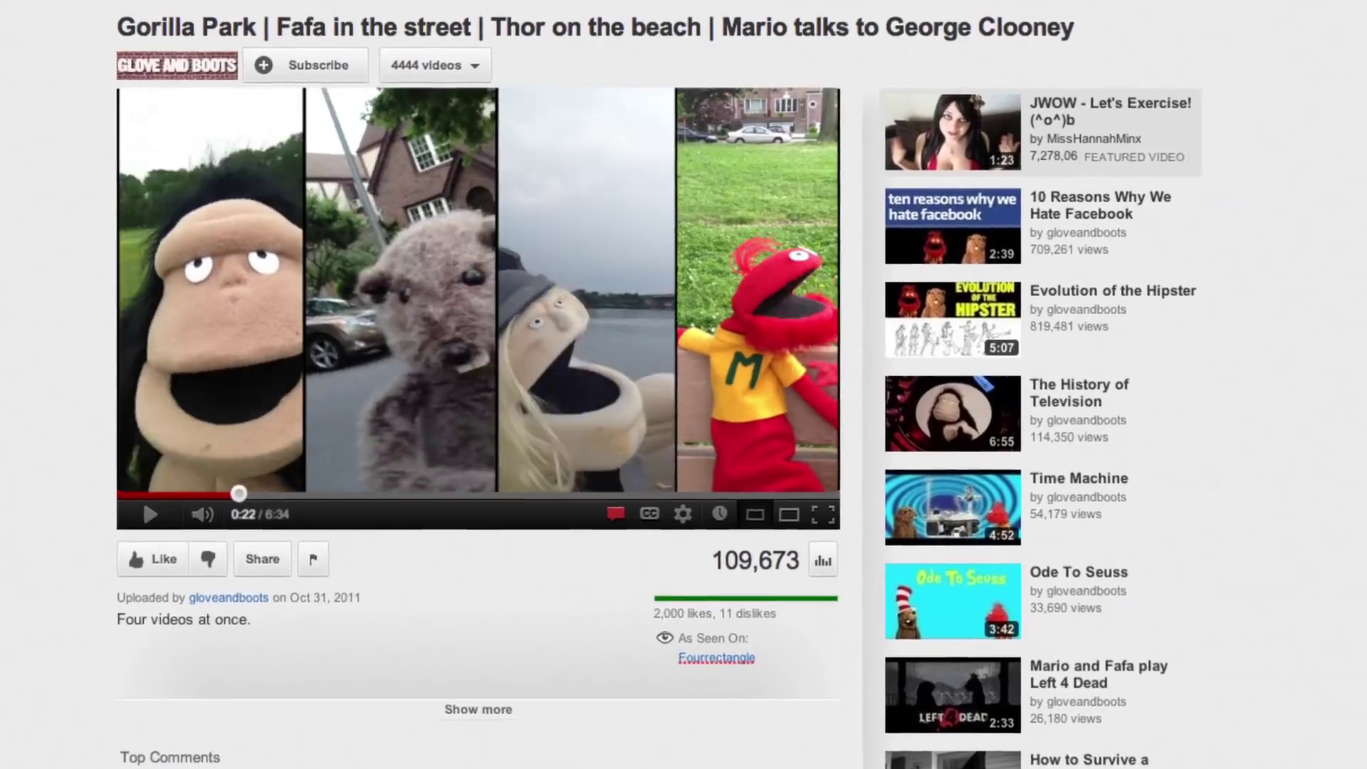

    Well you can always do what's demonstrated at 01:18 of the educational video I uploaded there...
    [Attachment 60785 - Click to enlarge]
    Otherwise, consider vertical video as a pandemic for which there is no vaccine and no treatment, so all ya can do is stay away from it.
