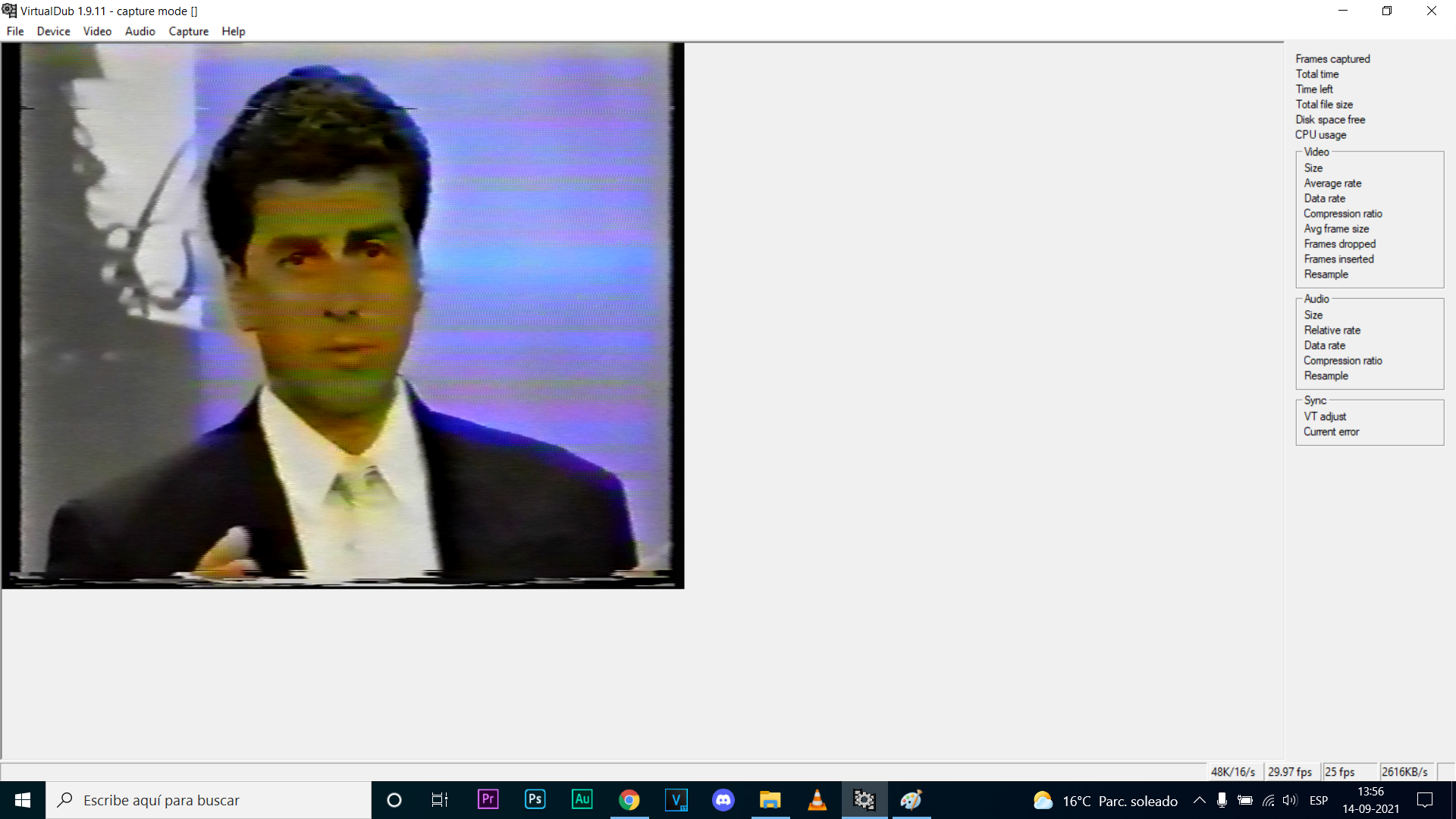

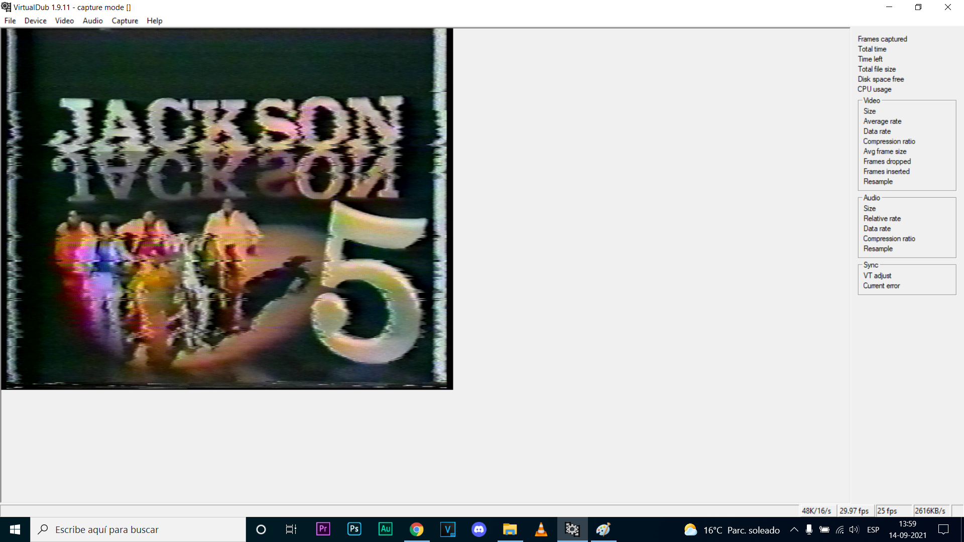

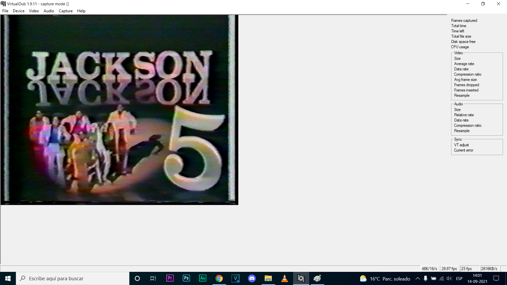

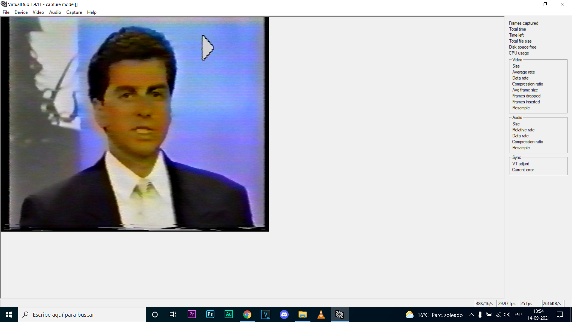

Hello, I hope someone could helpn me, I m using a HR 8700 EU and I pass the signal with the DMR ES 10 into Intensity Shuttle to My Computer, the problem is that everytime I turn on the TBC/DNR in the VCR, in the not good quality tapes, appers horizontal lines like not using a TBC, when I turn on, the DMR 10 ES works amazing, but again I try and appers the horizontal lines, like the VCR TBC is making Even worst the video, I tested without the DMR 10 ES, and it Also doesnt work, someone know? Maybe the TBC is not good condition in the VCR? Thanks!
WITHOUT VCR TBC/NR
[Attachment 60731 - Click to enlarge]
[Attachment 60727 - Click to enlarge]
WITH VCR TBC NR
[Attachment 60730 - Click to enlarge]
[Attachment 60728 - Click to enlarge]
Use only DMR ES-10 TBC then, disabling VCR's TBC (if I understand correctly your pictures, not sure)
The tape in the screenshots is clearly multi-gen (copy of a copy). It's normal for VCR line TBCs to perform worse than DMR-ES10 for such tapes. This doesn't indicate a problem with the VCR.
As lollo says, just disable the VCR TBC for these bad tapes. And be glad that the ES10 handles them so well.
