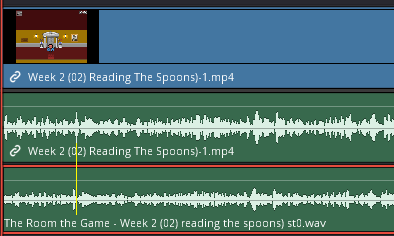

    This is where my lack of experience is getting the better of me. When I run the video through Handbrake, no matter the audio format I chose, it always re-encodes it with a bit of "extra" blank space at the beginning of the audio stream. I have attached a picture for what I mean. The video is the converted video, the top audio track is the converted audio track that is ahead, and the bottom audio track that was extracted from the original non-converted video, and is the one that is "correct".
    I have drawn a line in yellow to illustrate that they do not match up.

  2. Check the headers of the output of handbrake, I assume that it has a/v delay info which compensated the delay you showed.

    The small "delay" also happens when I change my OBS audio codec to AAC or AC3. I think this might be a quirk of the codecs.
    I put the files in audacity and you can see the delay more easily explained. Its more like an added silent wave form at the beginning. I have attached a picture of what I mean.
    Top is AAC, the middle is AC3, and bottom is PCM. All were recorded using their respective codecs in OBS and stripped from the video file. Sound was playing constantly for each separate recording, and before the recording started.

  8. Question is:
    a. do you see/here the delay during playback when muxed (note that depending on the container and format there might be an additional delay, no clue whether handbrake compensates these, on muxing)
    b. assuming you want to compensate the delay adding the delay info to the muxed container should help. (or alternativelay adjusting the audio stream) Since I don't use Handbrake at all I have no clue whether it allows to add a/v delay infos to the container. You could always use ffmpeg to remux and change the audio delay.
    There's probably a handbrake user somewhere here in the forum that might be able to help with whether there is an option in handbrake to delay an audio/video stream.
    Cu Selur

    To answer question a.
    When I edit the file in Davinci Resolve, and I do an a/b test for the different audio streams, it is noticeable that the original PCM stream lines up better.
    When you play them together, you get a strange echo(?) effect, due to the delay. The problem with this is that Davinci Resolve does not allow for small enough increments to edit and fix the audio.
