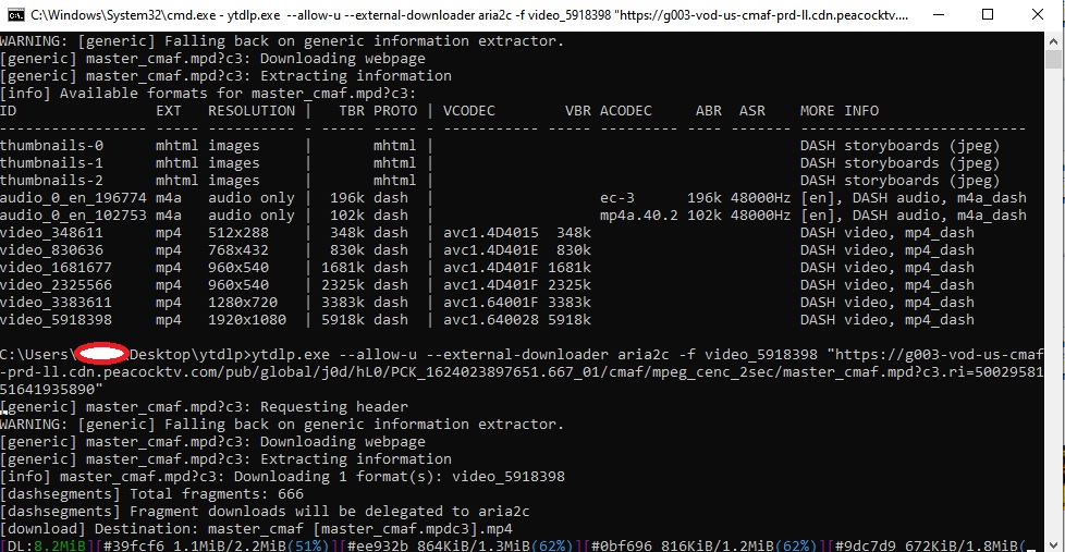

  9. @notaghost - you have DL the Spanish audio version, actually could it be that the best quality (highest version number) version on this audio stream is actually Spanish rather than English?
    [info] Available formats for master_cmaf.mpd?c3:
    ID EXT RESOLUTION | TBR PROTO | VCODEC VBR ACODEC ABR ASR MORE INFO
    thumbnails-0 mhtml images | mhtml | DASH storyboards (jpeg)
    thumbnails-1 mhtml images | mhtml | DASH storyboards (jpeg)
    thumbnails-2 mhtml images | mhtml | DASH storyboards (jpeg)
    audio_0_en_196787 m4a audio only | 196k dash | ec-3 196k 48000Hz [en], DASH audio, m4a_dash
    audio_0_es_196787 m4a audio only | 196k dash | ec-3 196k 48000Hz [es], DASH audio, m4a_dash
    audio_0_en_102830 m4a audio only | 102k dash | mp4a.40.2 102k 48000Hz [en], DASH audio, m4a_dash
    audio_0_es_102837 m4a audio only | 102k dash | mp4a.40.2 102k 48000Hz [es], DASH audio, m4a_dash
    video_350968 mp4 512x288 | 350k dash | avc1.4D4015 350k DASH video, mp4_dash
    video_845938 mp4 768x432 | 845k dash | avc1.4D401E 845k DASH video, mp4_dash
    video_1797601 mp4 960x540 | 1797k dash | avc1.4D401F 1797k DASH video, mp4_dash
    video_2715260 mp4 960x540 | 2715k dash | avc1.4D401F 2715k DASH video, mp4_dash
    video_3976793 mp4 1280x720 | 3976k dash | avc1.64001F 3976k DASH video, mp4_dash
    video_7182894 mp4 1920x1080 | 7182k dash | avc1.640028 7182k DASH video, mp4_dash
    So far I have been able to implement aria2c to speed up download of English audio.
    I have been able to verify the keys provided by notaghost and decrypt both the audio and video.
    Last step is for me to merge audio and video via Mkvmerge.
    In summary Have I got the process correct?
    1. Identify URL of stream 'The Stream Detector' has helped. (I am still not 100% on where to locate the g00... url via inspect/developer tools in Firefox.
    https://www.peacocktv.com/watch/playback/vod/GMO_00000000144086_02/4d17e9fc-8cd6-32bc-...0-435eb0ca187e
    becomes
    https://g003-vod-us-cmaf-prd-cl.cdn.peacocktv.com/pub/global/cAZ/CtQ/PCK_1615750257854...49495906012671
    2. Identify keys via browser inspect/developer console using guesser extension
    3. Export browser cookies for websites that need a login to PATH cookies.txt
    4. yt-dlp with -F to ensure best audio is English version.
    5. select preferred video and audio in command
    example cmd ---> yt-dlp --allow-un -f video_7182894+audio_0_en_102830 --external-downloader aria2c.exe "https://g003-vod-us-cmaf-prd-cl.cdn.peacocktv.com/pub/global/cAZ/CtQ/PCK_1615750257854.9292_01/cmaf/mpeg_cenc_2sec/master_cmaf.mpd?c3.ri=3779949495906012671"
    6. Decrypt with key via mp4decrypt
    7. Merge audio and video with Mkvmerge
    Please correct / optimize the above summary if you have the time.
    Kindest Regards
