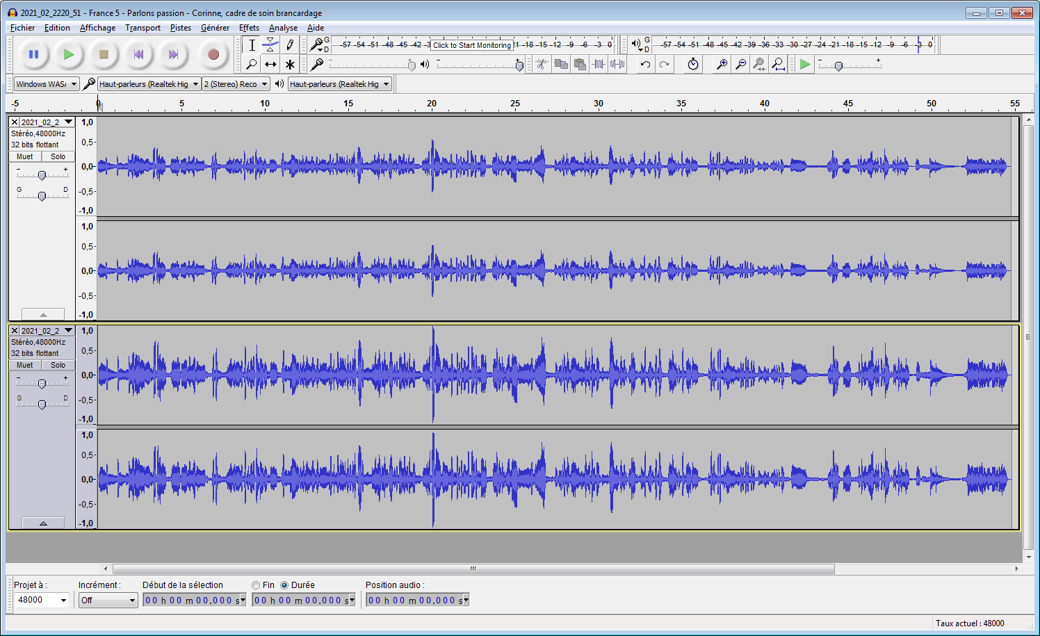

The result :
[Attachment 60826 - Click to enlarge]
You could add quality settings, but the default settings with qaac produce high quality files, i.e. an average bitrate in the ballpark of 200kb/s (even though every re-compression involves some quality loss, it shouldn't be noticeable).
