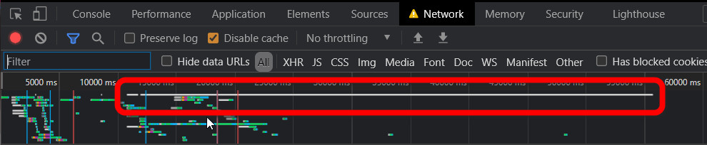

Play the video for a while, on the devtools 'Network' tab you'll see a long bar and it's getting longer and longer:
[Attachment 58931 - Click to enlarge]

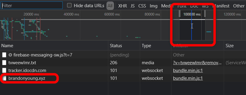

Click on it and use mouse scroll to adjust the size of interval:
[Attachment 58932 - Click to enlarge]
(Usually this method does not work on m3u8 and mpd but it works in this case.)
Only couple items left on the left panel, and I finally found brandonyoung.xyz is the one we want.

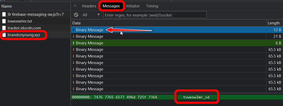

Click on it and on the right side, check 'Headers' and 'Messages' to see:
On 'Headers', we need to copy down some info:
Request URL: wss://brandonyoung.xyz/ (this is websocket server)
Request Headers -> Origin: https://geoip.redirect-ads.com (without this, the server will not respond)
On 'Messages', you'll see a lot Binary Message receiving from the server:
[Attachment 58933 - Click to enlarge]
Scroll up to the top and find the very first Binary Message that we sent to the server.
Click it and on the bottom you can copy down the message:
First message sent to the server: "tvweewImr_sd"
The message is basically the vid "tvweewImr" plus the video quality "sd".
If you check the second message which is the response from the server: "sd_254620732_65536_sd"
Here "254620732" is the total bytes of the video, and "65536" is the size of one segment.

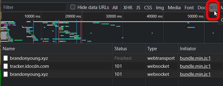

Btw, since we know it's websocket transfer, we can click on 'WS' (WebSockets) right to the filter box to quickly locate it next time:
[Attachment 58934 - Click to enlarge]
