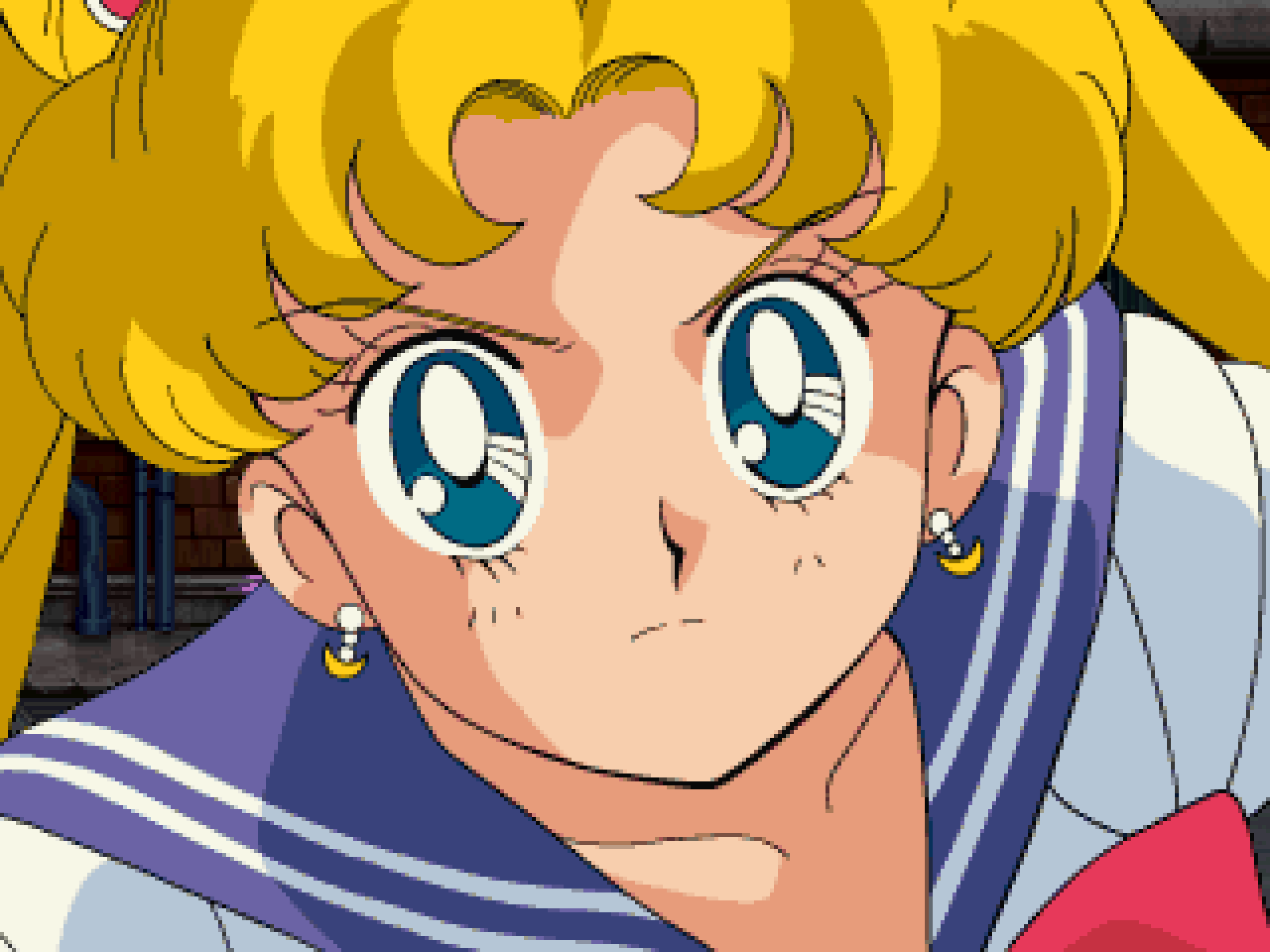

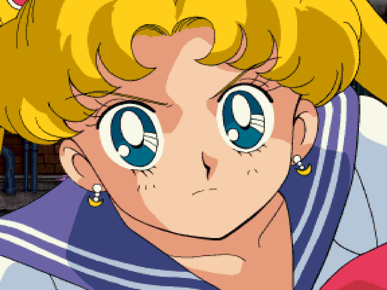

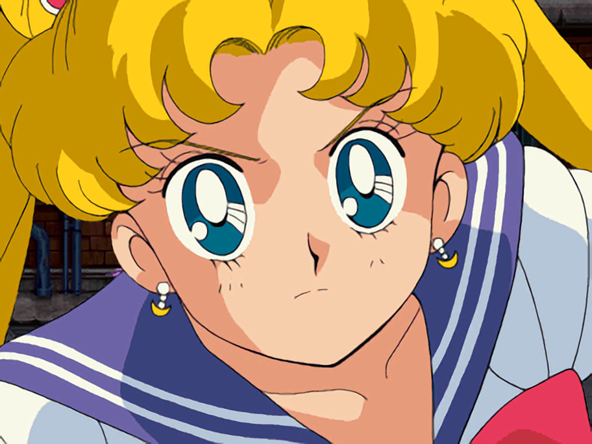

  12. examples:
    scale low res image to 4:3 first, then upscale to 4:3:
    [Attachment 60668 - Click to enlarge]
    upscale low res image directly to 4:3:
    [Attachment 60669 - Click to enlarge]
    Smooth upscale with nnedi3:
    [Attachment 60670 - Click to enlarge]
  13. Originally Posted by jagabo View Post
    examples:
    Amazing!!!
    Please, show me how.
  14. You can do the smooth upscale like this:
    LWLibavVideoSource("00vnHM2.png")
    ConvertToYV12()
    nnedi3_rpow2(8, cshift="spline36Resize", fwidth=1920, fheight=1440) # upscale 8x, 320x240 to 2560x1920, then downscale to 1920x1440
    aWarpSharp2(depth=20)
    Sharpen(0.3)
  15. Originally Posted by jagabo View Post
    ConvertToYV12()
    Sharpen(0.3)
    Thank you jagabo!
  16. It looks amazing, here a few samples.
    Thank you jagabo.
